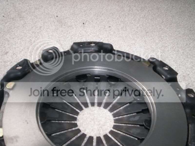

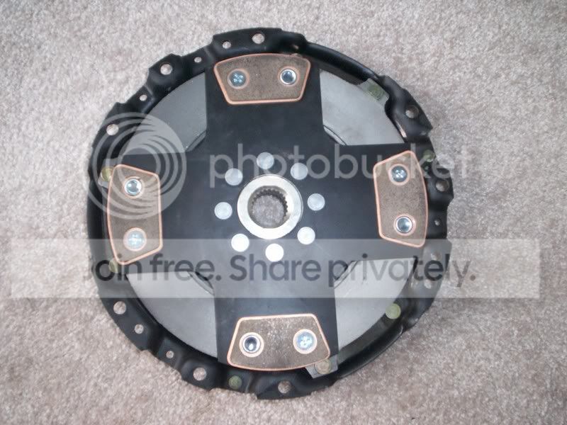

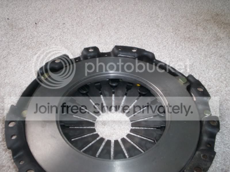

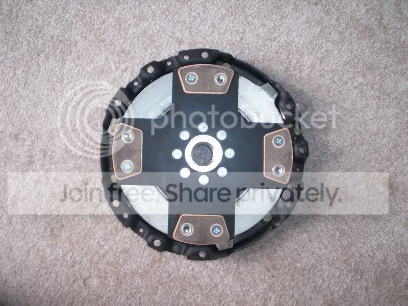

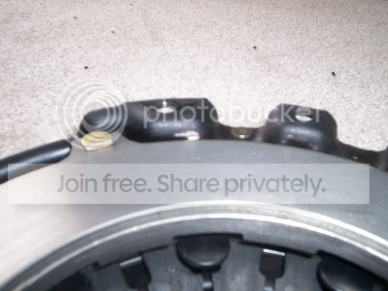

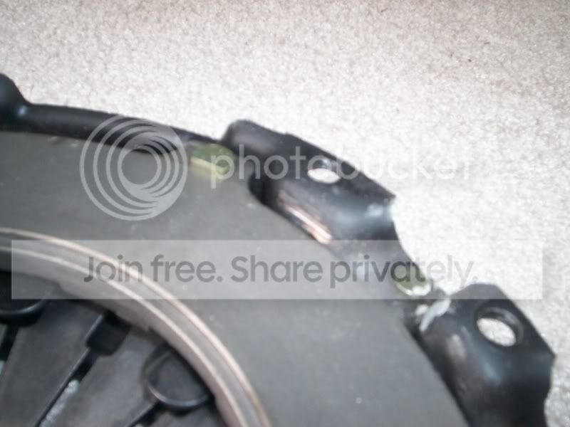

Old Jun 10, 2007 | 11:13 AM
  #100
Topdawgg's Avatar
Posts: 2,776
From: Halifax, NS Canada
Default Re: (Topdawgg)
in the pics you can clearly see around the outer edge of the PP where the disk was hitting it when it tried to spin
