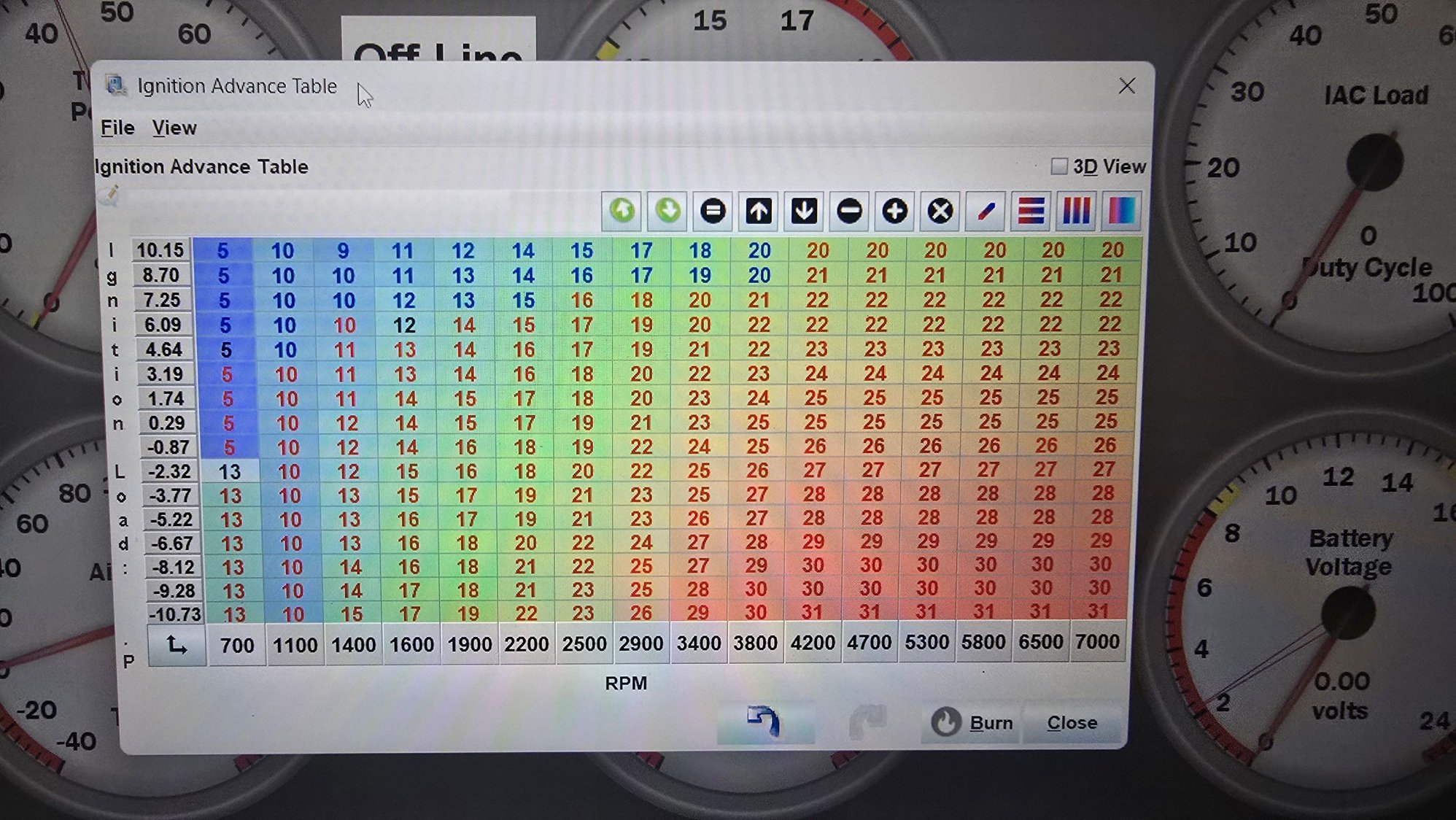

Just wanting some opinions on this map and if it'll be safe to drive on until I get to the tuner.
d16y7 z6 crank stock head
Pm6 pistons/eagle rods
bad guys oil pump
arp studs
0.57 ar ebay t04e turbo 7psi spring
Compression calculator showed 10.6:1 will be on pump gas

Looks light on timing around idle. Ramp timing up faster too. Its conservative everywhere imo.
Just street tune it yourself some. If it doesn't feel happy, its not happy. You're so close.

Are you running it on tuner studios?

I'm gonna make a dice roll and say it's one of those RusEFI "BoostedNW" brand ECUs. Maybe an MS3Pro Mini

This is a "Pnpduino", A speeduino based ecu and yes I am on tunerstudio
