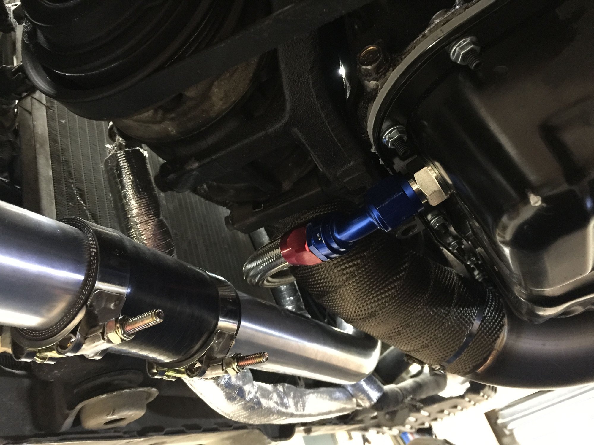

Progress is still being made everyday. Starting to bolt things In for keeps now. Yesterday got the turbo coolant line hooked up. Also clamped down all the intercooler pipes and started mock-up of a intake pipe. Will be building a sheetmetal air box for it
Today hooked up the turbo oil feed line. Also installed the drain fitting into the oil pan, as well as the My Honda Habit stud and gasket kit too. That allowed me to complete the downpipe install for keeps
Still gotta cut the turbo oil drain line to size and hook it up. Once that's done I can instal the last intercooler pipe off the turbo and be done with turbo-kit install under the car. Just exhuast left underneath then done!
After that it's just fuel pump, Injectors then add fluids. Were getting close to a 1st start 👍🏼

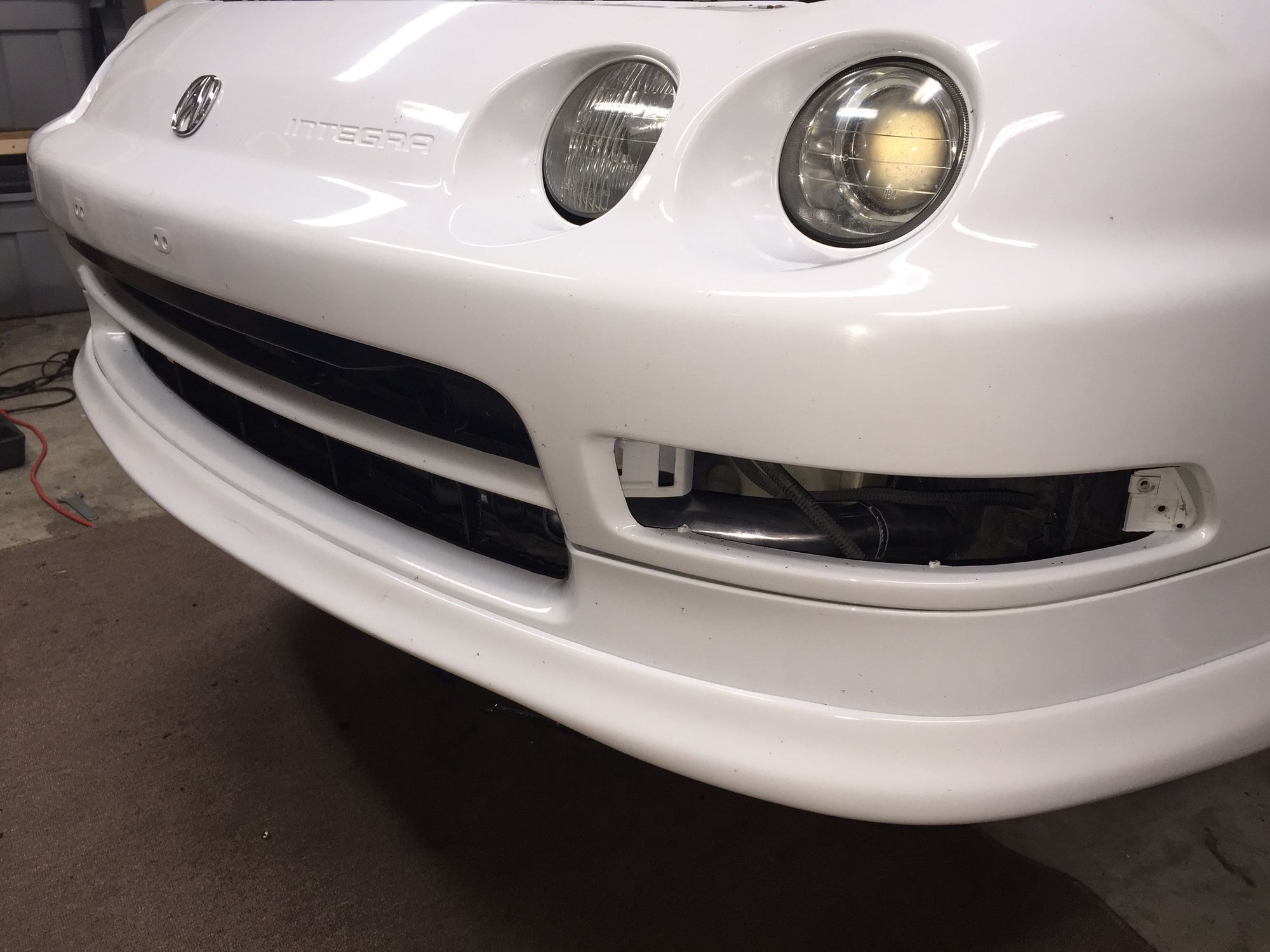

Again want to give a big thanks to AutoWorks! Fitment is excellent. Its hard to tell in the pictures, but none of the components are touching. I can get atleast 1 finger in between anything and that's as close as it gets.
