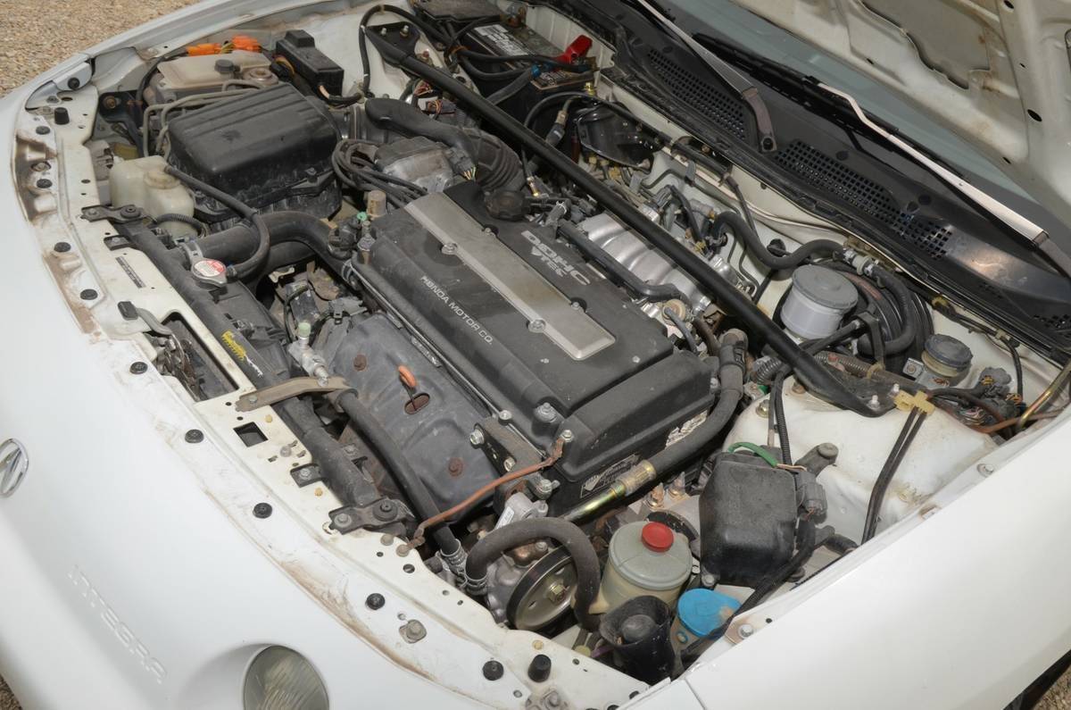

This is how she was the day I brought her home.
For the first 5 months I did nothing but maintainence and restoration.
Mechanically the car was very well maintained but I still swapped out everything i didn't have a record of. All head seals, crank seals, all belts, and water pump are now new. Plus all shift bushings, and lower linkage new to get that super crist feel. Some suspension bushings new. I'm doing it the exact opposite way that most newbs would do it... The least fun (and most responsible) stuff 1st lol. I have a slight leaking oil pan gasket but I'm going with the myhondahabit stud and gasket kit.
This year I've been starting to mod some. Keeping it real classy with original Parts. Mugen header and Twin Loop exhuast. Mugen front and rear tower braces.
But today I ordered a whole list of parts. Basics being.... Go-Autoworks turbo kit with GTX2867R, Grams 750cc Inj, Walbro in-tank 190 (quieter than the 255), Hondata, Comp Stg4 Clutch. And every other little supporting mod needed. I spent more today on turbo kit and supporting mods than I did on the whole car lol... but all in all for the total price of everything it's gonna be a fun little street car for the price.

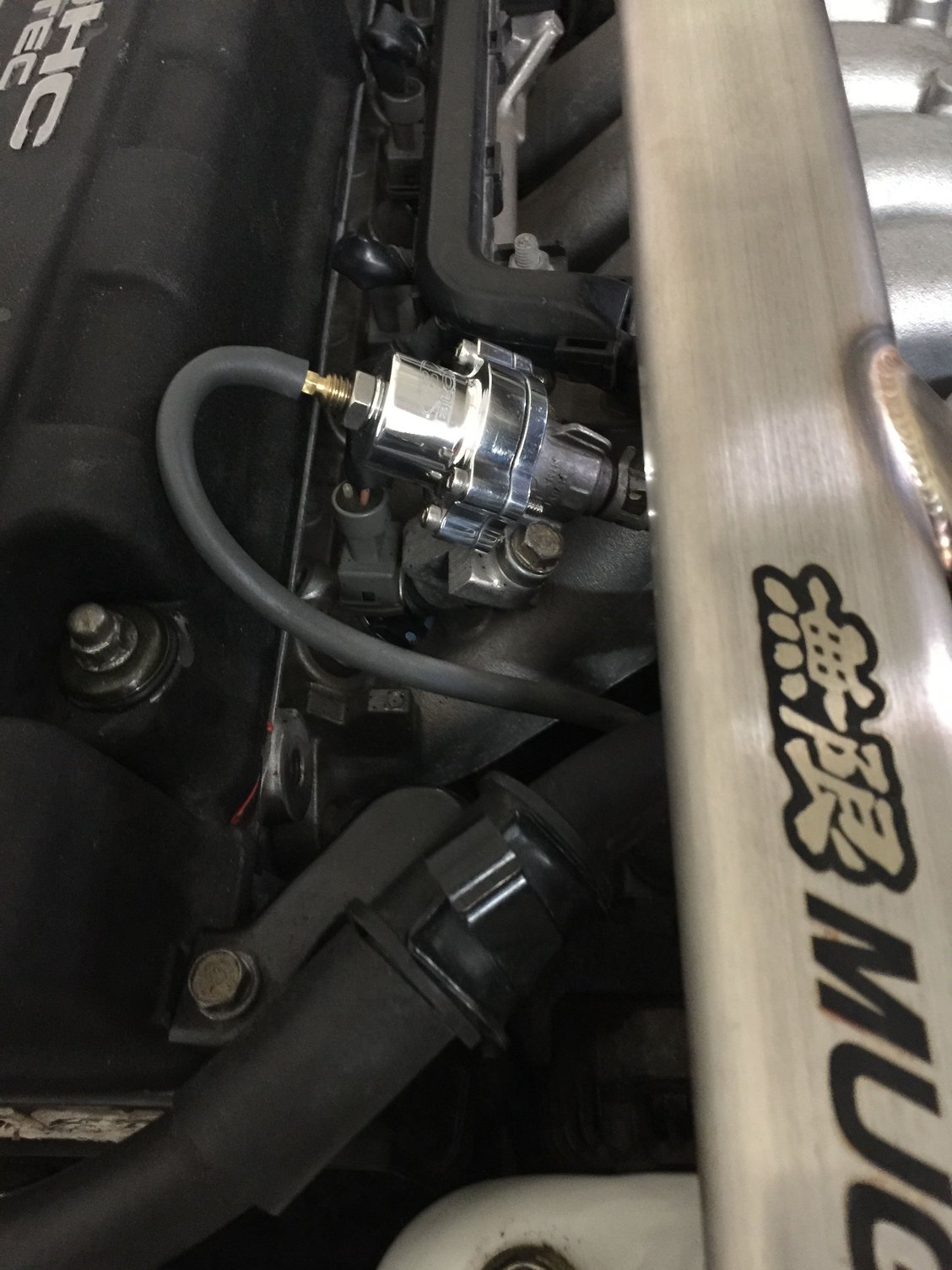

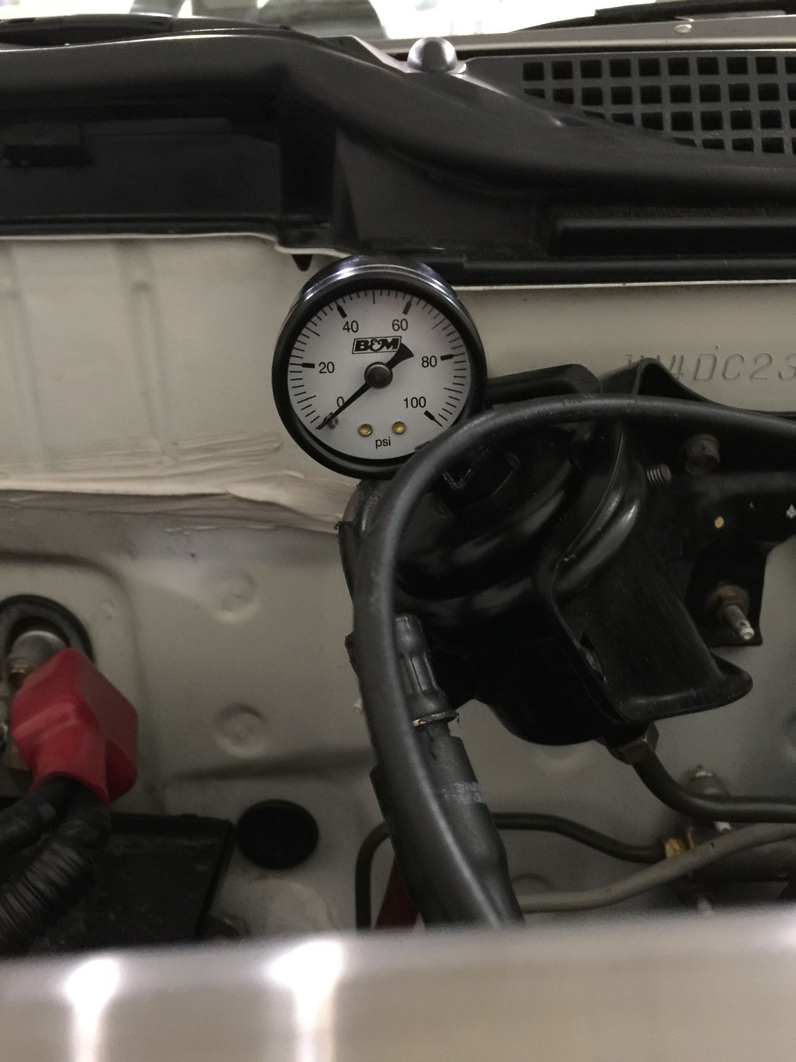

I'll be sure to fab a compressor heat sheild then. I'm also going to have Hondata turn off the AC before RPMs get too high (say above 5k). Even though I live in the South Ill rarely use the AC in it. I just want the full-street-car option. I use AC in my daily all the time, but in my FunCar I like to roll with the windows down.
Good to know about the pump retire. One less thing to do.
i plan to resurface the stock flywheel if needed. As good as everything else is on this car I'd be surprised if it hasn't been babied like the rest of the car. Maybe I'll get lucky and not have to touch that too. From what I research (pre parts-order research) the Competition Clutches were a good choice. So I've got a Comp Stage4 Clutch and Pressure plate that's probably gonna be here tomorrow. Hope that will serve me well.
did my 1st couple of turbo build mods today lol
Small mods but important none the less 👍🏼

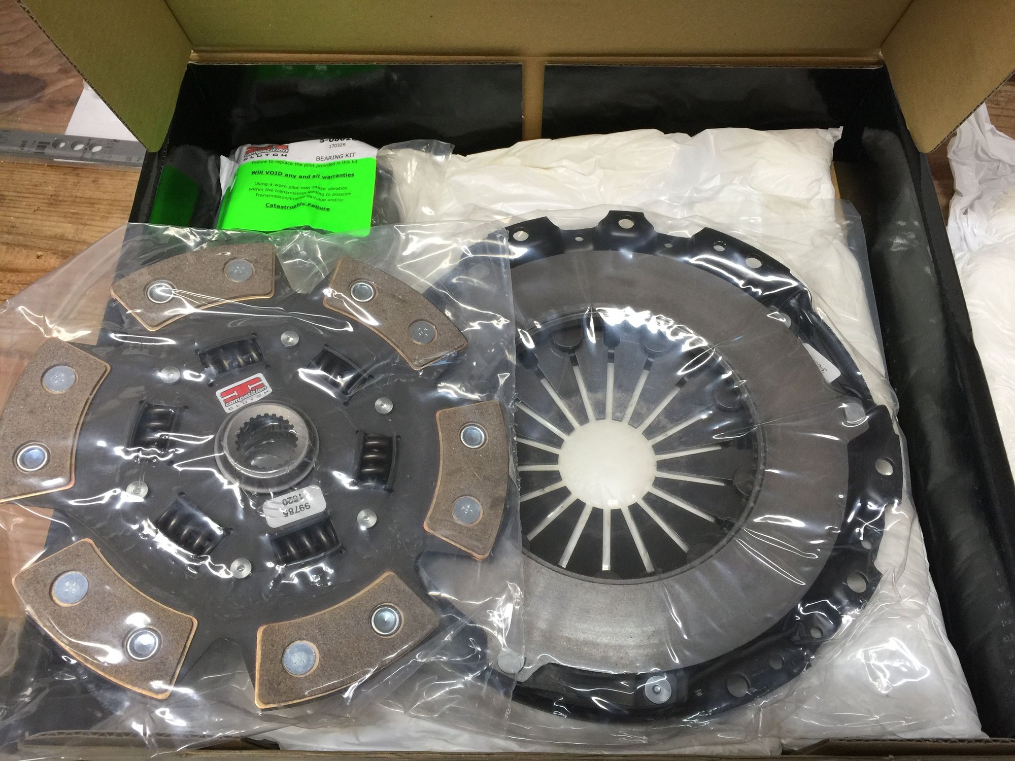

Good to know about the pump retire. One less thing to do. I'm glad I switched to the 255 too because I was looking over my order list last night and noticed I had decided to order 1000cc Inj. Atleast I did that right; the Grams 1000s will give me plenty of room, and still have good drivability.
Wow.. WAY too much clutch for that kind of power. This is for over 250% lbs-ft of torque, which you're not going to be even close to making, with a bit more of leg travel. I'm sure young people disagree with me, but I like smoother, lighter engagements. And yes, you MUST evenly resurface the flywheel for any new clutch on a Honda that you plan to use. There's no "IF NEEDED" about it. That's still DSM talk right there.
Competition clutch is not a bad company. I think, however, you should have asked for a bit more practical feedback on the option choices available.
But, you never know. What one doesn't like, others do.

I think 250% more clutch is about right. Say the stock clutch holds 140-150lb/ft, 250% of that is 350-375lb/ft, and wanting to stay under 80% of the new clutches rating puts me at 280-300lb/ft rating for the new clutch. If I turn up the boost or build a bottom end later Ill still be good. I'd rather have more clutch, than just-enough. I also live in the country where there is NEVER any stop and go traffic. So the extra pedal pressure won't bother me much. Clutch actually just came in.
maybe I'll go ahead and order the flywheel too so I'll have everything starting fresh.

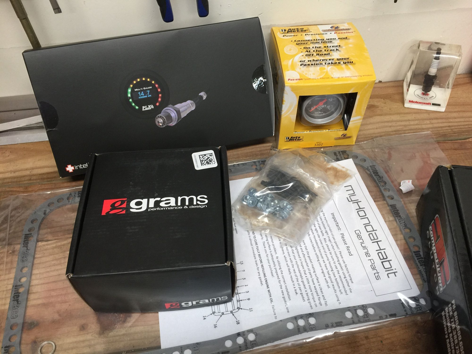

Supporting mods are coming in
Plan is to make steady progress and just have everything complete by the time the turbo kit arrives.

I think 250% more clutch is about right. Say the sticker holds 140-150lb/ft, 250% of that is 350-375lb/ft, and not wanting to stay under 80% of the new clutches rating puts me at 280-300lb/ft rating for the new clutch. If I turn up the boost or build a bottom end later Ill still be good. I'd rather have more clutch, than just-enough. I also live in the country where there is NEVER any stop and go traffic. So the extra pedal pressure won't bother me much. Clutch actually just came in.
Ok. But you'll never make that much torque even when you "turn up the boost" with that turbo. Not until at least the 500whp mark.... Honda is not DSM. They don't make the torque-to-rate ratio you think.
Example: B18C1 at about 350whp makes about 270lbs-ft of torque. that's less than half of the torque capability of that clutch. That basically means that you'd need about 480lbs-ft before that clutch is near its limit. That's over 650whp that the engine needs to make in order to make that amount of torque!!.
But getting another flywheel is fine, but don't get it too light. 12lbs or so is more than enough.
