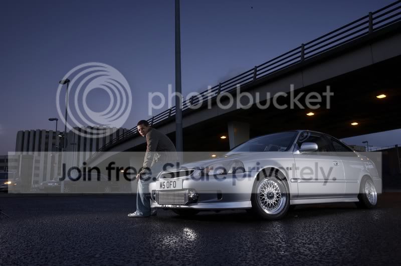

540hp @16psi - Havnt taken it to the track yet, will do this summer
Benson sleeved 83mm B20 block
89mm Benson balanced and micropolished crank
CP 9-1 pistons/rings, Eagle 3/8 rods, ACL bearings
New OEM oil pump, new pick-up, new waterpump
ARP head studs and Cometic head gasket
New SuperTech valves, dual springs and titanium retainers
B16 VTEC head with 3 angle valve job, new seals, surfaced, all done by
PortFlow
CTR intake and exhaust cams, AEM 5 bolt cam gears
New STR fuel rail and new 1000cc RC Injectors
Edlebrock Victor X with stock throttle body, sensors and vtec selenoid
Oil pump adaptor with ls/vtec line in place
external coil plug setup
New timing belt, harmonic balancer
Driveshaft shop stage 3 driveshafts
SPA gauges
Motec M4 pro ECU
Full Race Stage 3 Pro-am Kit
Thermal exhaust

</TD></TR></TABLE>Very nice, Very nice! APPLAUSE, APPLAUSE!

wat turbo is that? t3/t67 H.O? P trim wheel?

Hey dude yeh t3/t67 HO .82 a/r

this is the nicest EK i've seen in a long long time
good choice on the ECU.. i see the Motec distributor mod
are those BBS rims? what's the size/offset?
well done man
