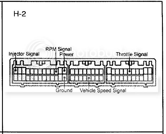

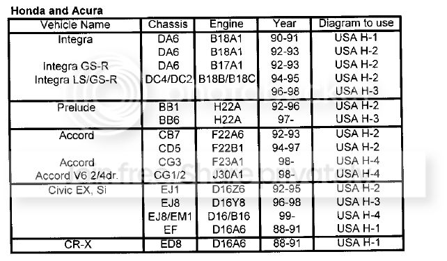

Try this
http://www.apexi-usa.com/pdfInstallation/22.pdf
There is a little info on here
https://honda-tech.com/zerothread?id=211050
But i would go mostly off of Apexi's website. For the most part the install should be the easy part, the setup on the AVC-R is when you are going to have some fun. GL

I need to know what computer you are using, and from what car/year?
Old Nov 2, 2006 | 05:05 PM
95jeremie's Avatar
Posts: 1,466
From: smyrna, ga, usa
Default Re: avc-r install question (urbansi)
p28
95 civic ex
Old Nov 2, 2006 | 05:27 PM
urbansi's Avatar
Posts: 2,636
From: Chicago area, us
Default Re: avc-r install question (95jeremie)
Well for some reason it wont let me upload the thing from adobe, but i did some really shitty paint thing if that doesnt help i give up.

ok well i still need to know what wires go to what from the avc-r
i know that i conect wirers to these points i just don't know what wires are used

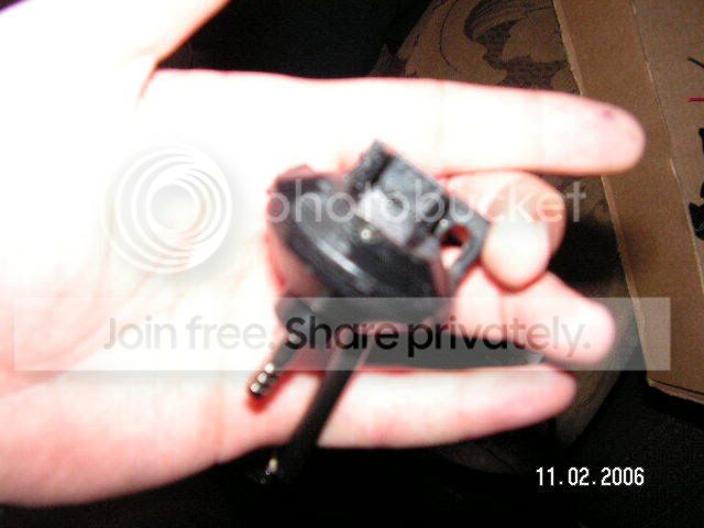

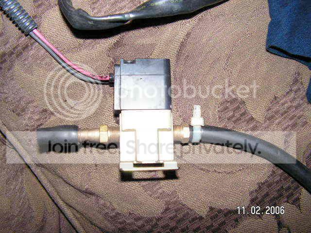

here are some pics that may help
This is the turbo timer that i purchased it came in the same box
i think that this is part of the turbo timer but i don't know. any input?
And i was thinking about installing it in my glove box so it can't be seen but it would make it difficult to use it.
Is this something that should be mounted where it can be easily used?

<TABLE WIDTH="90%" CELLSPACING=0 CELLPADDING=0 ALIGN=CENTER><TR><TD>Quote, originally posted by 95jeremie &raquo;</TD></TR><TR><TD CLASS="quote">
That is a 2.5bar map sensor with a pigtail on it for wiring up. It would require the proper ecu support to work.

<TABLE WIDTH="90%" CELLSPACING=0 CELLPADDING=0 ALIGN=CENTER><TR><TD>Quote, originally posted by splitime &raquo;</TD></TR><TR><TD CLASS="quote">That is a 2.5bar map sensor with a pigtail on it for wiring up. It would require the proper ecu support to work.
I have my avcr wired through my glovebox, it lives there when the car is parked. When I'm driving, I bring it out and mount it in middle of the dash (old civic, flat area, velcro is your friend). </TD></TR></TABLE>
ok it's a 3bar Motorola map sensor. i forgot that i purchased it lol. what do you mean it would require a proper ecu? i will use a p28 chipped with chrome pro
Old Nov 3, 2006 | 06:42 AM
splitime's Avatar
Posts: 5,695
From: Chicagoland, usa
<TABLE WIDTH="90%" CELLSPACING=0 CELLPADDING=0 ALIGN=CENTER><TR><TD>Quote, originally posted by 95jeremie &raquo;</TD></TR><TR><TD CLASS="quote">ok it's a 3bar Motorola map sensor. i forgot that i purchased it lol. what do you mean it would require a proper ecu? i will use a p28 chipped with chrome pro</TD></TR></TABLE>
Last i checked... that is a 2.5bar... not a 3bar.
I p28 with crome will handle it fine. It just requires wiring the sensor in.

Default Re: avc-r install question (splitime)
well picked it up from soccerking3000 he told me it was a 3 bar
correction it is a 2.5 my bad i looked at it wrong (just checked)
