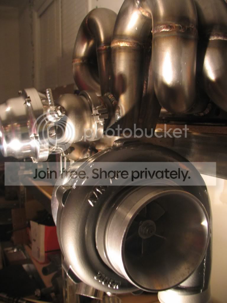

Ah. He means this:
One of my custom "Red Pills"..
I do know that Wantboost has a variant of the GT37 I made for him.

isnt that one of the sexiest pics ever? i just cant wait to use my turbo... the motor is pretty much done, just waiting for my car to be done to use it.
