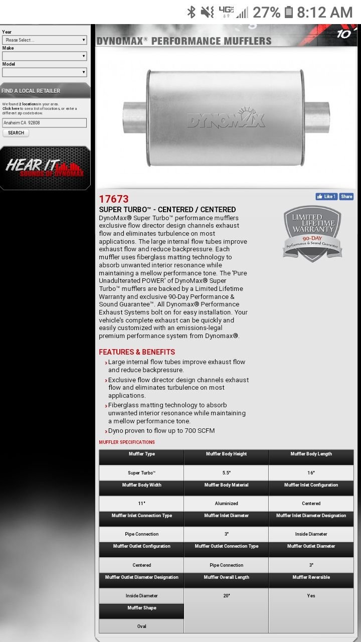

Or get something like this for 3" which will still be quiet.
Come in various body sizes
