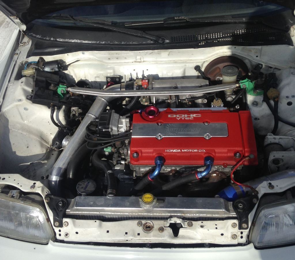

please get a photo of the entire engine bay, front end, and the distance between the radiator and intercooler. This will help with a possible diagnosis..

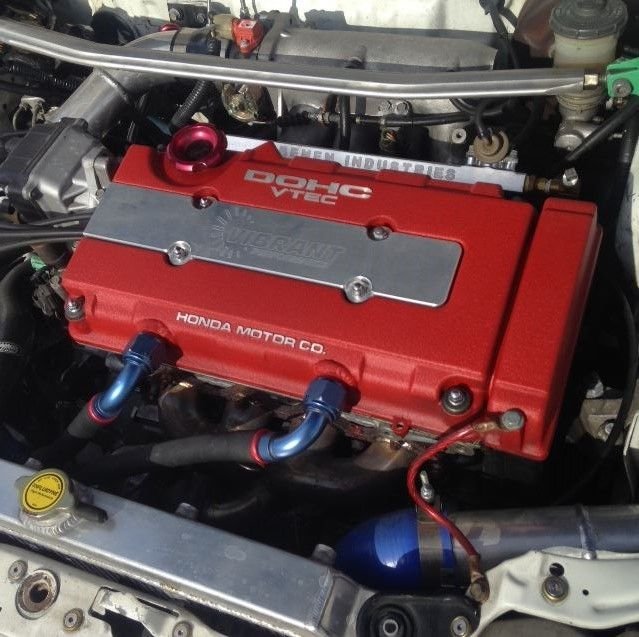

Sure no problem! I appreciate the help.
Here are the photos I have currently. I'll have to figure out how to get in there for a pic to show the space between the radiator and the intercooler. I'd estimate maybe 4" between the two.
Sorry I know it's hard to see, the turbo is really crammed down in there between the radiator and the block, I think this could be part of my problem.
I am not sure the type of fans, but they appear to be 12" fans. I'll have to pull the front bumper off, maybe even the intercooler to even get in there and take a look at them.

The manifold is causing the issue due to its proximity to the radiator. A good quality half sized radiator like a Koyo or Fluidyne half-sized radiator will be perfectly fine, without any issues.
AZ_CIVIC is correct. Pusher fans just aren't going to cut it, especially if they aren't good quality, high CFM fans like Zirgo or SPALs. Sure they're more expensive, but they are easily worth the cost.

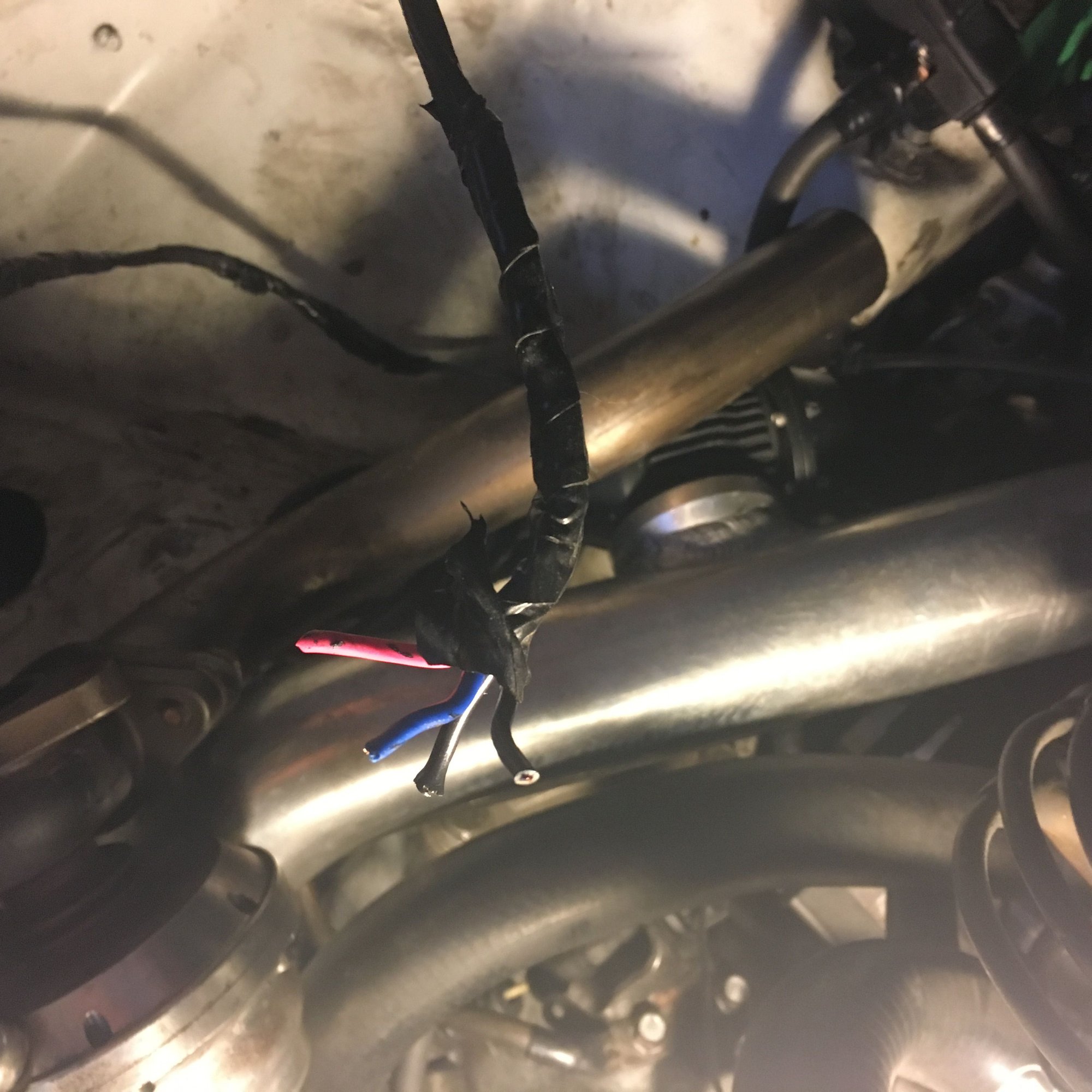

Got the old radiator and fans out. They are 2 non-brand 10" fans, from what I can tell.
Looking at the space available, I might get the S2 rad first and test fit it, then see if there will be room for a puller. If not, may be forced to run a SPAL pusher instead. It doesn't look too promising with my downpipe.

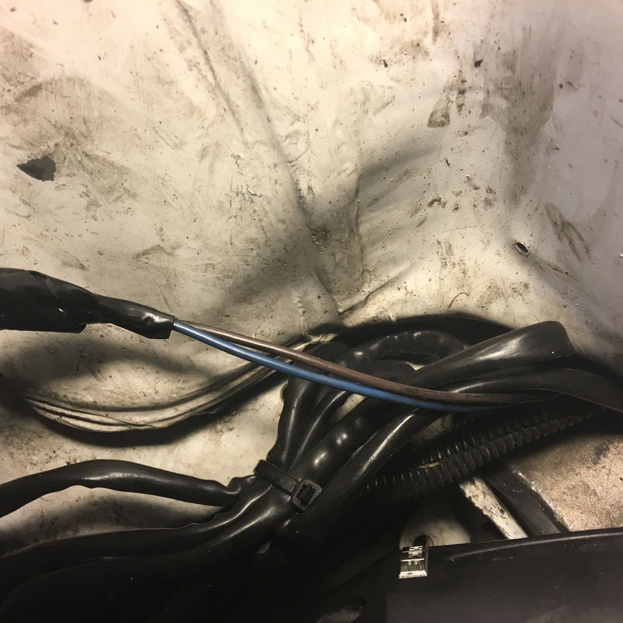

They completely screwed up the fan wiring too. They pulled power from ignition switch accessory wire, ran it to a toggle switch, then straight to the fans and a ground. No fuse, no relay, and idk how the hell I'd even start trying to wire it back in the oem way. How dangerous is this? Any help I can get locating oem wiring and using it?
Thanks
Might try to sell this setup.
These four wires powered the fans
Spliced into these two, which ran to the switch inside
Blue wires go to power and ground, white and black go to fans.
