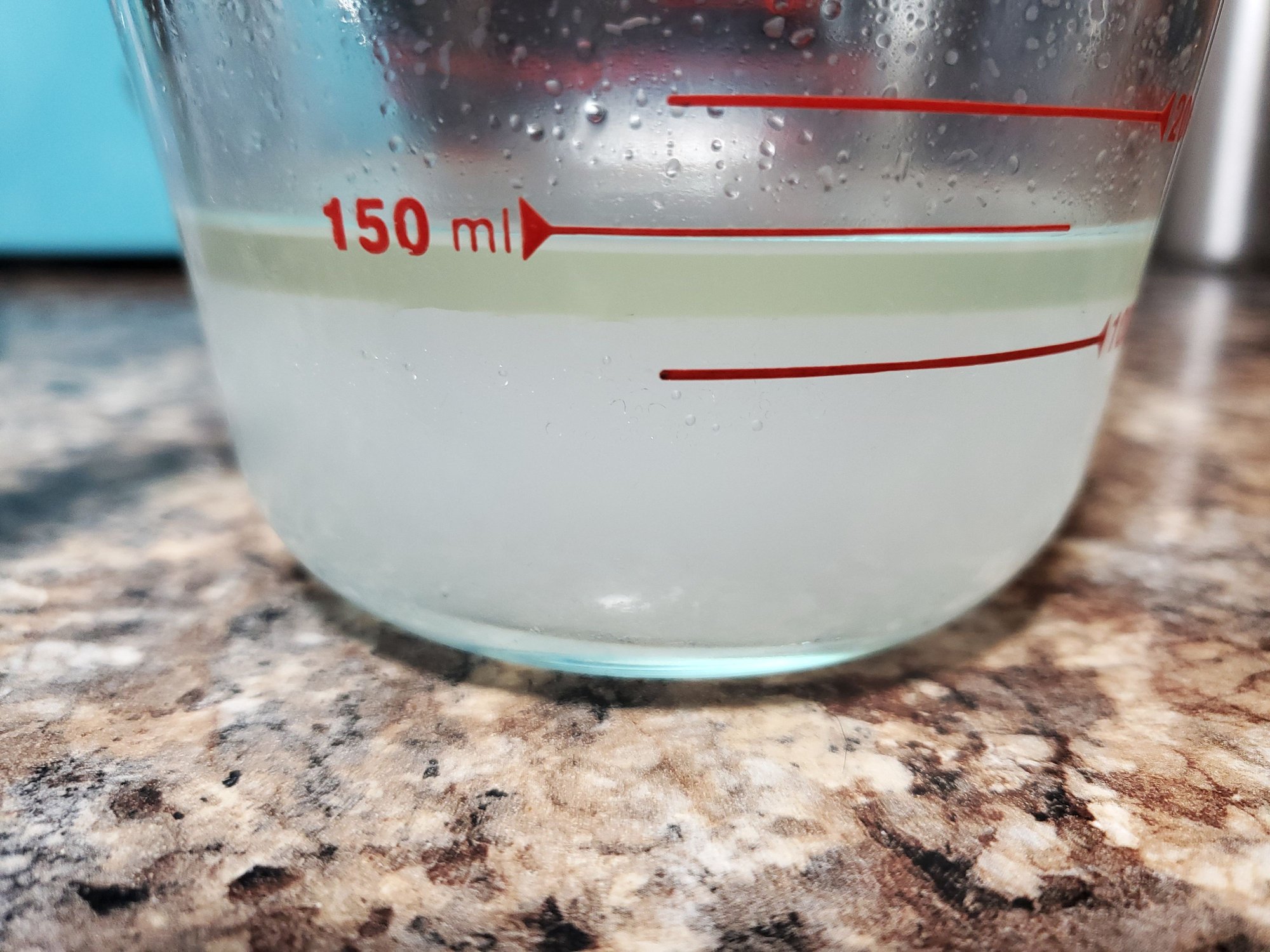

My original calculations I did on the fuel before my tester came in put me at 50.6, rounding to 51%.
Turns out I was off by a lot. Lol! My volume calls here were off by about 25. I'm barely mathable enough to remember that 2+2=9.. Anywho, I noticed at the pump the next day they had a certification sticker that said 70% and when my actual test kit got here, it checked out to 75% and has been beautifully consistent at that rate for the last 50 gallons.
