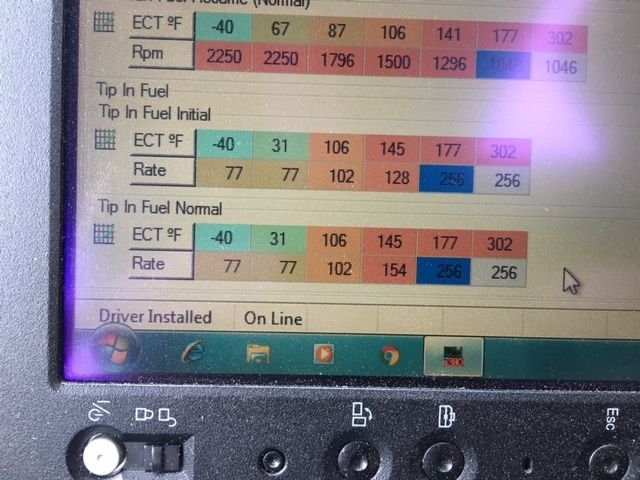

Also, here are the TPS tip in settings.... Are these the ms that the tip in is active?
