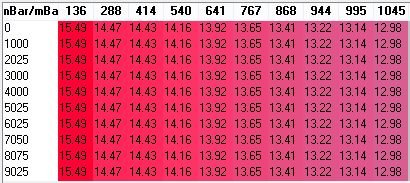

whats the ideal AFR for B16A for power ?
is 12.8:1 - 13.2:1 ?
my compression is :
cylinder 4 - 11.5
cylinder 3 - 12.5
cylinder 2 - 11.5
cylinder 1 - 12.5

your compression is awful... like, pretty sure you have some bad rings, ring lands, or a leaking head. your AFRs are not actually going to be accurate with an 8% variation per stroke. You should sincerely consider an overhaul before you bother tuning.
But I would go about 0.4 richer in the last 4 columns regardless.
If you graph it and find it makes more power leaner, that's great, but especially with how wonky your compression is I doubt it would make any gains.
At this point you're just trying to avoid detonation.
