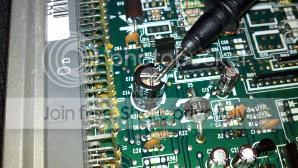

If your sure its a issue within the ecu look into replacing the capacitor located at C14 inside the ecu. This is a common problem in obd1 honda ecu's. Every time i chip a ecu i replace this.
yea i had put in a new relay when it first happened. and i had all the caps changed when they rebuilt it. i was think more along the line of a bad fet
