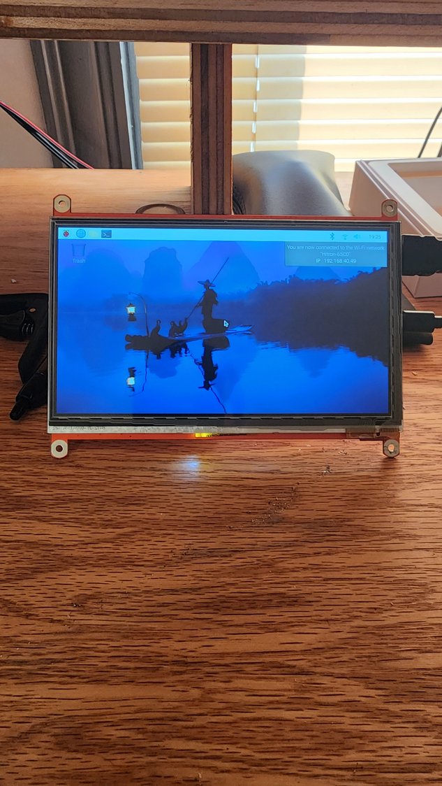

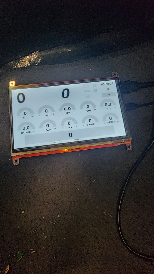

Got everything setup and installed. Hooked it up to my S300 V1 in the car for testing and I'm at my first road block. The PI isn't reading from the S300. Not sure if this is because it's a S300 V1 and not V4, but now for trouble shooting
