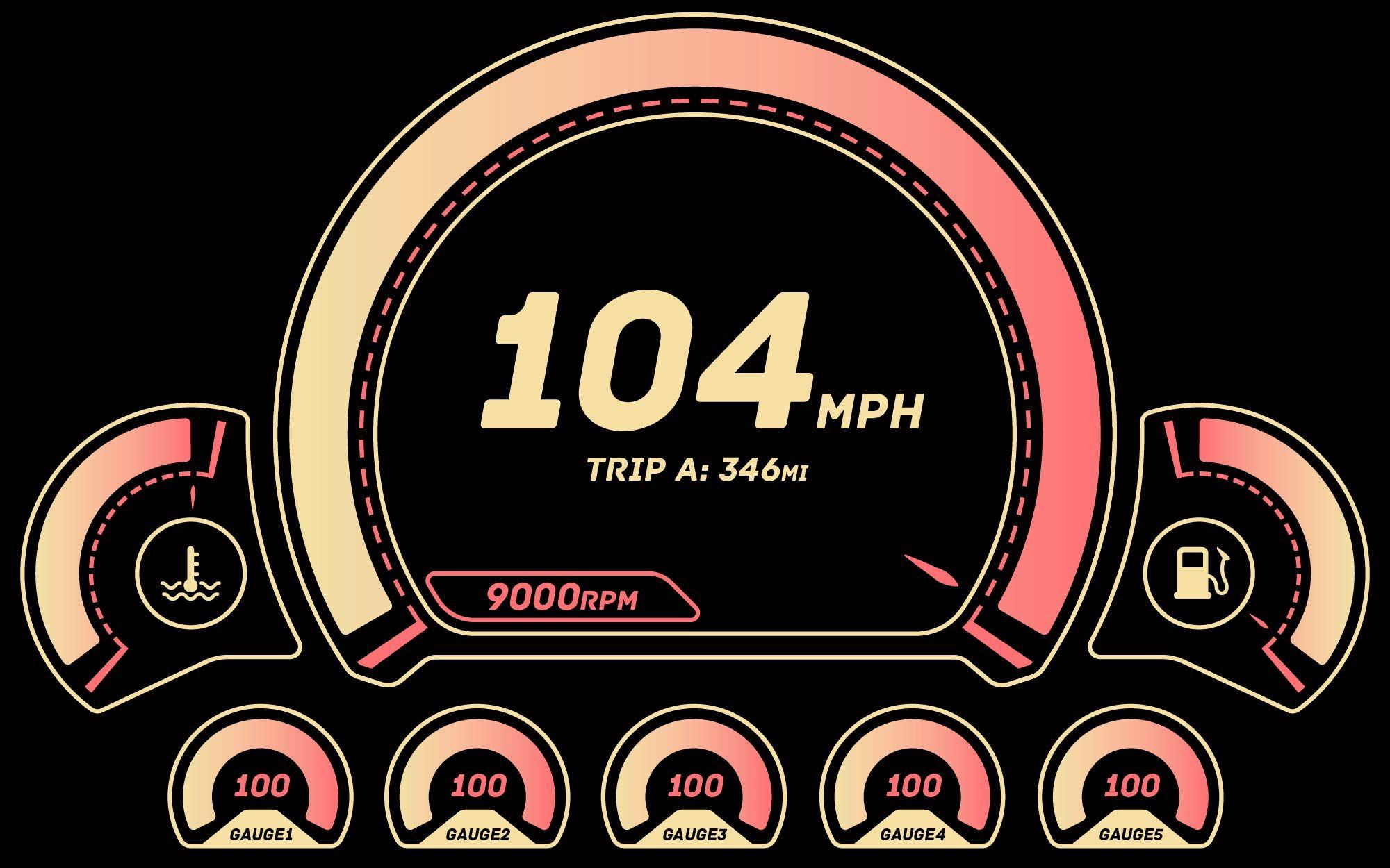

Here's some little test with the new rpm classic style

Got bored today and started working on some dash interface ideas. I'm really hoping to find the time this winter to build myself one of these and work on making some different skins.
I've been looking for a cheap OLED monitor to use for this project. I think gauges would look great on OLED since the black pixels are unlit and only the pixels displaying color light up, unlike an LCD display where the entire screen is always lit up when it's on. OLED combined with some custom moulding and a gauge skin to match the moulding could make for a really clean and high tech looking setup.
you are right, an OLED would work perfect for this, I'm using and IPS lcd which is also good for black.
concretely I'm using this one: 7" inch HSD070PWW1 B01 1280 800 LCD Panel LCD Controller Board Touch Screen | eBay
Man, that graphics look awesome, I prefer a classic style but this is also cool. If you want I can give you some inspiration and see if we can make a new design we like both.
That's a nice looking, fairly priced display. I've found a few 7 or 8 inch portable OLED monitors used by professional photographers, but they're crazy expensive, anywhere from $1800 - $5000 so not really an option. I did find this Dell Android tablet with an 8.4 inch 2560x1600 OLED Display. It's pretty cheap at $350 so I was thinking of buying a used one and seeing if the display could be easily hacked out of it and used with the Raspberry Pi. This could be more trouble than its worth though. Another option would be to use a VNC app on the tablet to mirror the Raspberry Pi output, but that solution is a bit too janky for me.
Yeah man, I'd love to help you design an interface for your liking. If you want to just do a rough sketch up of the layout you'd like I can just pretty it up for you and create all the graphic files. Or if you just want to give me a list of the info you want displayed with a description of the style you're looking for that could work too. Maybe even link some images of dashes you like from other cars and I could try and replicate their style.
