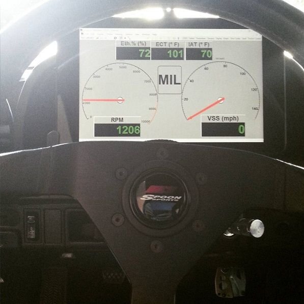

I run the flex fuel sensor with S300 V3 and have had no issues. Had to put some 92 octane in on a long trip and it was seamless. I'm using a tablet running off of Bluetooth as a display for Smanager so I always know what my percentage is as well.
