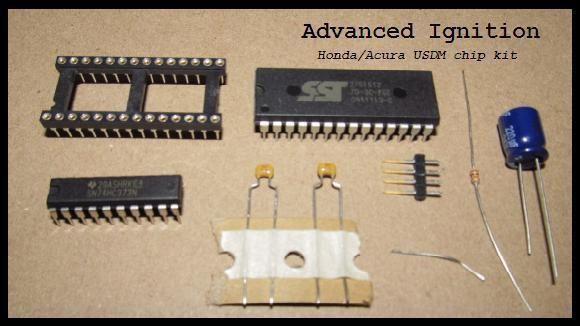

Thanks for the great info. He stated the same concerning a Hondata s300 and said it would cost quite a bit more if want to go that route. He said he uses a company that sells refurbished boards and his labor plus part (ECU) is $225. Dyno tune is $300. I've seen refurbished EBay boards for around $125-$150 but not sure about those. The Mugen socket/chip kits for $10-$20. As I am not planning to add a Vtec head or boost I want to keep the expense minimal but willing to pay a bit more for better quality. Are there any mid-level companies you can recommend? Do you know why he told me socketed only and no chip? Would it need the other items shown in image?:

Yes, you will need the other components in that picture. They are required for the chipped ecu to function and to enable datalogging. Tuning without data is just guessing.
