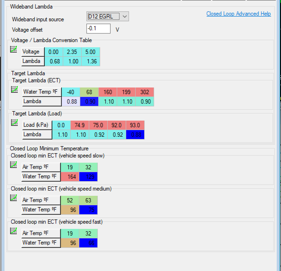

Default Re: AFR at idle issue
Here are my settings that work well for my setup.
You should be able to cut your gains in half from where you are, trim the limits too. I guarantee it will run smoother, if your actual fuel maps are pretty dialed in.
*** I am open loop at idle due to running a lean-cruise cal. That's why the max TPS is 0% in those sites.

Originally Posted by spAdam
Hmmm....looks like you subscribe to EPA, no?
I did a month to see if I could pick up a couple of things and I did. Was also happy to see I’d gone the right direction on others. But if you look at the way the lambda control normally behaves it’s pretty clear that the first step is to calm it down and clamp.
I don’t understand why he used the voltage target when s300 actually has some limited lambda target maps. I run closed loop with multiple targets at different temps everywhere except idle as the wot line, works great. The trick with using any kind of closed loop control is getting your maps as accurate as possible first so the control doesn’t have much to do except compensate for fuel blends and variables you just can’t predict. Formula, IndyCar and LMP car engines aren’t running open loop unless they are in a limp mode (but they obviously have better control than we do).
Also, I do calibrate for a living 👍🏻
