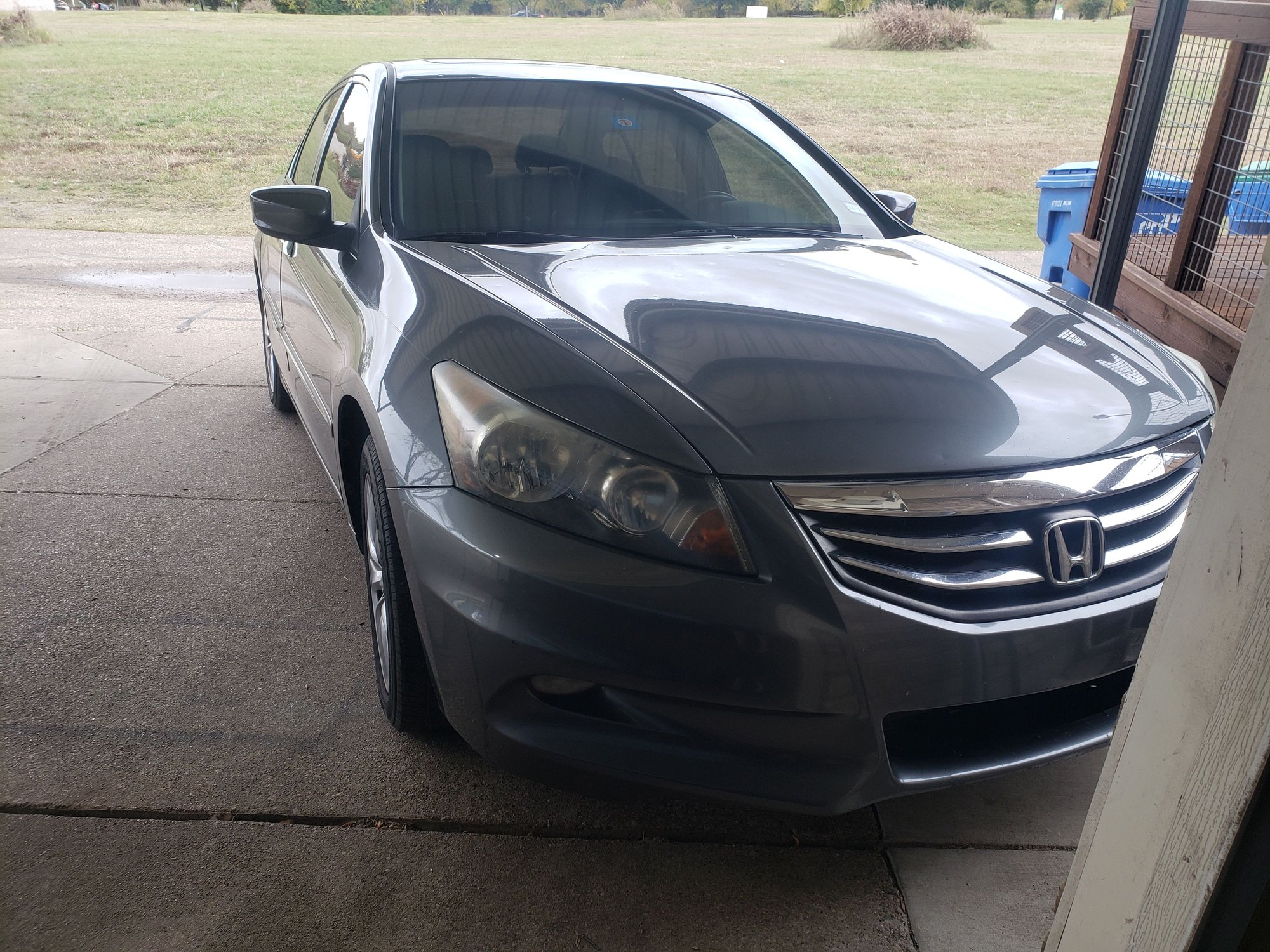

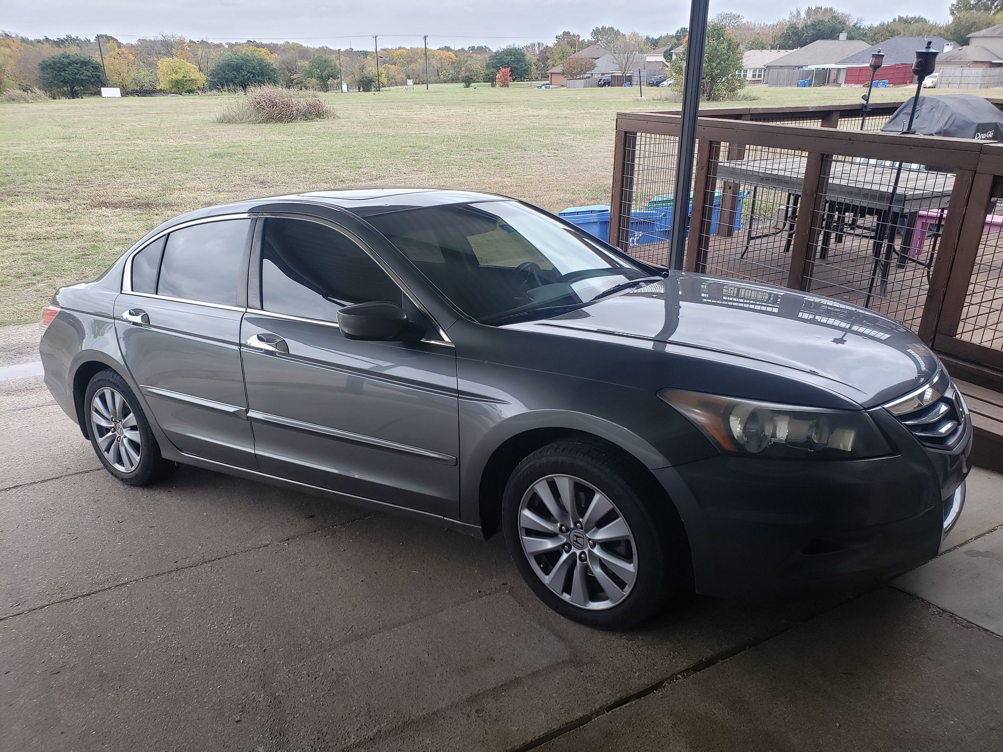

Thanks for the help yall I got it eventually shes running beautifully changed the spark plugs and trans fluid and she runs like new.👍
