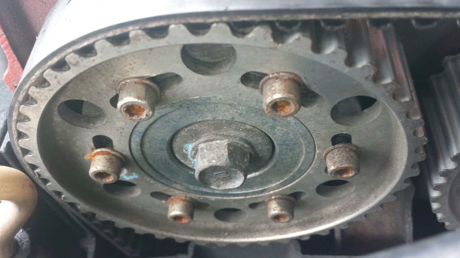

Is it the four holes on the cam cover to pin the cams? Or is it different from the B16?
Note: Not my actual engine, just a picture i got online for reference.

Yeah, should be those four holes. You only need to pin one for each cam. There may only be one place in the camshaft to pin it anyways. Just use a drill bit or something.
