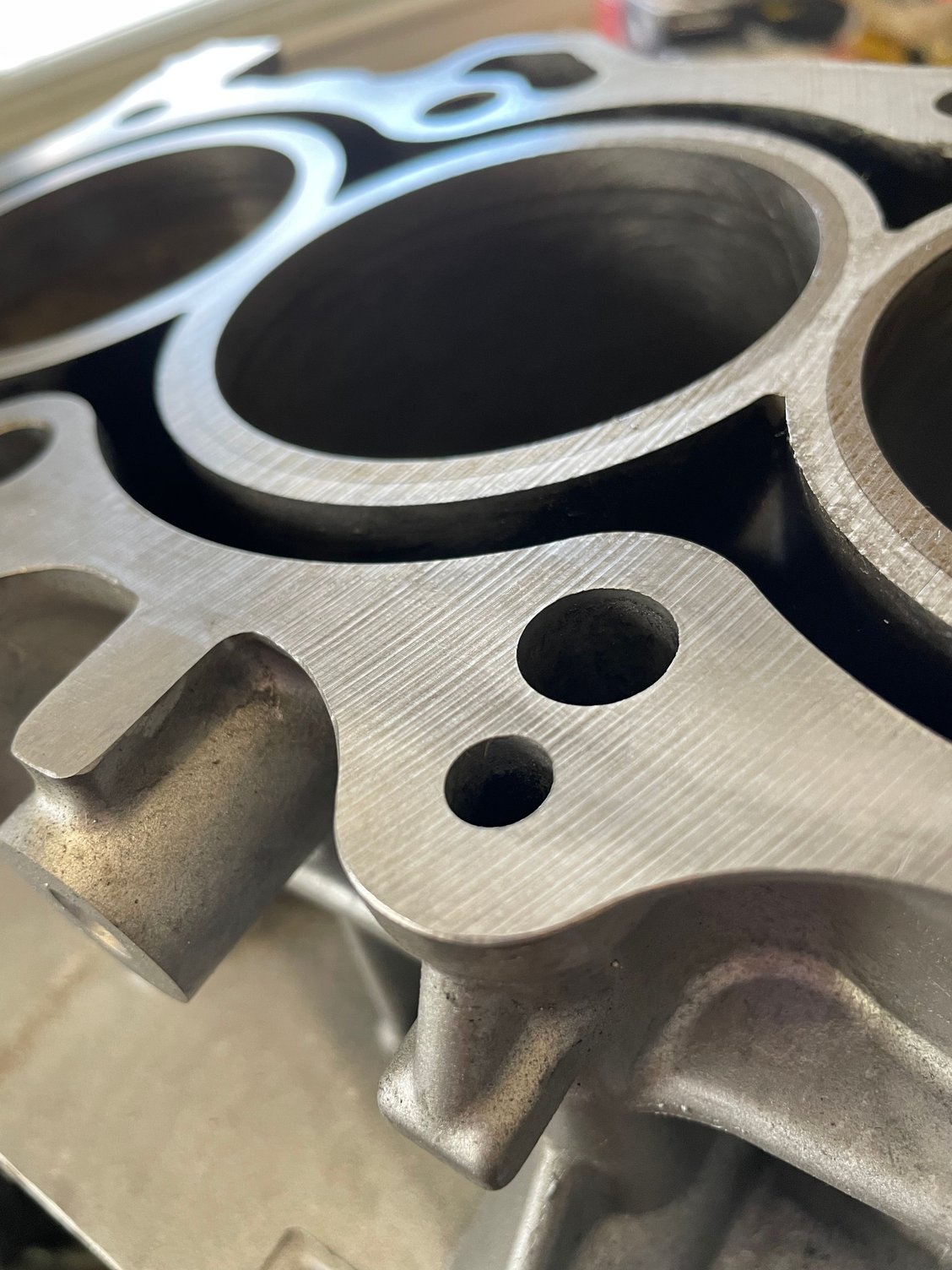

You can kind of see the ridges here. Can feel with fingernail

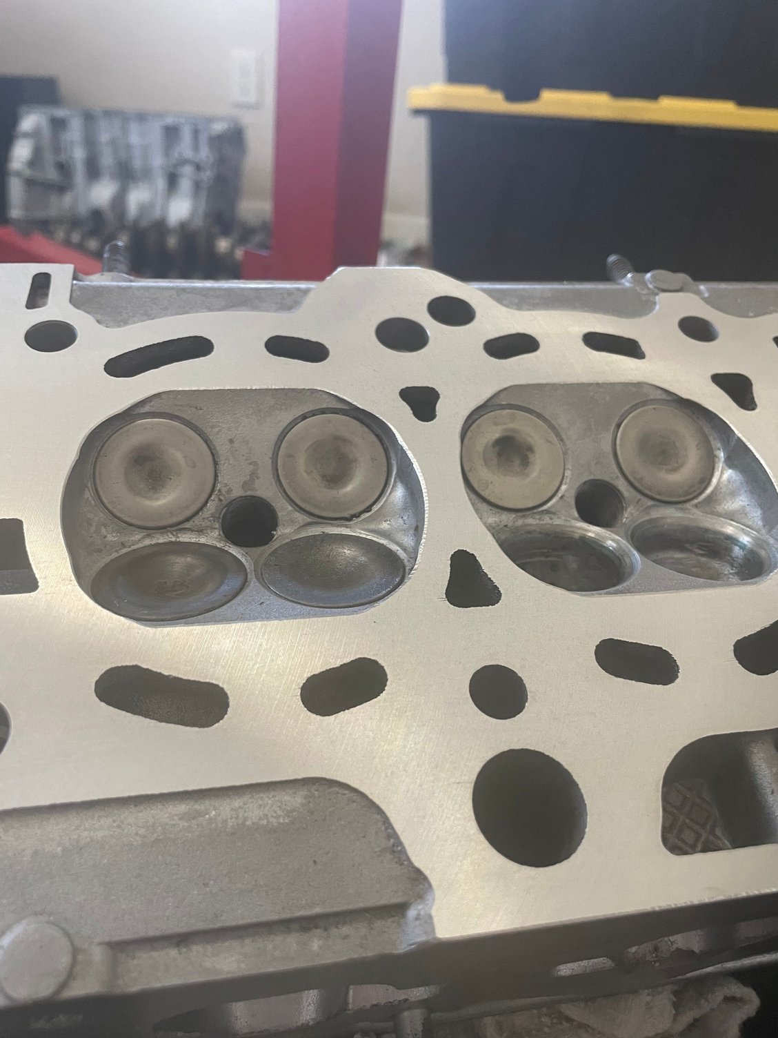

I took my d17a2 out of the car to rebuild. It was smoking on acceleration and consuming a quart of oil every few days. Had 350k plus miles on it and I am keeping the car so a rebuild was in order.
Machine shop I usually take it to and does a good job had a turn around time of about 6 weeks. I found a place that would do it in a week. Had d17 block decked and head resurfaced along with new guides and valve seals. Took a b18 block also that needed old red paint stripped and decked also. Paid around $800.
When I picked up pieces the place was filthy and unorganized. There were metal shavings everywhere. The “hot tank” was a makeshift tub filled with chemicals. He said he put drano in it. He also painted all the pieces all over. There was paint and other caked on crap on surfaces that were “machined”. He said to just wipe with laquer thinner and it would come off. It did not.
I took the head to the shop I used before to get it resurfaced as I was not satisfied. The head and block have ridges that I can feel with my fingernail. Also had caked up godknowswhat I could take off.
they also told me that the guides had not been done and he also lost two retainers so he put on random ones he had and the springs were not sitting perfect.
Here’s a pic of what the head looks like now that it’s been fixed. Valves missing because I haven’t put back in. Just got new retainers and seats from Honda because he lost them.

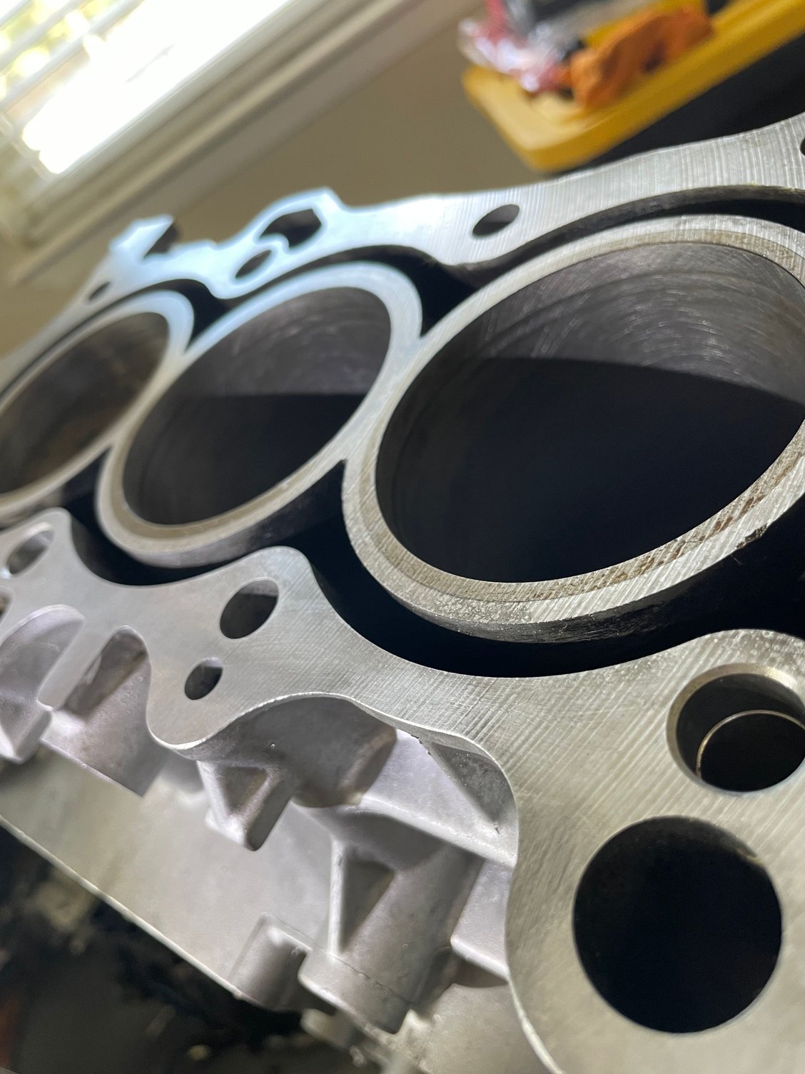

The head is good now. Wondering if the block will be ok or should I take it to get inspected. I don’t wan to buy a straight edge just to use it once and I don’t wan to disassemble the bottom end just to take it to a shop and they tell me it’s fine.
I will be using a mls felpro gasket so do you guys think I should just send it? Or disassemble it and take it to machine shop?
hopefully you can see the ridges on the block. Head has visible ridges from machine shop but I can’t feel with fingernail and it’s a mirror finish.

MLS gasket will not seal on that deck surface.

I would personally want a finer finish than that. I had a problem with my MLS head gasket sealing with a rougher machined surface like that, but I'm boosted. I ended up resurfacing myself with a small granite surface plate and some 600 grit paper. You can either DIY or take it to a machine shop well versed in aluminum import engines and have them re-cut the deck.
If you want to check flatness, you can pick up a cheap aluminum straight edge from Amazon. The one I have is flat, but being aluminum is susceptible to getting damaged easily, so handle it carefully. It's a good, cheap option, though.

Take it to the good shop. It won't hurt. But it certainly will save you from more downtime and money if the thing leaks once you spend the effort putting it back together. If you are questioning it, I think you've already determined you know it's not right too 🙂
