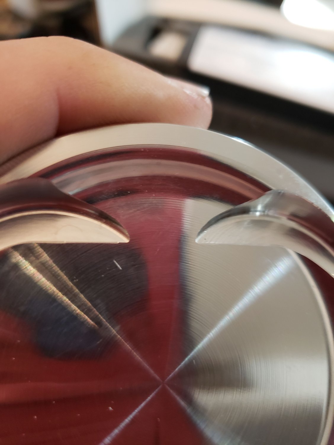

Should I be worried about this scratch? I can feel it with my fingertip and my fingernail catches when dragged across..
Brand new set of CPs..

no. but if it was mine, I'd hit it with some emery cloth

I wouldn't worry about it, you will get enough carbon build up on that you wont see it after your first drive. I would however recommend coating the pistons if you have the cash. It goes a long way and works well.

Thanks! None of the edges catch a Kleenex, so that's a plus. I've got some 2k grit wet/dry stuff around if need be.
