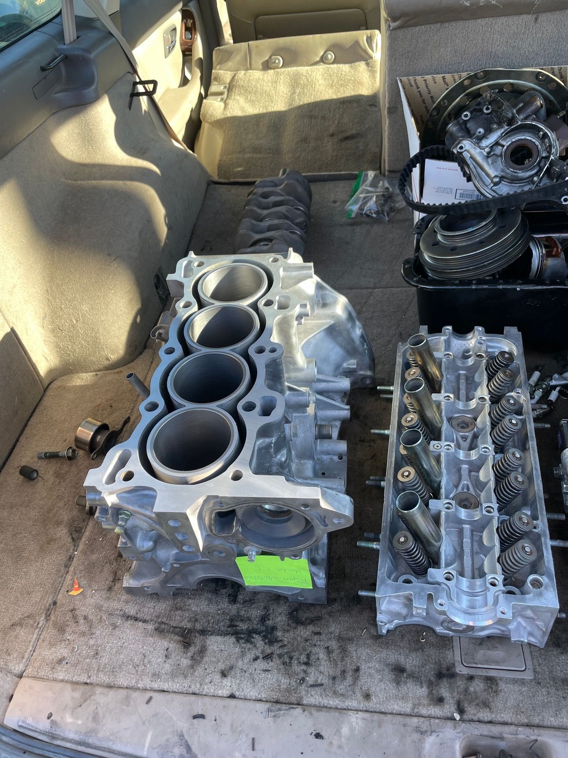

Ok, I know this topic has been discussed to death, but with 20+ years of forums I cant find any clear information, let alone up to date information. I need a few things explained, for context, I'm building a d16z6 for 250-300whp, I'm going with eagle rods and cp .0020" over 10.5:1 pistons. I bought an engine off fb marketplace for the build, and took the head, block, and crank to the machine shop. They bored the cylinders .0020" over, decked the block, cleaned it, resurfaced the head, did a valve job, replaced some valve guides and seals, cleaned it, and polished the crankshaft. I now need to know what bearings to buy. Heres the information I have that I need clarity on, from the factory, honda put different bearings in each section so that the clearances would be perfect on each. These are color coded. I've also heard you cant buy them anymore, is this true, and should I just not even be considering them? Assuming I shouldnt even be considering oem bearings, I see 3 real options, king, acl, and clevite. Between king and acl people tend to fight it seems as to which is better, and I havnt heard much about clevite. Heres where I'm confused. It does not seem like each brand has an equivalent sized bearing to the honda oems, they just have std size and an oversized? or maybe they have more options but I cant tell what they are? I also am pretty sure I dont want race, as this will be a street car and my goal is to not rebuild the engine for 100,000+ miles. Also real street performance (Where I'm building my rods, pistons, and bearings package) does not show king have non race main bearings. Am I just missing something? And I had my crank polished, does this mean I need oversized bearings? what about my cradle, do I need to do machine work to it? So I not only dont know what size bearings I should even want, I dont know what my options for bearings even are. And lets say that because I can no longer trust the oem size markings because I had my crank polished, How do I measure it? plastigauge requires that I already have the bearings so its a catch-22 thing. Also what clearnce should the plasticgauge read? Some people say .0015, some say less because looser is better? I'm super confused on the whole thing and could really use some advice, I dont just want to buy standard acls and throw them in just for the plastiguage to tell me I'm way off.
