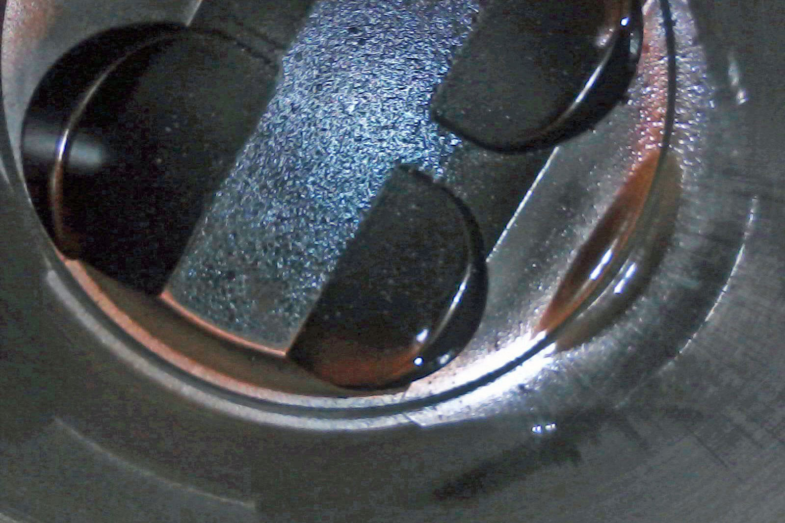

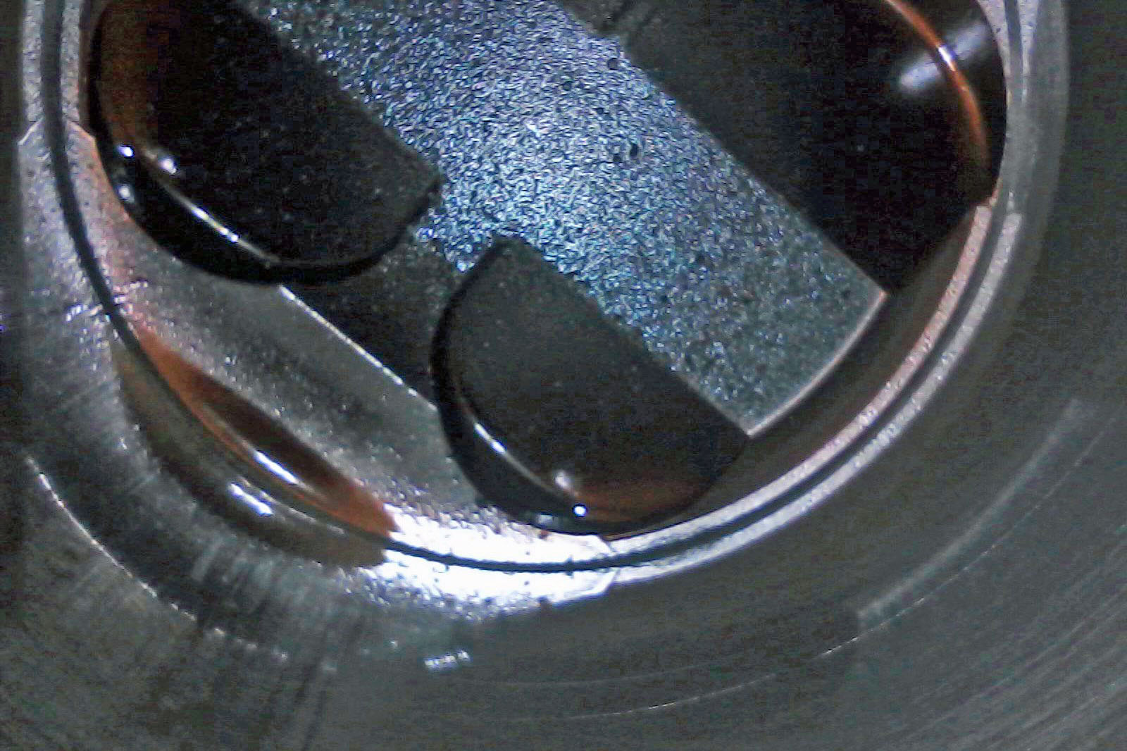

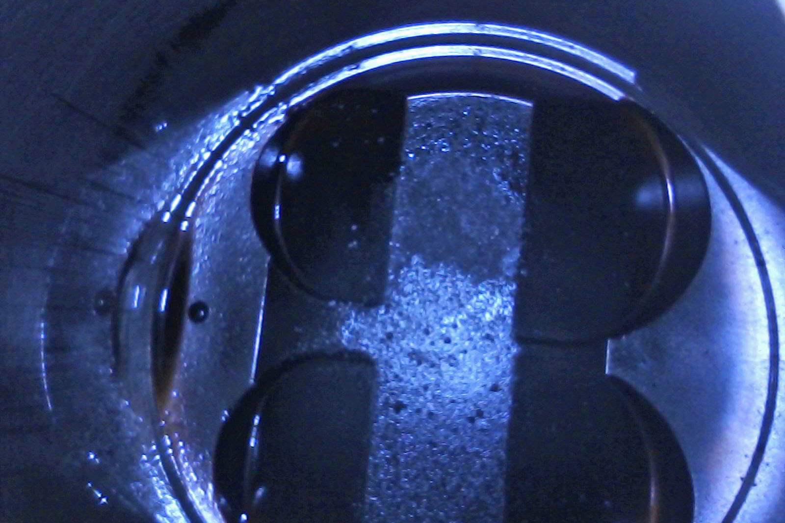

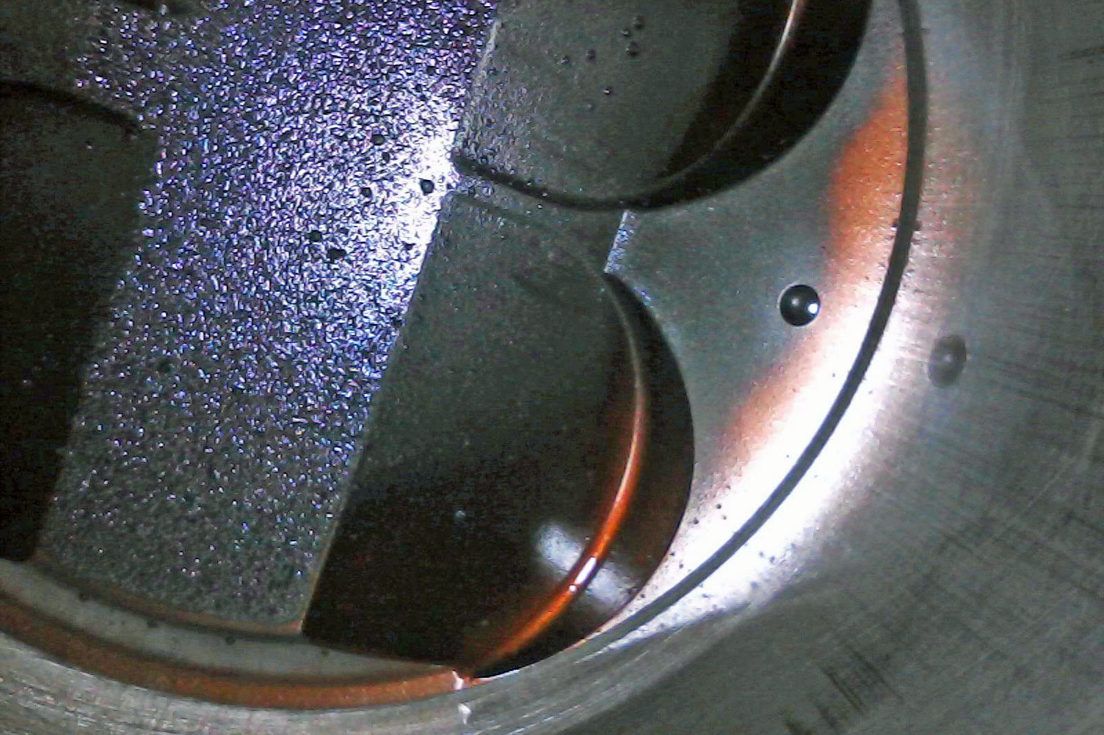

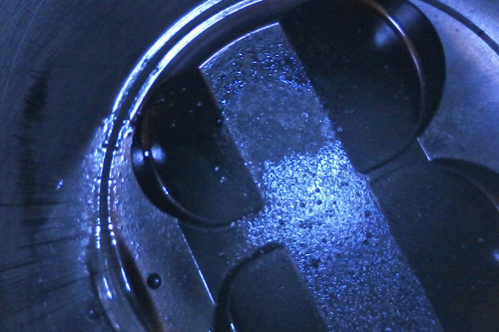

I went poking around with my borescope and looks like my machinist fucked me. The bores are all scored pretty badly on both minor and major thrust sides with all the crosshatching worn away in some places, I suspect he set the piston to wall clearances too tight but I won't know until I tear it down and measure. With any luck the block can just be honed out another thousandth or two to achieve the right clearance and the pistons replaced, but if not then Benson sleeves are in my future.
I didn't measure those clearances myself because I didn't have a 3-4" micrometer to set up my bore gauge so I stupidly trusted the machinist. I measured the difference between cylinders though and found them all within 0.0002" or so so I thought I was safe, because no way he screws up all 6 right? Hah. I'll probably kick myself for this for a long time, I don't understand how so many hack machinists manage to hold such good reputations.
A different guy did my heads and he has tons of experience with 90s Honda heads, and all the valve seals were replaced with new OEM seals, the intake guides were fine clearance-wise but the exhaust guides were redone. The car exhibits no other typical valve stem seal symptoms.
Cylinder carnage pics, because these threads aren't fun without them. Excuse the photo quality, the borescope cost me like $20 on Amazon. The weirdest thing about this is that the spark plug electrodes look perfect while the piston tops are a mess.
These three photos are from cylinder 4, but all showed similar damage.
These two are from cylinder 1.

Yep. Piston to wall too tight. Pistons might be salvageable if there are no deep scratches on the skirts. Can get them recoated and get a new ring pack. Personally I would be after that machine shop for the cost of the original work at least. A good one will stand by what they do.
