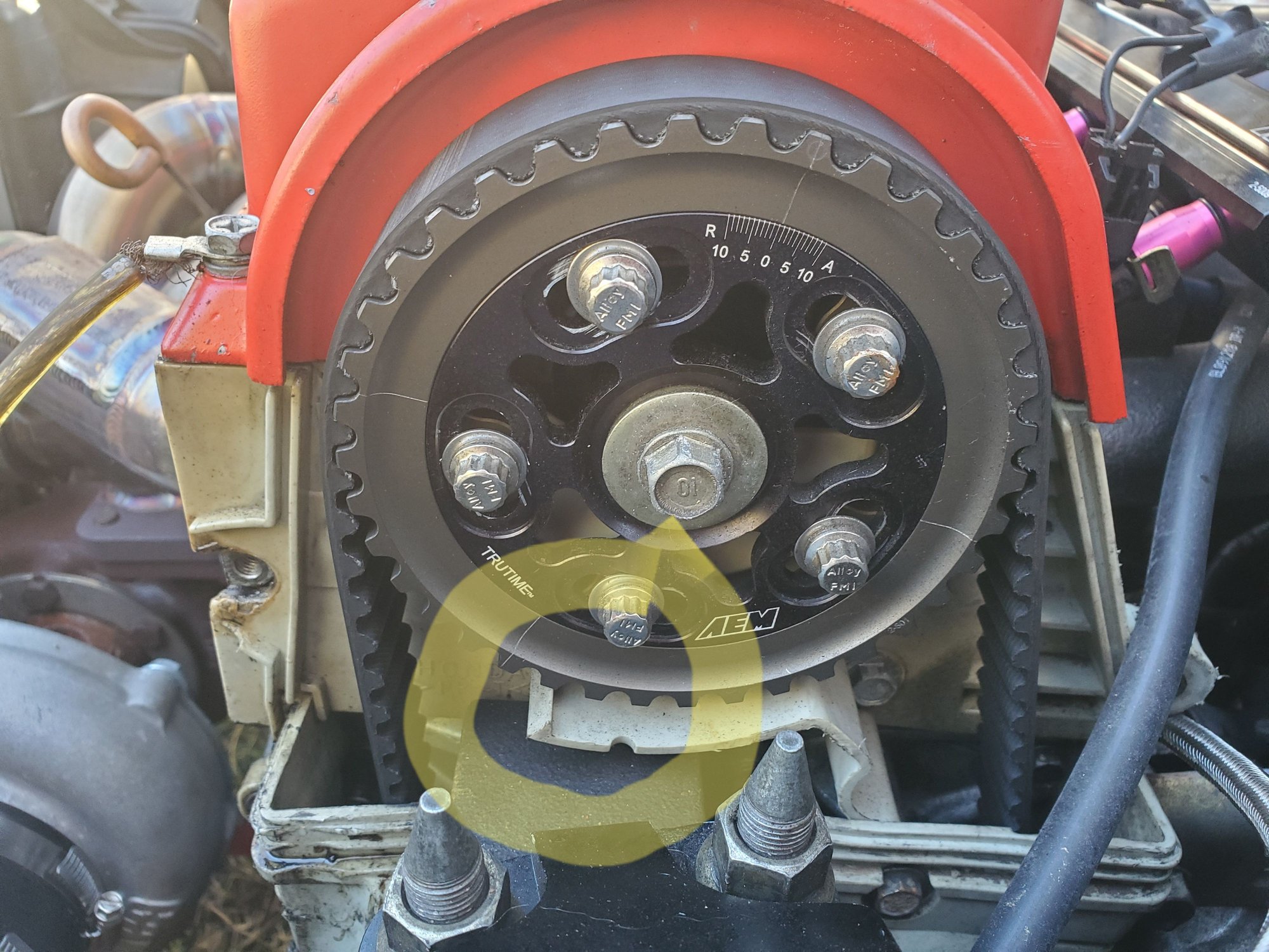

I got it close by "bumping" the key to rotate it. I was being lazy today, lol! I circled the mark that lines up on the upper cover with the adv/ret numbers being up top.
Old Dec 23, 2019 | 02:43 AM
HondaHannes's Avatar
Joined: Dec 2019
Posts: 7
Default Re: How to degree SOHC engine
Thanks for the Pic!
