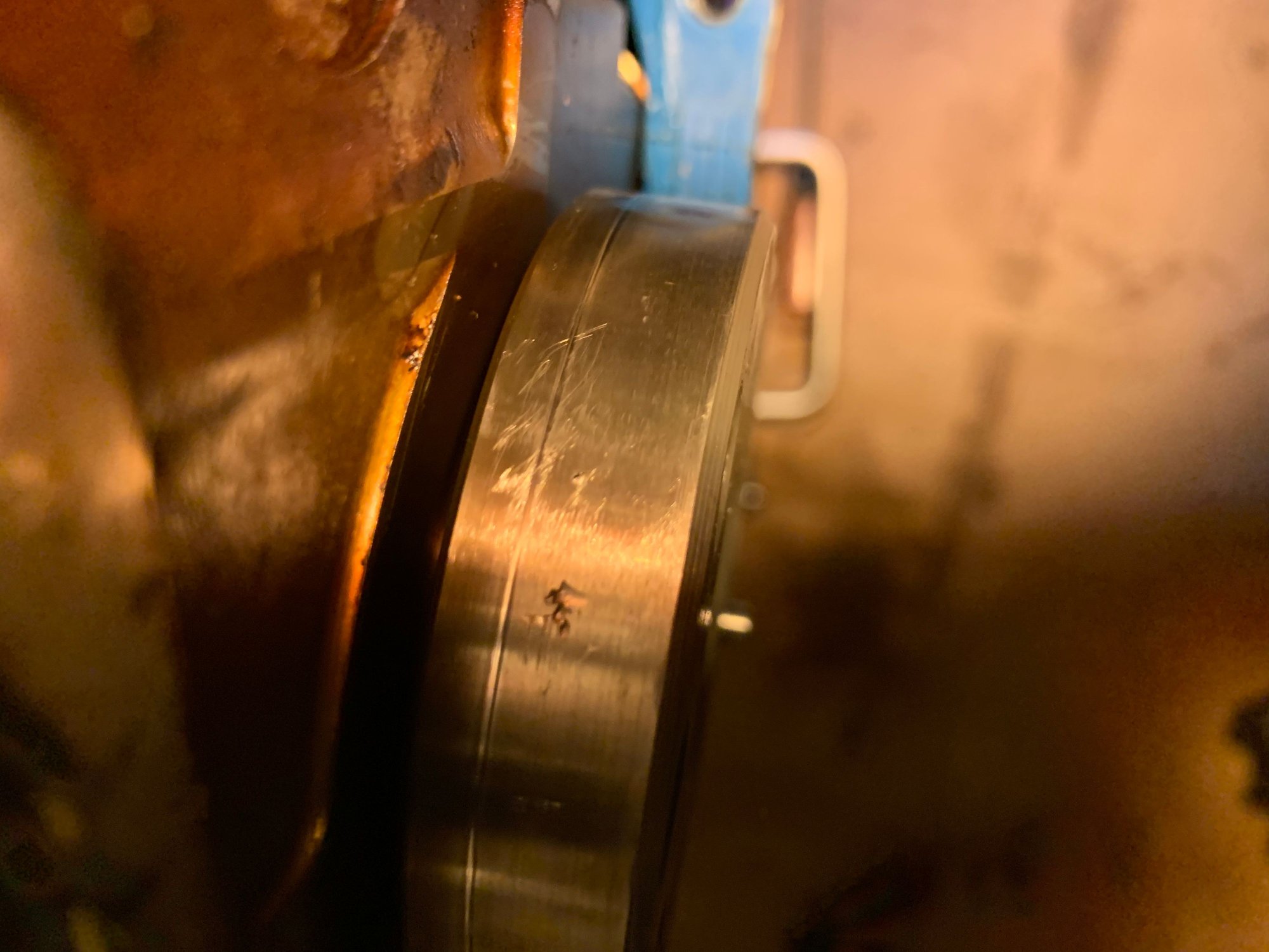

Default Re: Front/rear main seals question
Ok. Tonight we pulled the plate/housing for the rear main seal off of the motor. I was just checking some things out. First, the seal sets in the housing nice and tight. As for the crank. It has some blemishes and a very slight ridge in it that you can barely feel with your fingernail. Also, I put the old seal over the crank(without the housing) just to see how it fits and its real sloppy on the crank. I would think it should fit a little tighter than it does. Does anyone have any idea about that? All this has me thinking about installing a repair sleeve. Any input would be appreciated. Thanks

Here is pic..
