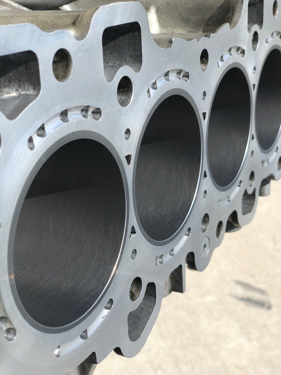

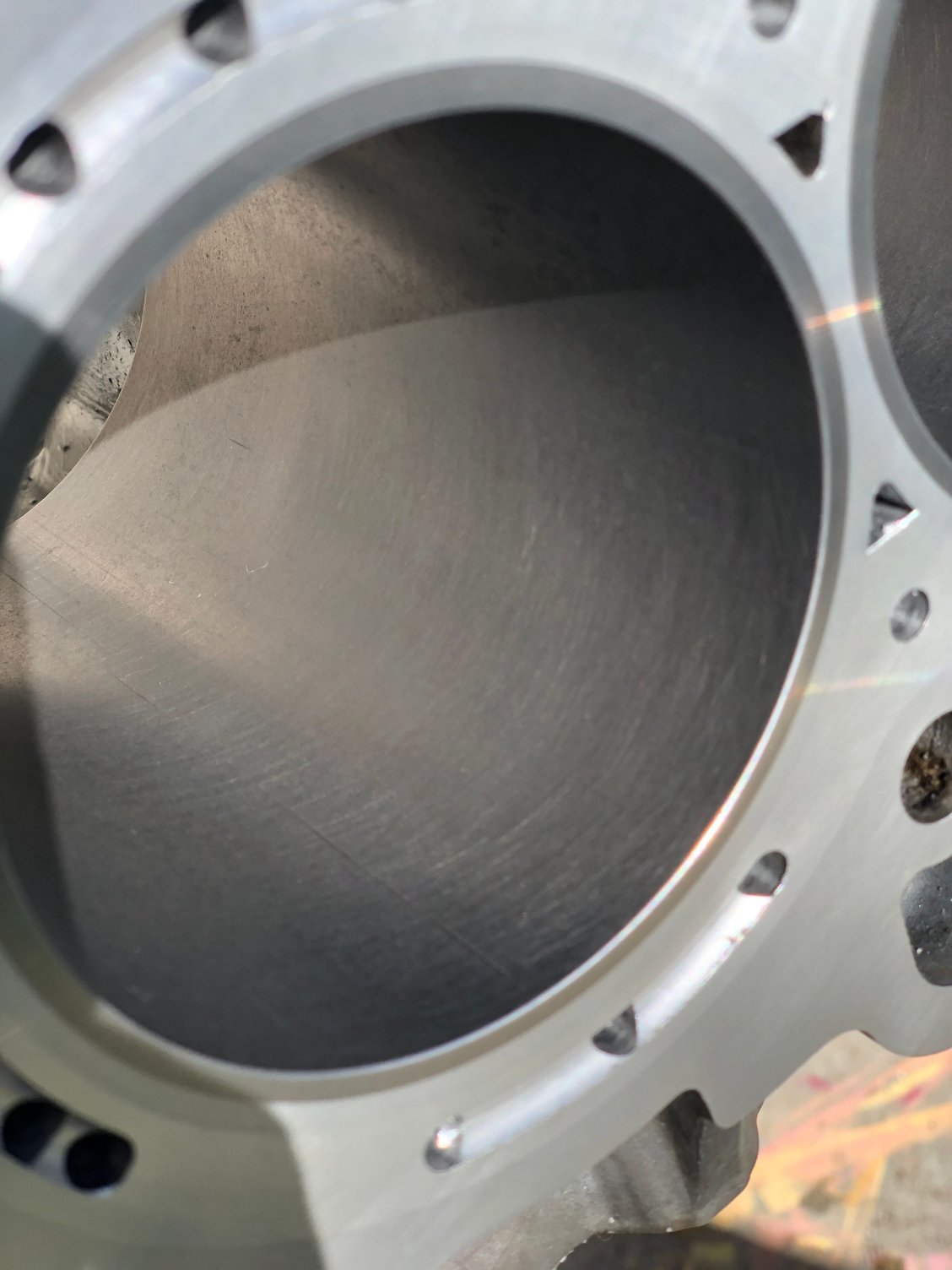

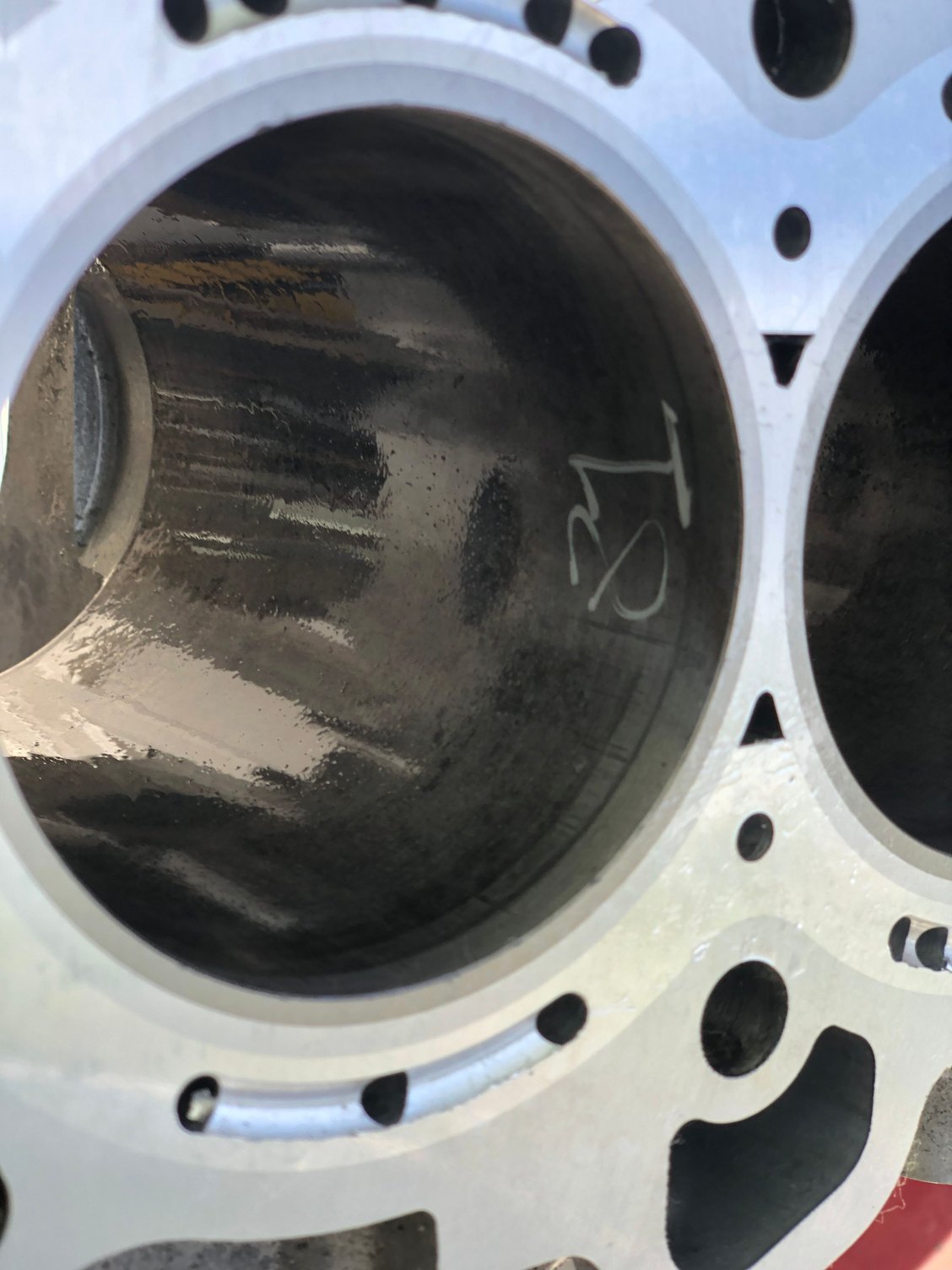

I used a ball honer for my gsr
Before
Before
After
After

my motor is running great right now. I used a 83mm 320grit ball hone for my chrome moly Carrillo rings.
