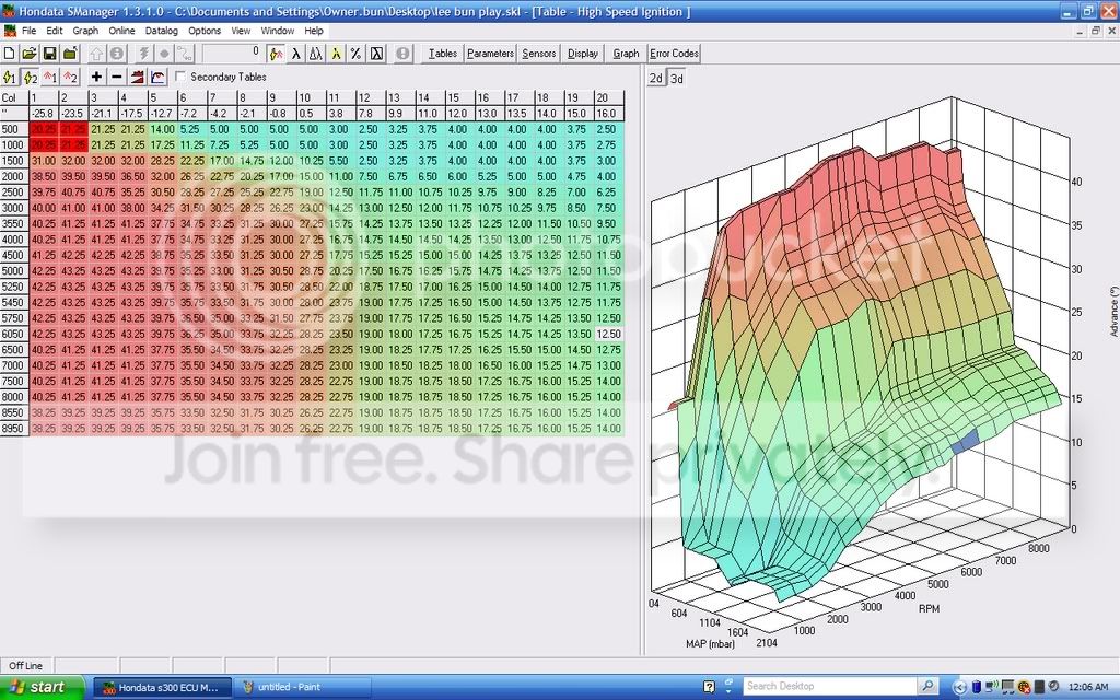

tuners please look
Old Dec 16, 2007 | 09:18 PM
laziebun's Avatar
Posts: 909
From: Central IL
Default tuners please look
how does this timing look
Old Dec 16, 2007 | 09:29 PM
SwappedTURBOegg's Avatar
Posts: 2,499
From: MI
weak
Old Dec 16, 2007 | 10:54 PM
PremierS372's Avatar
Posts: 444
From: Stockton,Ca.
Default Re: (SwappedTURBOegg)
Timing is pulled back a bit for my liking.
Old Dec 16, 2007 | 11:17 PM
Posts: 2,499
From: MI
like 10 degrees back for my liking... lol

Old Dec 17, 2007 | 01:30 AM
Chris Tune's Avatar
Posts: 1,066
<TABLE WIDTH="90%" CELLSPACING=0 CELLPADDING=0 ALIGN=CENTER><TR><TD>Quote, originally posted by SwappedTURBOegg &raquo;</TD></TR><TR><TD CLASS="quote">weak</TD></TR></TABLE>
thats a strong word for it... specially for 16 psi
Old Dec 17, 2007 | 05:21 AM
SpeedDreamz.com's Avatar
Posts: 5,250
From: Tuscaloosa, Al, usa
Default Re: (Chris Tune)
what fuel?
Old Dec 17, 2007 | 06:38 AM
rbergenholtz's Avatar
Joined: Dec 2007
Posts: 44
From: santa ana, ca, usa
turbo or all motor whats the setup?
Old Dec 17, 2007 | 06:44 AM
Turbo Ric's Avatar
Posts: 788
From: San Antonio, tx, usa
What C.R.
Old Dec 17, 2007 | 11:11 AM
laziebun's Avatar
Posts: 909
From: Central IL
set up..........
99 civic
98 sgr
AEBS sleeves
srp 9:5:1
eagel rods
arp head studs
780cc
hybrid t3/t04 57 trim
inline pro manifold
turbo smart 38mm WG
excedy stage 2 clutch
excedy fly wheel
thermal 3" back
i think thats it
Old Dec 17, 2007 | 11:19 AM
TheWickedOne's Avatar
Posts: 1,281
From: 41°39′10″N 72°23′29″W, Connecticut
Default Re: (laziebun)
Dude, Did you get it retuned yet ? Hope my 30 minutes of my time didn't go to waste..
