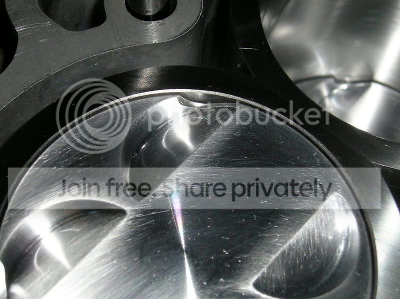

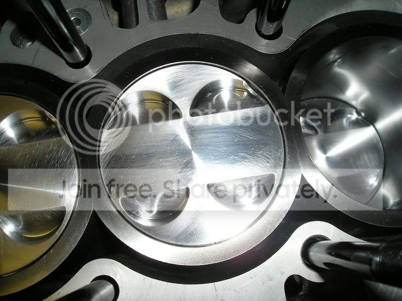

Cp's are pretty clean off the shelf.... at least mine were. I touched them up a bit just for added insurance though.
It's tough to see in the pics, but you get the idea. I went around all the corners and edges.

Chris, your motor is 81MM?!

Well it's under 83.0, correct?

My vote is 81.5
But, yes, vTAK for sure.

those sleeves looks monstrous.. Looks like a Benson (Darton) sleeve..

Correct. 81.5mm.
They are Benson sleeves as well.
All CP pistons 81.00 through 83.00 have the reliefs cut now.

83MM doesn't have them clipped out.
I think it's 82.5MM and down.
Old Jun 28, 2007 | 10:32 AM
tepid1's Avatar
Posts: 8,357
Likes: 5
From: CT
Default Re: Piston Prep Resources (HybridKOOP)
Nope.... 83's and down....
Trust me on this one. You must have an older version if you still have reliefs.

Incorrect. Never made an 83MM with trimmed reliefs. Only 82MM and smaller.

LOL. He figured out that they were a custom set thru CP.
Old Jun 28, 2007 | 11:58 AM
tepid1's Avatar
Posts: 8,357
Likes: 5
From: CT
Right. They were a modified shelf piston. I didn't relize that. Oops.

Who modified the reliefs of those 83mm pistons? Also I wonder why the do not make reliefs on the larger MM bores??
Maybe some of you engineers can lead me to an answer or give me answer.

CP modified them.
It's not necessary on the larger bores because there is plenty of meat on outter edge of the valve relief.

I took a forged piston that was damaged and went around with my tig welder and just started seeing how much heat it took to make things melt. The EASIEST place to get flow (melt) was right where the valve relief met the cylinder wall
