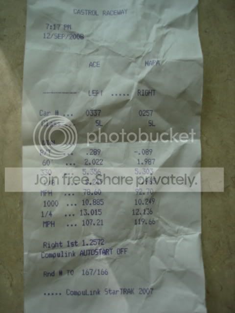

heres my best slip so far;

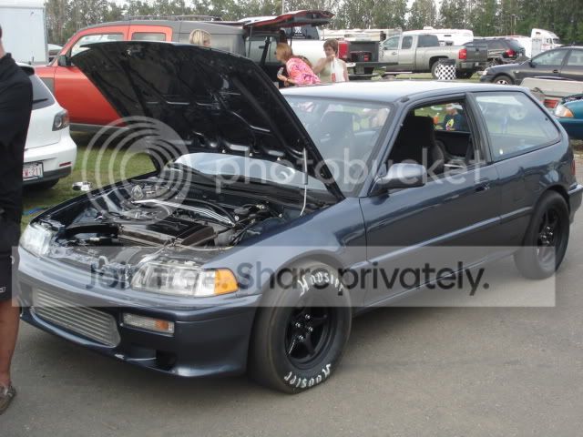

and a pic of the car
how do you guys setup up your launch? it was suggested to me to put the anti lag on a button instead of always on? i seem to bog then go, are my settings causing the initial stall?

There are several things that go into setting the launch up, but from what you are telling us, it seems to be bogging out of the whole. Try using more rpm and less antilag.

Also at 12lbs of boost your car would be running 11's with 23" tires - if you are going to turn up the power then keep the 24.5" tires though - a friend of mine lost .8 on his times bumping up to 24.5" tires on 10lbs of boost

There could be plenty of factors that is making the bog at launch. You might have to much fuel in your map for that amount of boost. Try taking some fuel away from the enrichment on the launch. You could be making the boost but not gerating enough power to get the car off the line.

Have you tried playing around with tire pressures? If you are bogging though, maybe launch a bit higher as see if that helps. It took me a few passes to get my 2-step set up along with my tire pressure. I launch at 7600 rpm and my tires at 5.5psi before the burnout.

Yeah, the activation rpm is too low. I usually have to set mine just below the launch rpm. You really don't need to leave with that much boost. Turn the antilag off and turn up the rpm

I'd try more rpm and less boost. and if that doesnt work I'd say its to lean when you launch.

I agree with these guys. I don't use the anti-lag and launch at 8000rpm. make sure you are keeping you foot to the floor and just riding the limiter til you feel the car stop accelerating in 1st. Once I took this advice I went from 1.8 60' to 1.63 60'. Driver mod is usually the best mod your car can get .

Your tires will be spinning in first, so letting it ride the rev limiter for a second lets the car speed up a bit more to catch up with the wheel speed.
If you don't do it, the car will try to bog when you shift into second

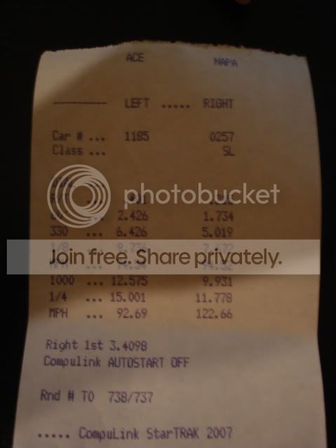

well got back to the track on fri and tried some of the things that were mentioned to me... heres the result
my first 11!!! of my race career it was a 11.9 @121 backed it up with this pass
so the changes i made was i canned the antilag, and set my launch rpm to 6500, that got me my first 1.7. the next pass i tried 6800rpm but i spun too hard as the track was pretty cold. i dropped it back down to 6500 and thats when i ran the 11.7. i ran the tires at 9psi.

lower the tire pressure and bump the launch rpm back up should help you get out harder and with the lower tire pressure should help spinning issues you were having at the higher rpms. 9 psi is definitely on the high end.

yah i will have to try that next time out. i was working my way down from 10.5psi to see what works best. next time out perhaps i'll try a 7k launch and 7-8psi.
