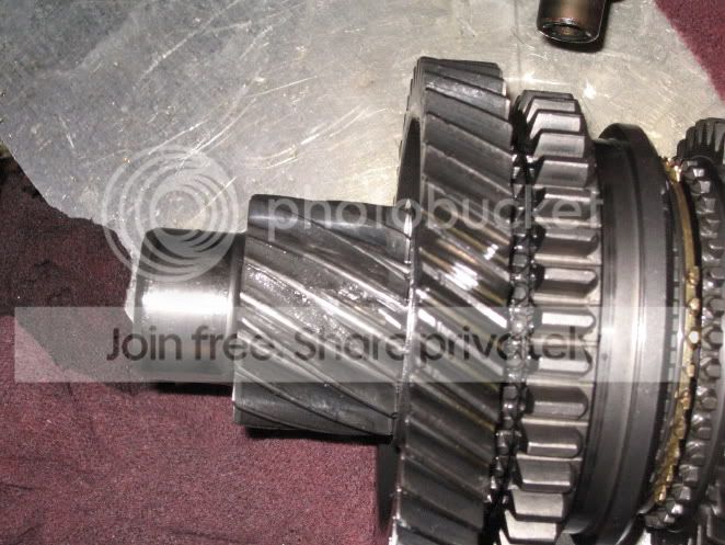

i have a gsr tranny stock.
at the moroso event when i left i heard a noise sounded funny.
took the tranny apart found that the countershaft gear that touches the quaif broke 2 teeth off so i need a new shaft. just wondering if thiers a better one to buy or is it worth treating the new one im going to get. got very lucky those 2 big teeth didnt hurt anything not even the quaif gear.

Old Aug 27, 2006 | 05:27 PM
ALL IMPORT's Avatar
Posts: 2,337
From: PBIR once called MOROSO
Default Re: broke countershaft! (ALL IMPORT)
figure ill post a pic.
would of thaught something else would of broke besides this big *** gear. but its better than a whole tranny going down.
you were running street tires right? could be part of the problem. lots of wheel hop
Old Aug 27, 2006 | 06:21 PM
ALL IMPORT's Avatar
Posts: 2,337
Default Re: broke countershaft! (cubish)
yep

i broke all but 4 teeth off of mine. it was weird but it still got me home and didnt tear up any of the tranny parts. i replaced the fd as well. It had a little whine too it when i got the tranny but the unsprung 6 puck prob didnt help. yea expletive wheel hop
