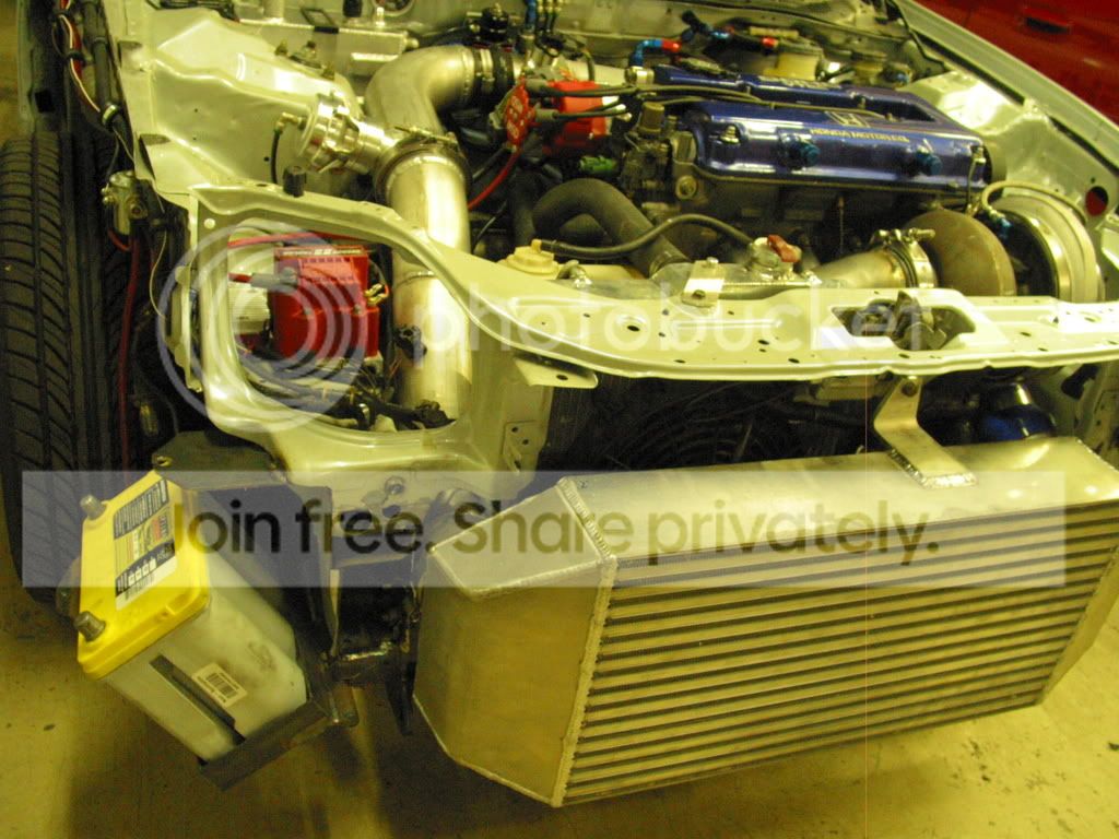

We used a piano hinge to let ours swing out for easy removal and installation.

^^^Nice, I might have to do that one day!

Niiiiice!

now thats what im talking about...make a battery relocation kit. ill preorder one right now exactly what im looking for

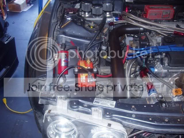

This is what I did when I got the T1 can.

This is what I came up with. Only thing is that the bracket is pretty heavy.
