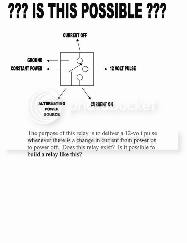

I'm still trying to figure out what this thing does, you want a 12VAC signal to be sent out when you turn on the power to your car? I'm not sure what you mean by alternating power source and 12V pulse? Why would you want this relay anyway?

I want it to deliver a 12 volt pulse whenever there is a change in current.

<TABLE WIDTH="90%" CELLSPACING=0 CELLPADDING=0 ALIGN=CENTER><TR><TD>Quote, originally posted by crj_lll &raquo;</TD></TR><TR><TD CLASS="quote">I want it to deliver a 12 volt pulse whenever there is a change in current. </TD></TR></TABLE>
A standard relay will not deliver a "pulse". It's either off or on.
Look into a pulse-timer relay. It might do what you're looking for it to do...

<TABLE WIDTH="90%" CELLSPACING=0 CELLPADDING=0 ALIGN=CENTER><TR><TD>Quote, originally posted by B18C_EJ8 &raquo;</TD></TR><TR><TD CLASS="quote">
Look into a pulse-timer relay. It might do what you're looking for it to do...</TD></TR></TABLE>
Can a pulse timer relay be set to activate by a change in state? This way it would activate when the car is turn on and when the car is turn off.

^^^ But he wants the relay to deliver a 12v pulse when the ignition is turned on AND an pulse when it's turned off .....

Im not sure if there is just a relay out there, but im sure you could design a solid state circuit to do the job. You could get everything you needed at radio shack for not too much..But you have to know how to design a circuit. we did something like this in high schoool comp sci class, but i cant remember exactly how

<TABLE WIDTH="90%" CELLSPACING=0 CELLPADDING=0 ALIGN=CENTER><TR><TD>Quote, originally posted by suspendedHatch &raquo;</TD></TR><TR><TD CLASS="quote">Just use a relay controlled by ignition.</TD></TR></TABLE>
That is exactly what I have decided to do. I got this diagram from another discussion board I belong to. http://www.the12volt.com

okay it looks like a nand gate controlling a spdt relay..
the nand gate is controlled by the ignition and a cap/resistor setup which would send another 1 to the nand gate...at a rate that is controlled by how big the cap is...
which intern's cuts makes the nand gate return a 0
this controls a MOSFET ... which is used to power and ground the SPDT relay...
thus creating a on pulse to the SPDT relay.
when the nand gate returns a 0 the mosfet has no power, and kills the relay - returning the relay to its normal state...
allowing the relay to switch on then off.. with a DELAY controlled by the cap...

looks like you are trying to turn something on.. right before u start and after u turn off the car. but only for a brief moment. - at least based on the diagram from the12volt..
the only thing that comes to my mind... that could even be sorta useful, is for the circuit to control the interior dome/map lights.
when you start the car the lights will stay on for x seconds and then when u turn off the car the lights will stay on for x seconds... but this is way to complex to accomplish such a task...
seriously, what are you trying to accomplish with this circuit? if you say what you are trying to control, we might be able to tell you an easier way to do it - other than just give u a diagram to follow with a brief explanation.
but with your first post.. sounds like u just want a brief pulse when u turn on and shut off the car... like an auto lock/unlock door thing...
they have diagrams on how to do that at the12volt - with simple relays instead of using ICs...
you could just wire in an alarm system that adds these features to your car if your car doesn't do it already...

I didn't know XOR gates where now called nand gates.
An Xor gate works this way
1 2 3
0 0 0
0 1 1
1 0 1
1 1 0
You see that the only time the output is a one is when you have an opposite charge on each terminal.
Now you see that terminal 1 is always tied to a 1 so now we have a time delay on terminal 2. When terminal 1 is a high terminal 2 will be charging by the rc time delay. Once terminal 2 is fully charged the output will shut off.
When the ignition is shut of the opposite will occur. The only modification i might add is to put a 1 meg resistor from terminal 1 to ground. That way this terminal is not floating which is a no-no with digital logic.

okay.. i made a mistake.. switched the symbols in my head nand/xor - haven't touched that stuff for 2 years - but really.. why use such a complicated diagram.. when u can just use 2 relays, 2 1k uf caps, and 2 10k ohm resistors?
the circuit using the the IC xor gate, isn't as easy to make, since he will have to use a breadboard, and a project box to house the circuit, then stash that somewhere...
if you use the relays, caps and resistors, all the tiny stuff (Caps/resistor) is covered in heat shrink to protect it... there isn't the question of a small project box to stash.... since the caps and resistors are wired inline to the wires that go straight to the relay.
not only that, but can an ic take 11-14vdc??? i remember in my intro to circuit design class, that most of the ics we used were 5vdc... if he only wanted help on the circuit, he should've just ask the guy who drew it, instead of coming here to h-t asking us. If you ask here, I assume that it is car related, and he wants it to control something in his car, so what is he controlling??? i have no idea......so how can i help?
