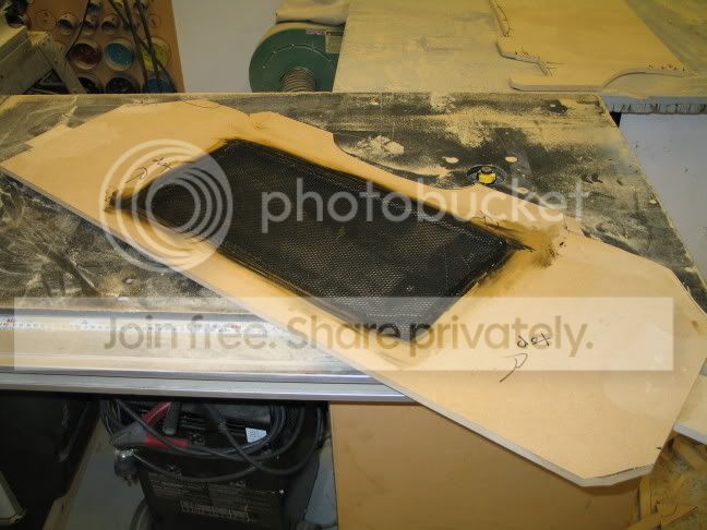

My old setup
I don't recommend boston amps for speakers though

Default Re: Amp Mounting --Where?/ (redzag11)
<TABLE WIDTH="90%" CELLSPACING=0 CELLPADDING=0 ALIGN=CENTER><TR><TD>Quote, originally posted by redzag11 &raquo;</TD></TR><TR><TD CLASS="quote">Very nice. Are these pics from an 06-07 Si? </TD></TR></TABLE>
Nope, a 94 sol. I was just giving you an idea of what can be done in the spare well
<TABLE WIDTH="90%" CELLSPACING=0 CELLPADDING=0 ALIGN=CENTER><TR><TD>Quote, originally posted by redzag11 &raquo;</TD></TR><TR><TD CLASS="quote"> Was all that stuff built into the spare well? I can't quite tell from the angle.
Yes, fiberglassed and screwed in. When I actually removed it it took me 30mins
The false floor was actually more sturdy than the stock floor too

Hey misanthropist, that is a clean install! Where'd you get that screen thingy that covers the sub and lets the air through, and what is it called? You can't even tell it's not stock carpeting from the top...very nice.

Not all, I lost about 3 inches
The screen thing is just black mesh grill. Personally I don't have triple A, I've pretty much said expletive it. I leave my lug nut key at home anyways
