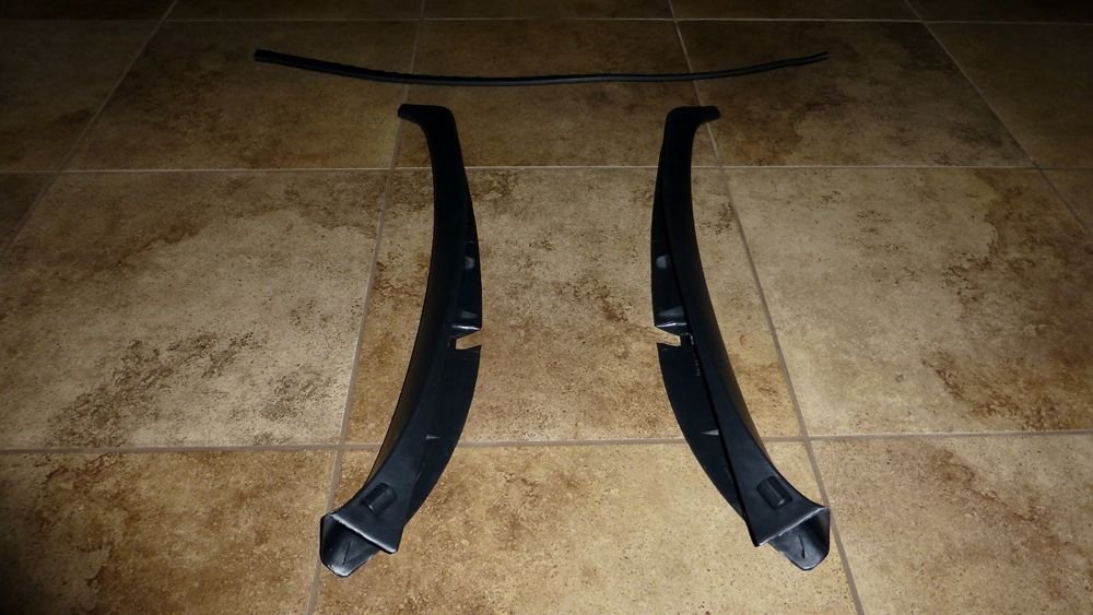

- New OEM Molding Rails

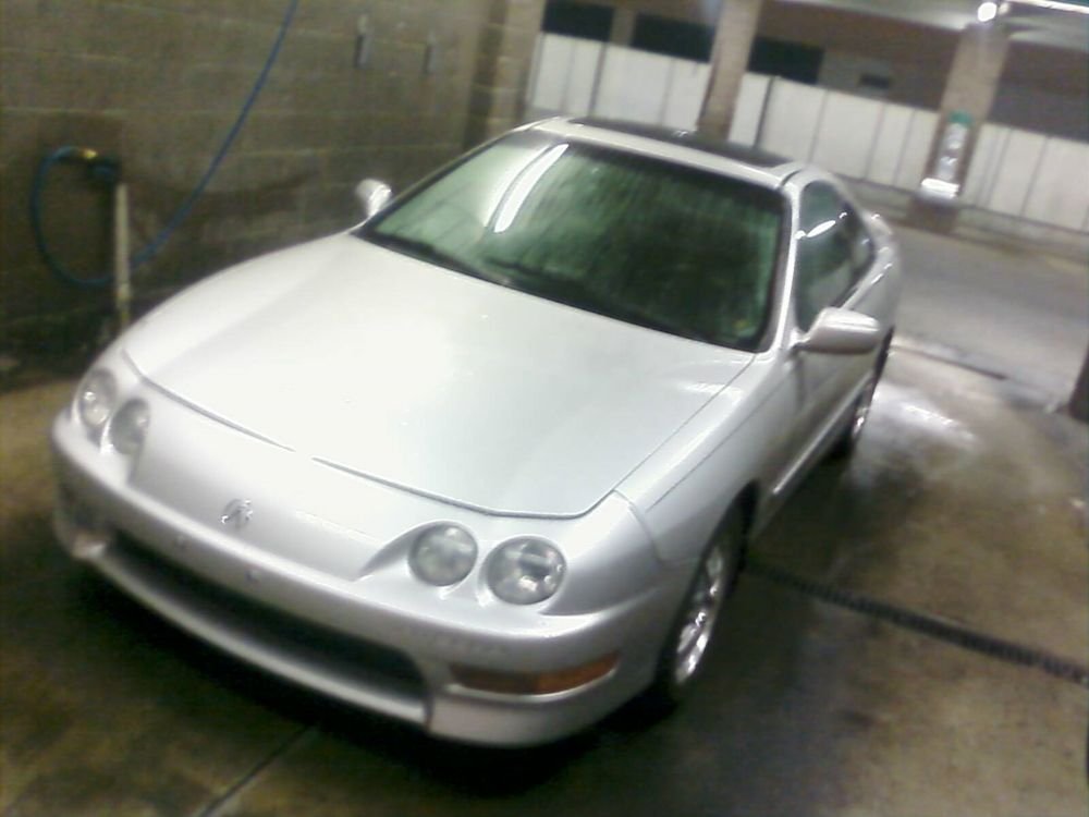

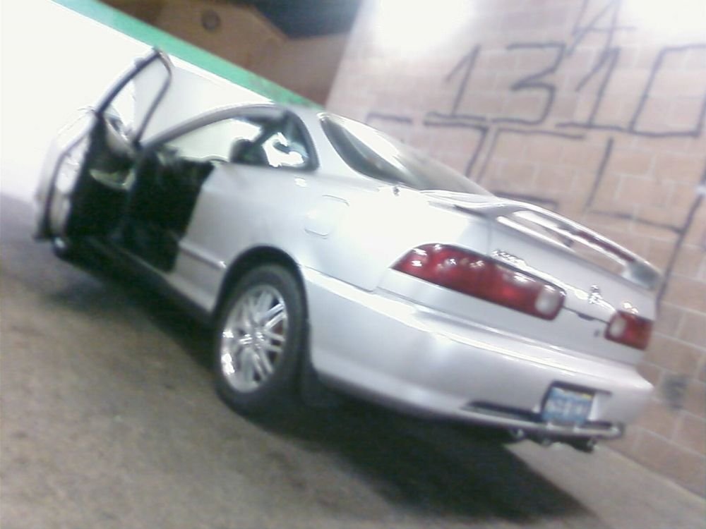

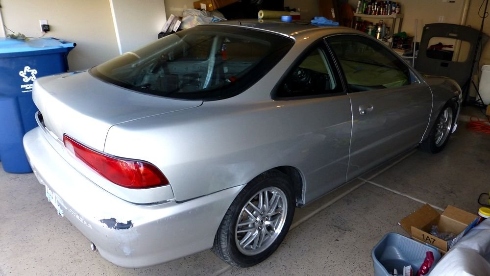

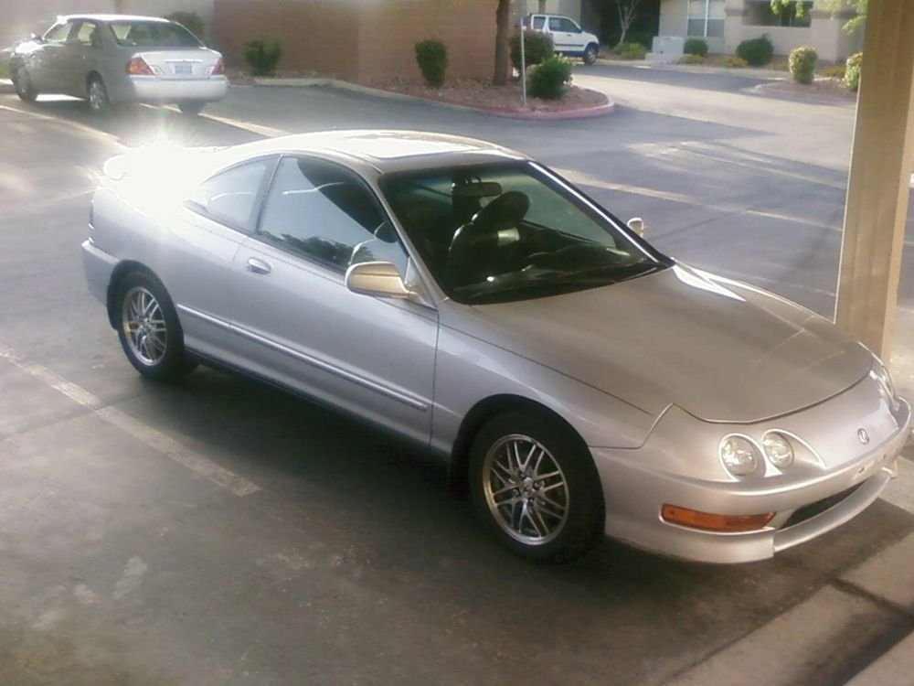

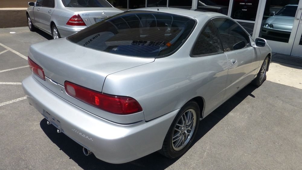

Here's a couple pictures that I could find when he first purchased the car. Sorry for the blurry pictures

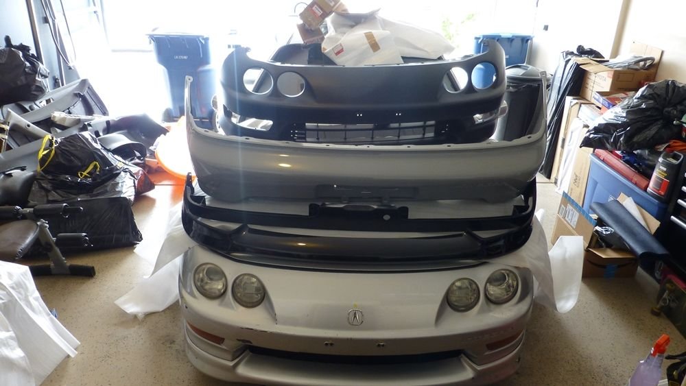

Before we brought it to the body shop we purchased a couple of parts:
- New OEM Front Bumper
- New OEM Rear Bumper
- New OEM Rear Support
- New OEM Front ITR Lip
- New OEM Front Windshield Trims and Clips
- New OEM Rear Wiper Nozzle
- New Aftermarket Front Windshield

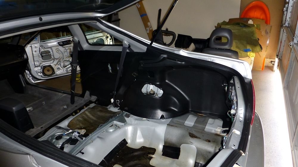

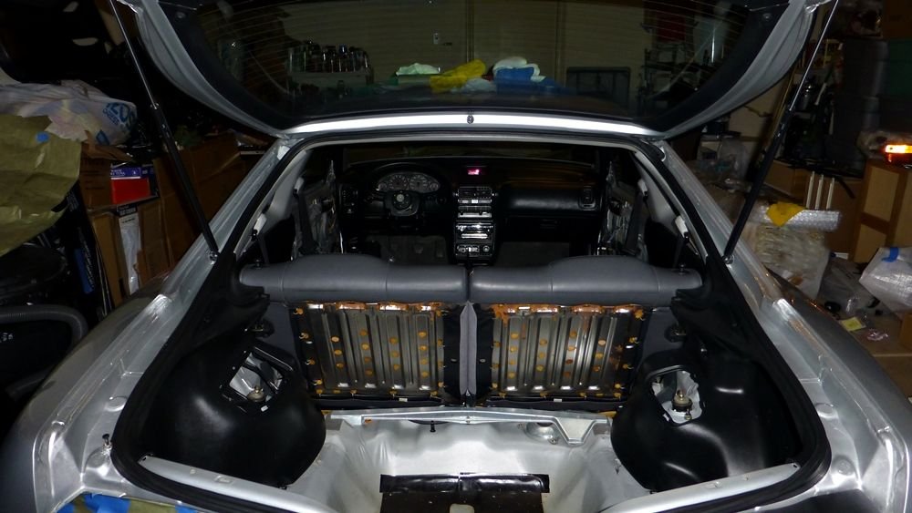

Started to work on the car. We decided to work on the interior first starting with the 2 doors.
What we used. Your going to also need a heat gun or a blow drier.
This is the 2 doors before we remove and cleaned the old butyl tape. That's the brown stuff that you see on the door. Very Sticky! This process was time consuming but well
worth it.
After
Then we cleaned the rest of the interior.
What we used. Not pictured but we also used a clean brush for the tight space's.
How it looks after

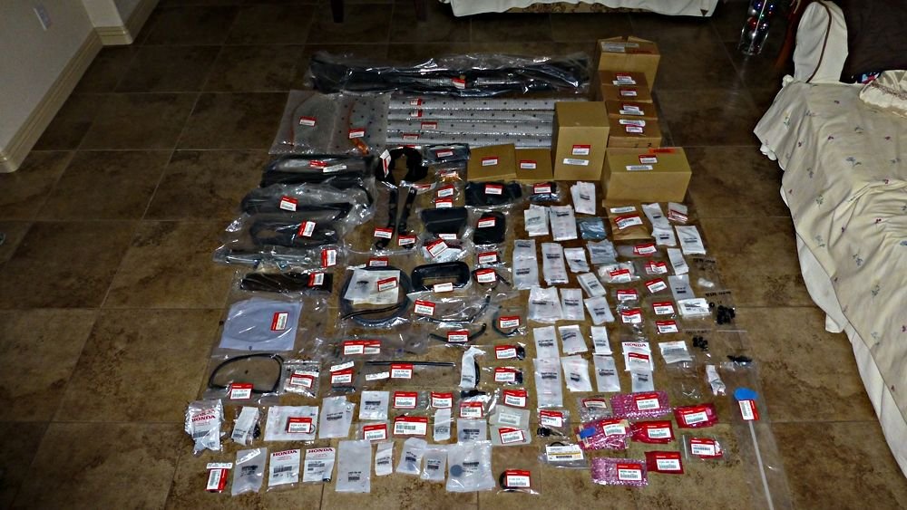

Sorry we haven't work on the car that much. We did get the car back from the shop but unfortunately we brought it back again. But in the meantime, some parts that we had laying around. I'll keep you guys posted and more work to be done on the car once we get it back. P.S. this took a while to setup, hahahah. Makes a better picture for sure

Old Jun 30, 2017 | 07:10 AM
danteisme's Avatar
Loved
Community Favorite
Posts: 3,254
Likes: 48
From: South Western PA
Default Re: Ryan's 98 Acura Integra
so many honda bags!!
Old Jul 1, 2017 | 05:48 AM
LMdAkId's Avatar
Joined: Aug 2008
Posts: 63
From: USA
Didn't seem a lot in person but looking back at the picture, definitely a bunch of honda bags

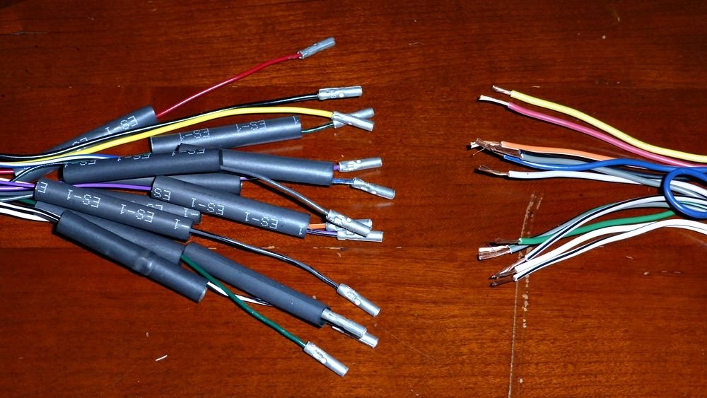

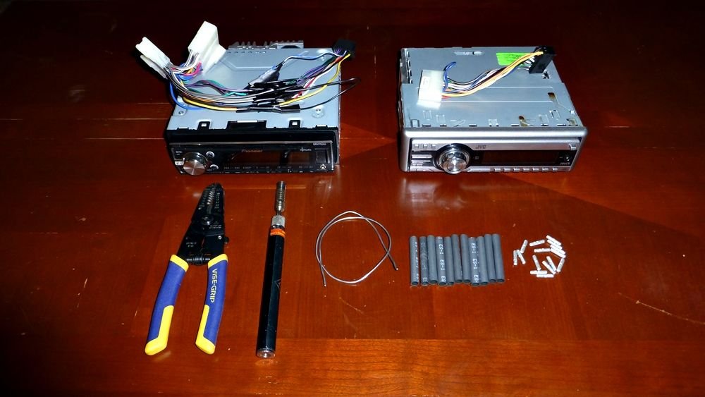

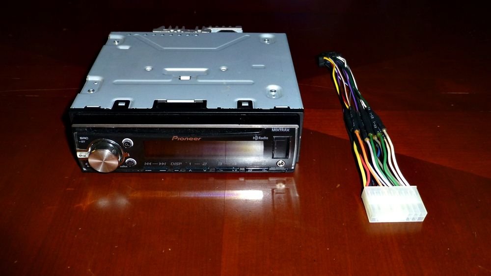

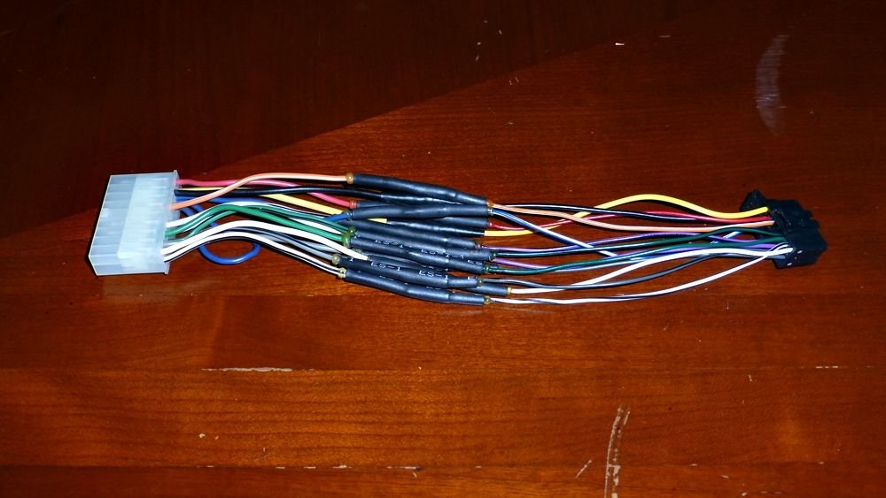

A little update. I did a little wiring. Wired up my toyota harness to the acura. Still waiting on the car and parts to arrive. Stay tune.
Splice
Butt connect one end of the harness
Slip the heat shrink in
Butt connected the 2 harness together
Heat shrink the tube. This part was SATISFYING!
How it looks after

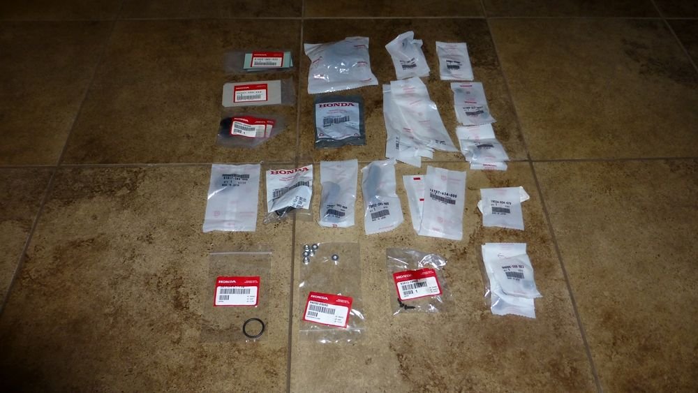

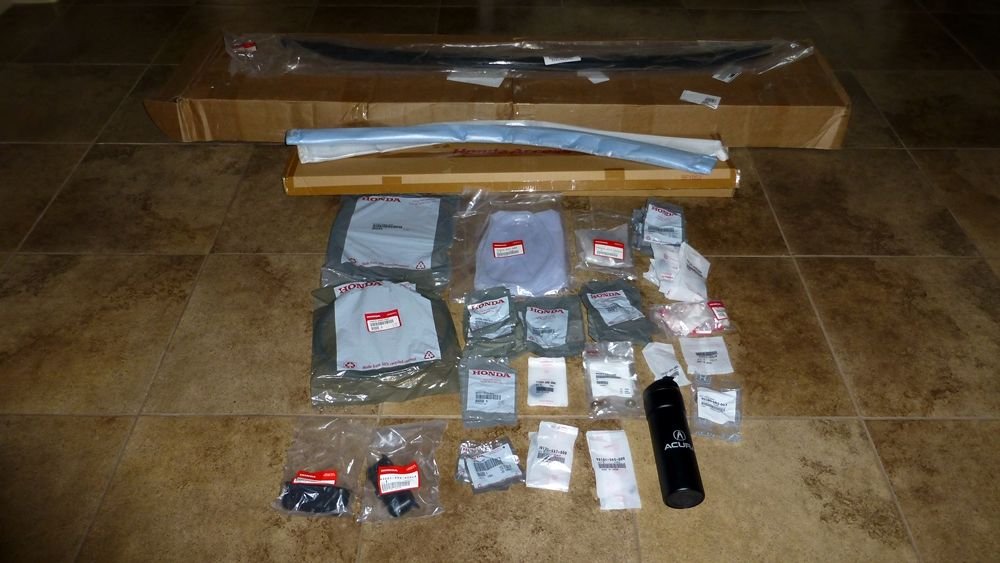

Batch 2 package. This arrived about a month ago. Acura Delray hooked us up with the parts and a free Acura Bottle

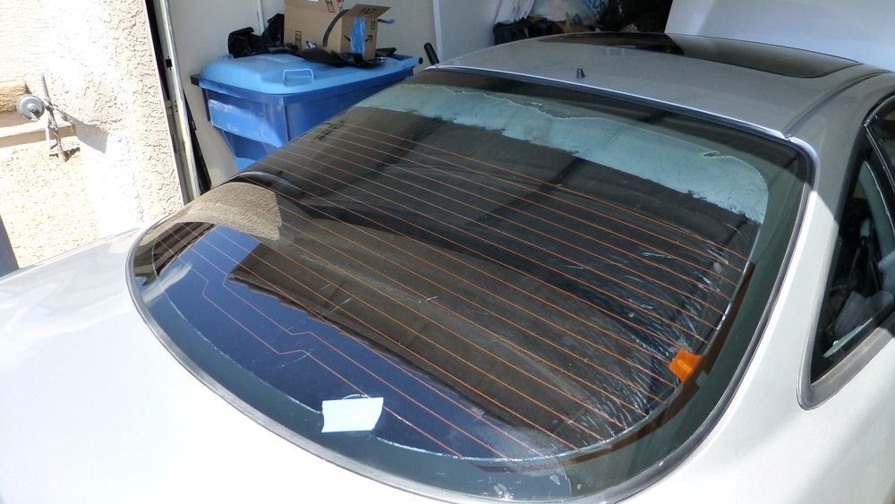

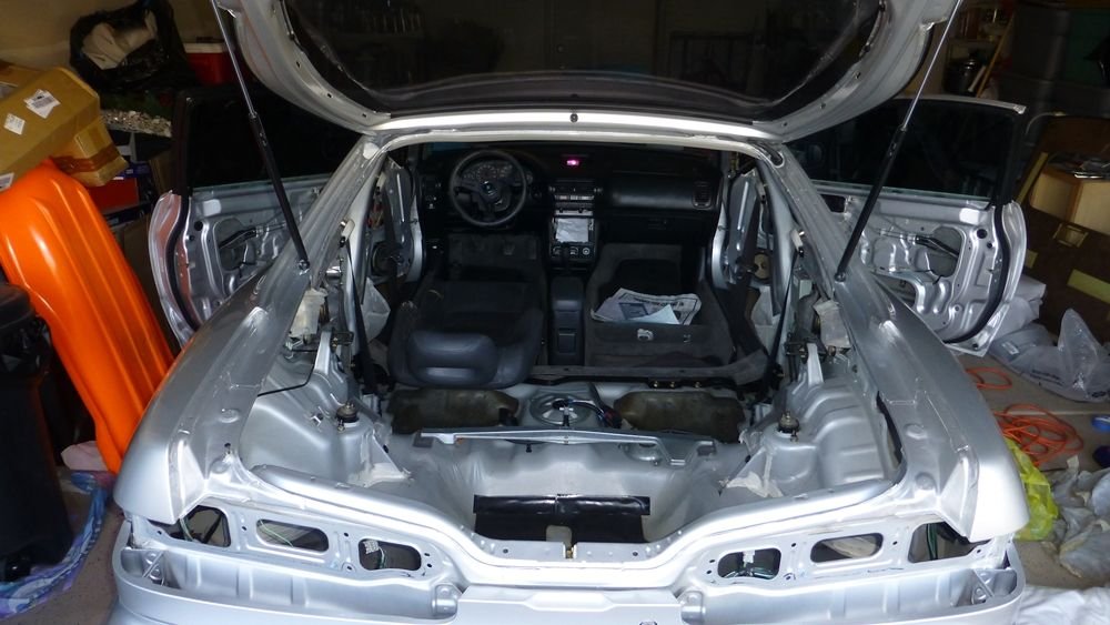

Working on removing the tint. Quarter and front windows was a straight forward approach ( ammonia cleaner, blade and heat gun ). On the other hand the hatch is a different
story. Not hard but it takes a little bit more time to remove especially if you don't wanna damage the defroster. If you don't care about the defrosters than a razor blade will be your best friend lol
For the removal of the hatch tint you'll need a garbage bag, any cleaner with ammonia, squeegee ( we used business cards. You could use your old credit card ), blades, and
some type of heat. We use the sun for the rear hatch. If you live in colder climates then you need to get some type of heating device like a heat gun ( what we use for the front and quarter windows ). I'm pretty sure you guys know what to do with the tools I mentioned ^^.

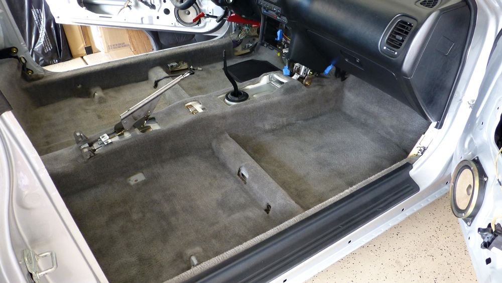

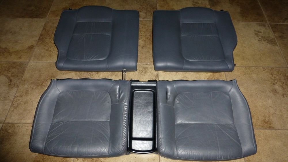

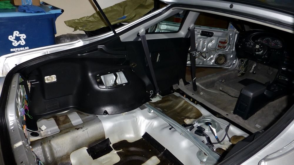

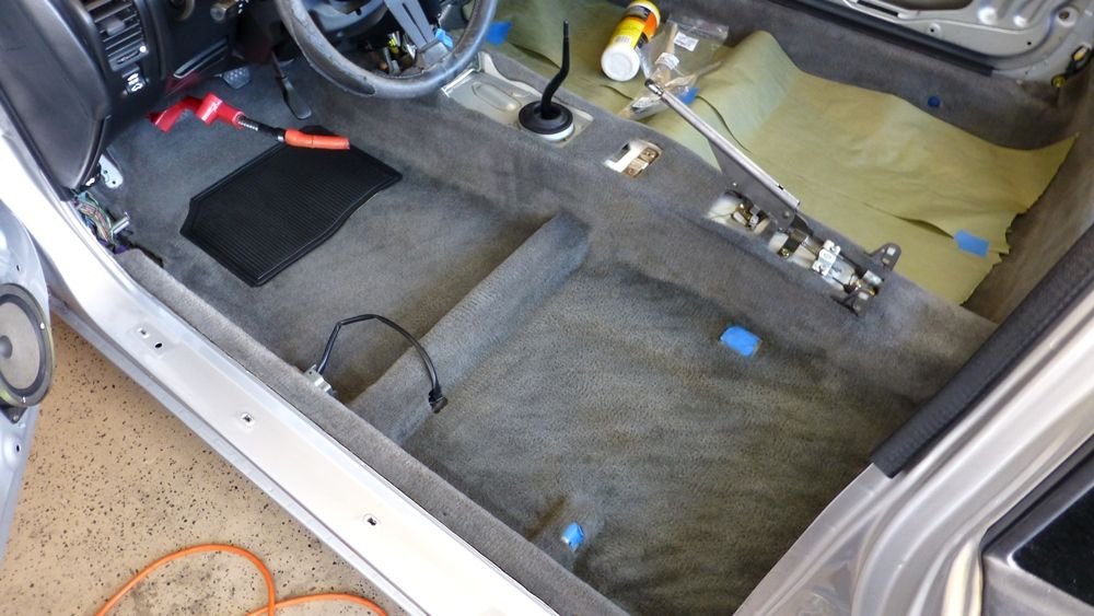

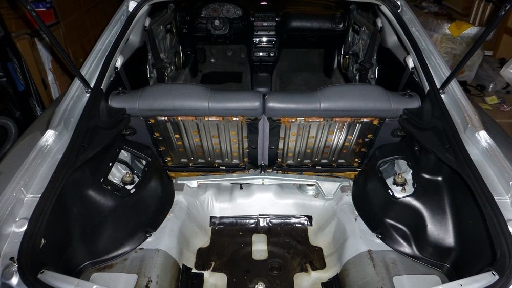

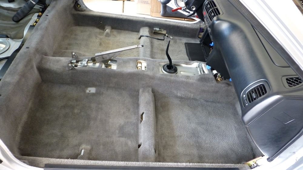

Onto the carpet. We hated this process because it took so much time to get where we wanted it to be, aka CLEAN!
Dirty carpets
After 79.57hrs . We're just happy that we got it done. Looks way better than that ^^. I would sleep on it for sure. Maybe with your girl too

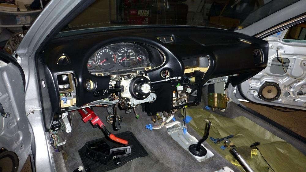

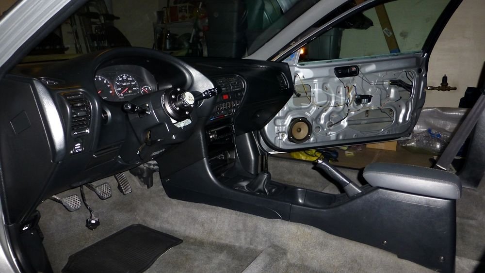

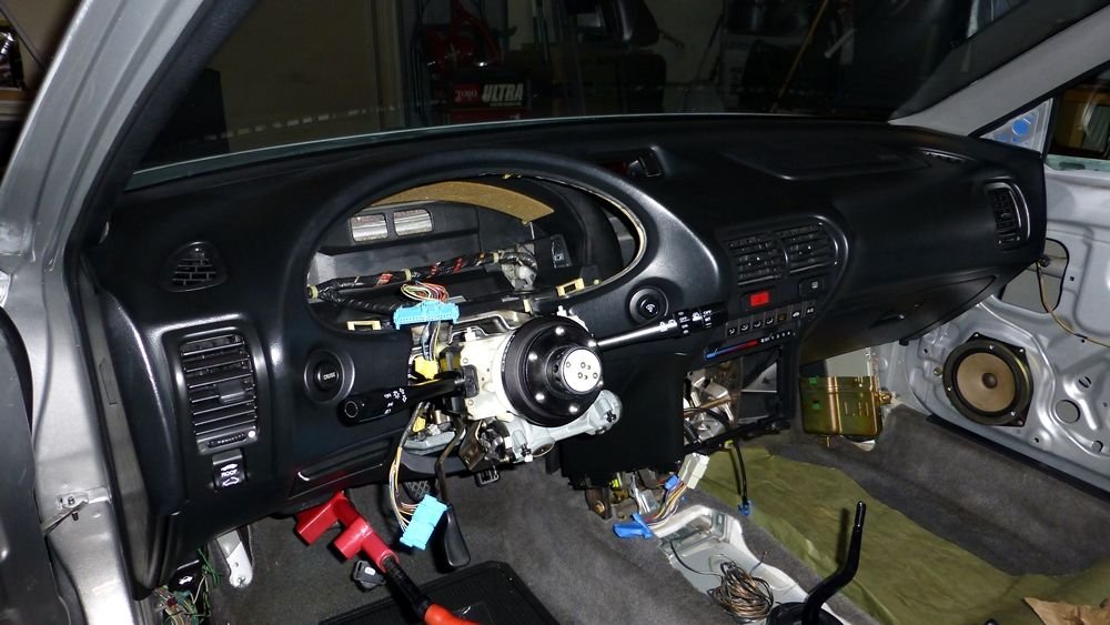

Panels, Trims, Dashboard, Console, Misc. All black interior pieces Painted or Application of Black Trim
I took this picture because "LA" is my initials and I did not put it there. I ask my bro and he said he never seen it. If you look at the "LA" initial, it looks like they used a stencil.
Trippy! BTW that's the flip side of the console

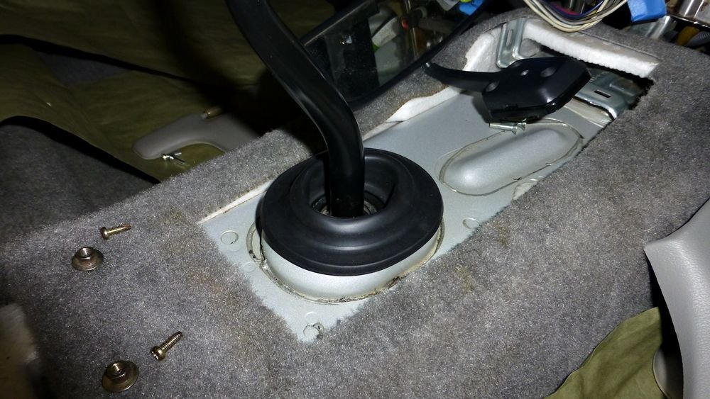

Installed NEW OEM SHIFT BOOT. The old one was brittle and looked old
Cup holder mechanism. I find it really interesting

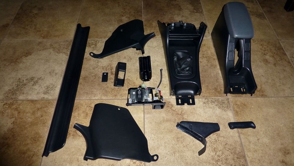

Center Console, Kick Panel, and Misc
Notice the clutch lock. To lazy to grab the key. We've all been there. Random pictures of the progress
Panels, Switches, Clock, Glove Box
AC Control Unit, Vents, Button Switches. BTW this part was a pain in the *** to remove. At least for me it was
Thanks Mike and James. Didn't ask them to buy me this shake but they got me one anyways. Real homies
Waiting to put back on the car. These panels either got Painted or Black Trim was applied
Got the Speed/Tach Meter out. Needs bulb replacement and cleaning
Vents, Clock, Switches, A/C Control Unit, Glove Box, Panels, and MISC Installed. Didn't have the Speed/Tach Meter installed yet. Was working on it at that time

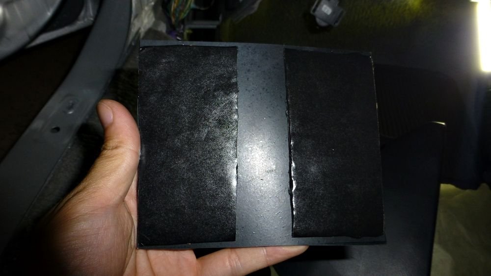

This hole was from the clutch lock. Patch it up with this black rubber mat and double sided tape to hold in place

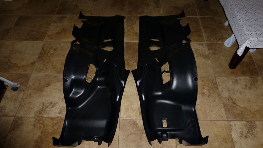

Installed New Pair of OEM Rear Speakers. The old ones were blown. It use to have subs but we took that out
Quarter Panels
The Gray Quarter Window Panels and Headliner was cleaned with a brush and light mixture of dish soap and water. 15-20% soap and rest is water

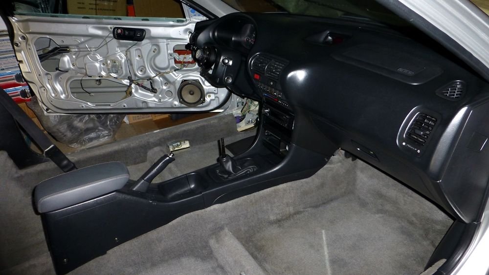

Putting the rest of the panels back in. This is where things are coming along. At least the interior side of things
The Door Panels are not installed atm because we're waiting on some parts for the door lock to arrive
