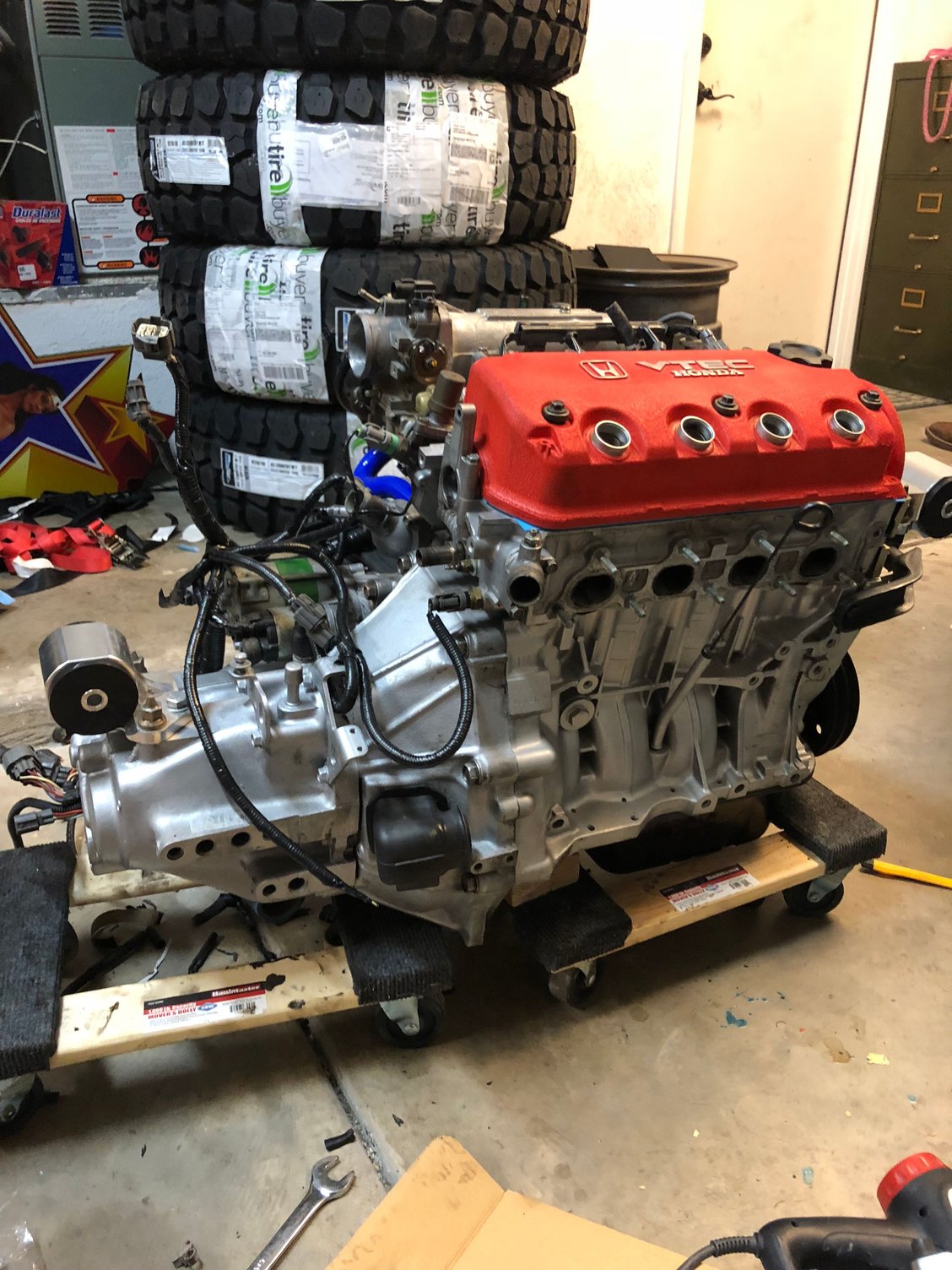

Mated up. Still Cleaning up the harness, going to re loom what I can and black tape the whole thing. Rinsed off injectors and sprayed some cleaner in them.
Hiccups-
Turns out my dizzy won’t work. Need a z6. Input? Will it work if I get 2 holes lined up? I doubt it...
Starter bolts had some junk all over, looked like “quick steel” from the old block
Need exhaust mani gasket

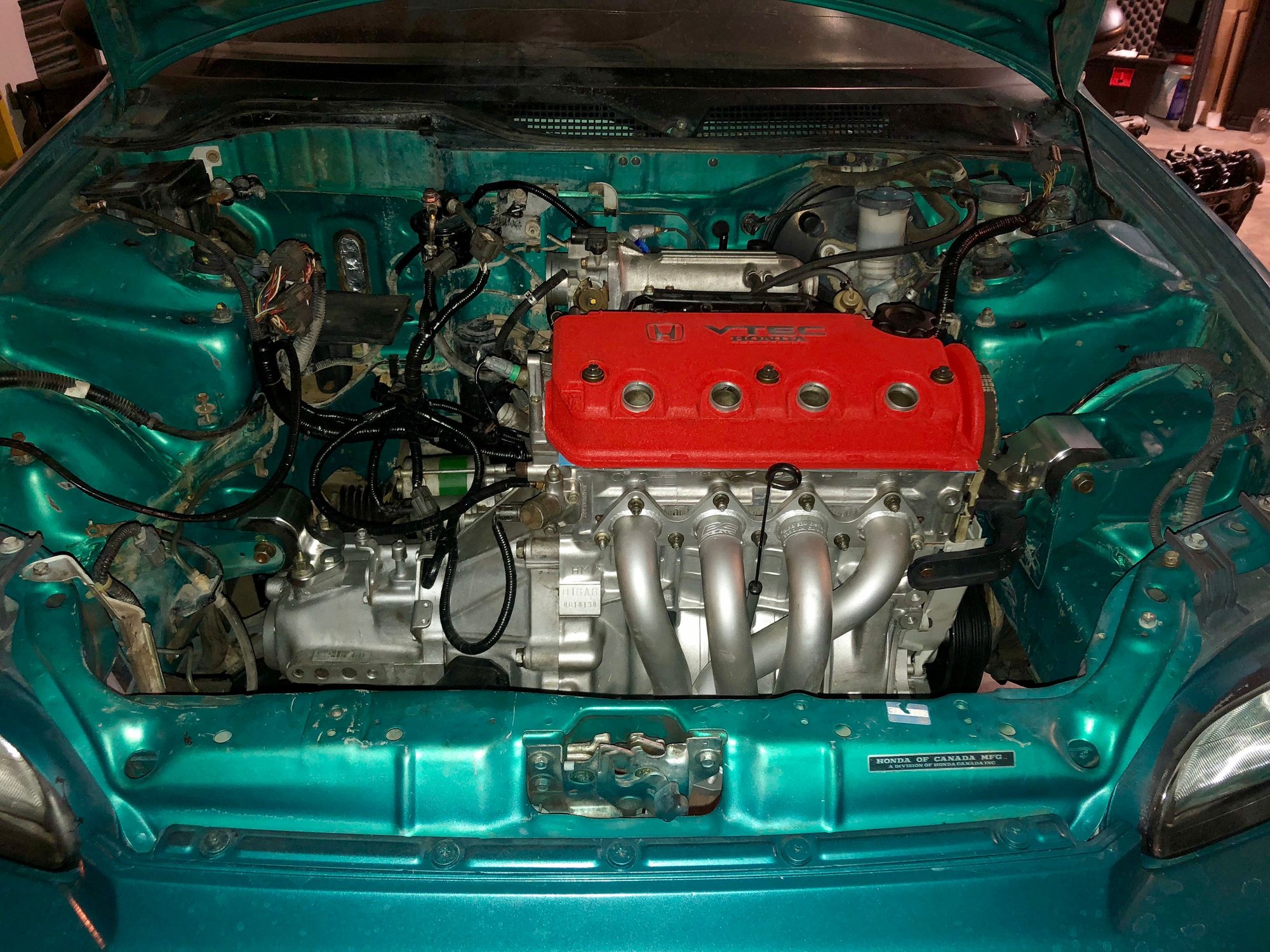

I know it’s (still) a nest. My goal wasn’t a “tuck”. But it’s been CLEANED reloomed taped and reinstalled. I added a little extra close to connectors knowing they’re getting brittle.

Got it in!!! Took a late nights work, but it’s installed. Still more to do... and parts to buy $$$
Can’t wait to get the remaining pieces and clean up the garage

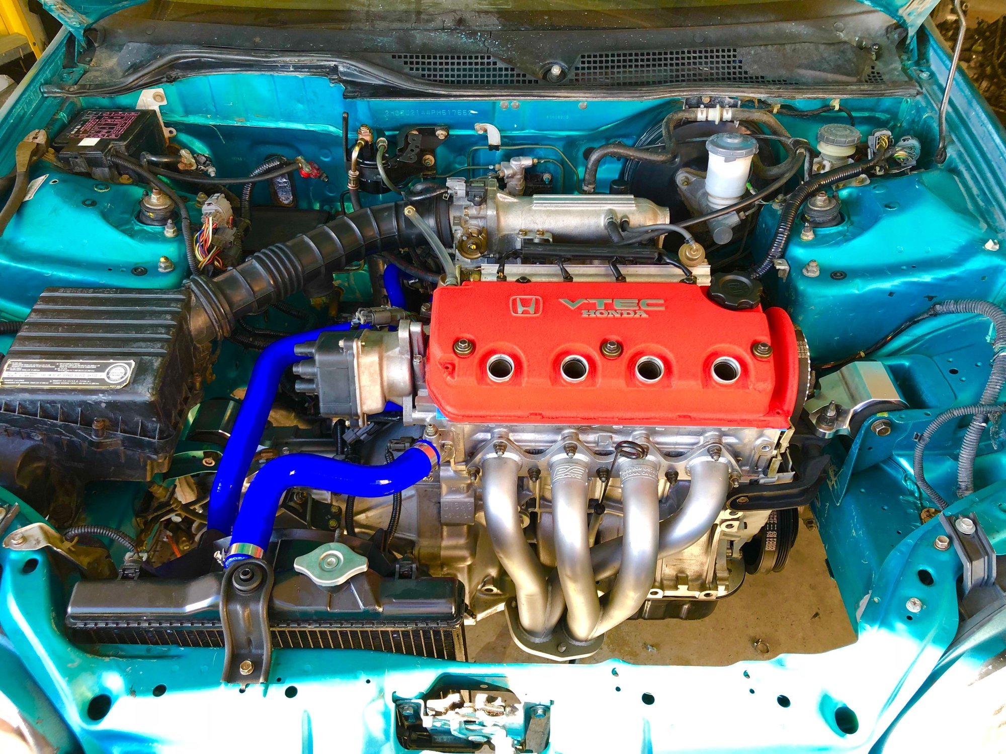

Getting closer!
-harness completely ran
-painted a few things with black wrinkle paint (battery tray, fuel filter holder, radiator stay)
-zip tied a few wires in their secure locations
-buttoned up all the vacuum lines, hoses, fuel and air intake)
-water lines and radiator (had a small leak in thermostat housing,fixed)
-filled coolant with a 50/50 mix for the break in and summer (may add water wetter)
-gapped and installed spark plugs (with anti sieze)
-fuel filter, new copper crush washers
-valve cover breather hose was a 2 hard line deal on the original engine, so I used some brass fittings and clear line I had extra from my Jeep onboard air kit
-degreased and washed a few things
