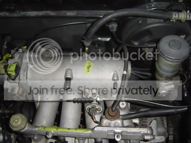

whats so hard about the vacc lines one goes to the MAP sensor, one two the purge cut off solenoid. do you guys have those damn dash pots? they go to the intake piping or get rid of them.

you knwo those solenoid looking things oin the fire wall i want to get ride of it
but i need to knwo the vacuum lines with out it and harmonator says he doesnt have it

sry didnt see the picture lol
i need a close up look of liek behind the IM and a shot of from the top you knwo what i mean
edit: so i can see the vaccum lines lol!~

Ok, well you can get rid of the charcoal canister it the big black thing in the pic.
I have a newer style TB but if you look where my map sensor sits you should have a tube there. That tube is the one that needs to go to the map sensor on your firewall.
On the bracket for the map sensor is also a purge cut off solenoid. I just left mine plugged in and put it in the cab. I have no idea what it does. Any other tubes coming off the manifold just get blocked off except the one that goes to the fuel pressure regulator.

Thanks...no I dont have to go back down to the garage and take some pics..haha
Mine looks just like his..I will still take some pics for you though.

its still al ittle hard to see what your pointing too but i will try and compare tomorrow when i go downstairs to work on my car!

Here you go...Well here is a quick pic. As for all I can tell there is only 1 vacuum line hooked up and thats the one you see in the pic there. The rest is blocked off.
