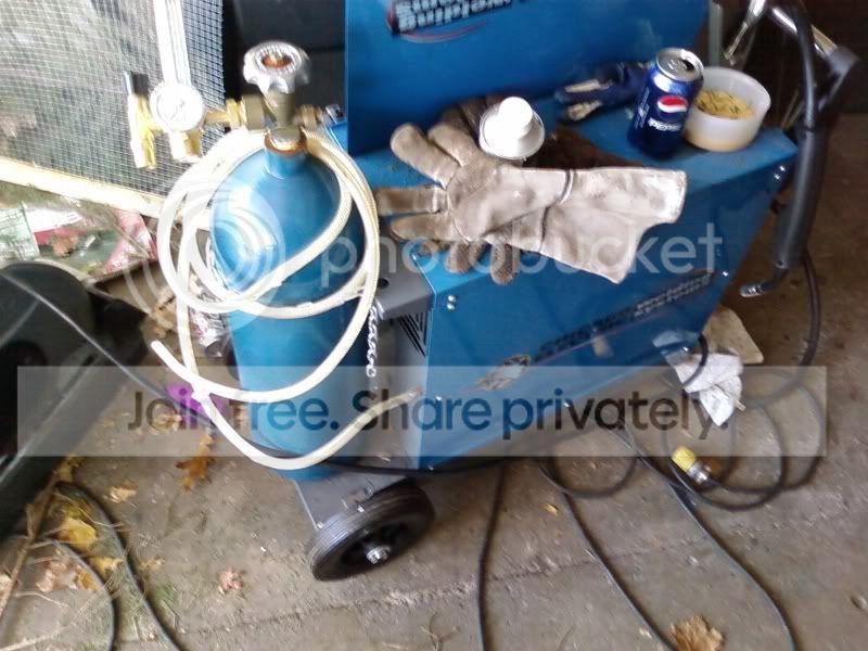

WE'RE COOKING WITH GAS NOW!!!!!!!!
that was a quick bead, with me messin around with my settings bc the wire was to tight and wouldnt come out right, thats why my welder wasnt working so well...
all i need is one little fitting and them im on gas

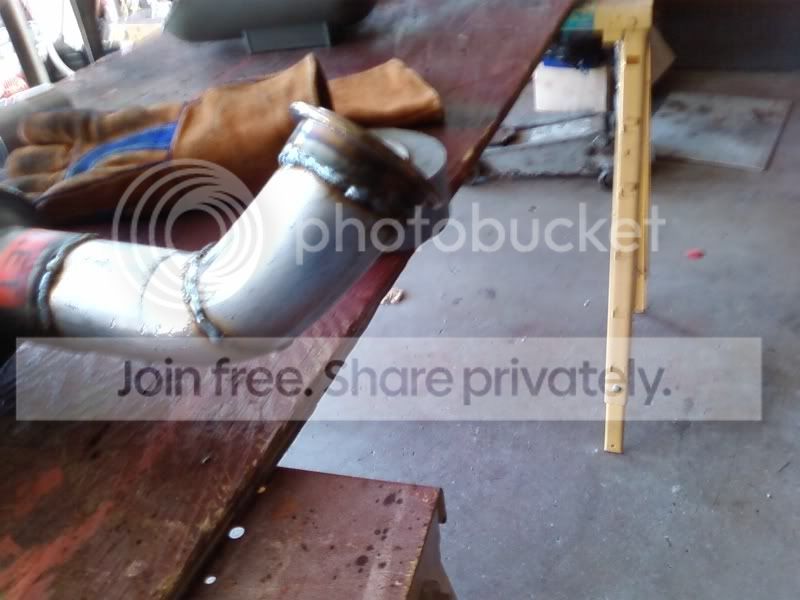

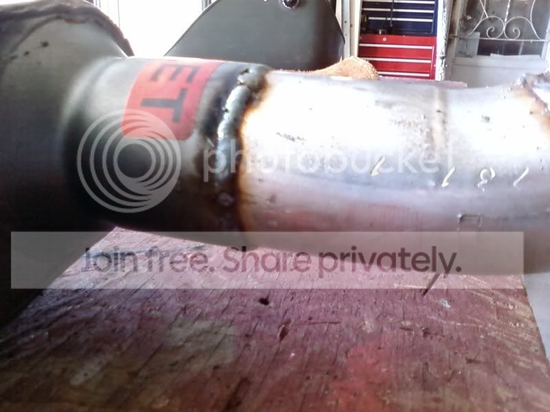

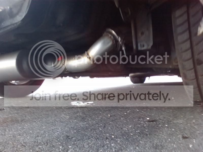

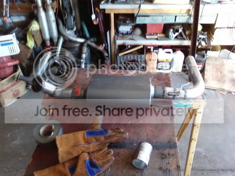

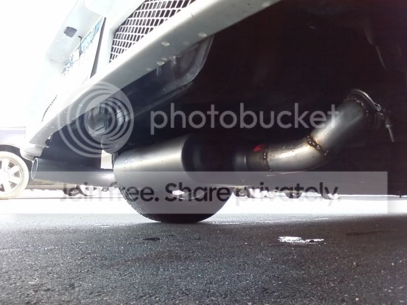

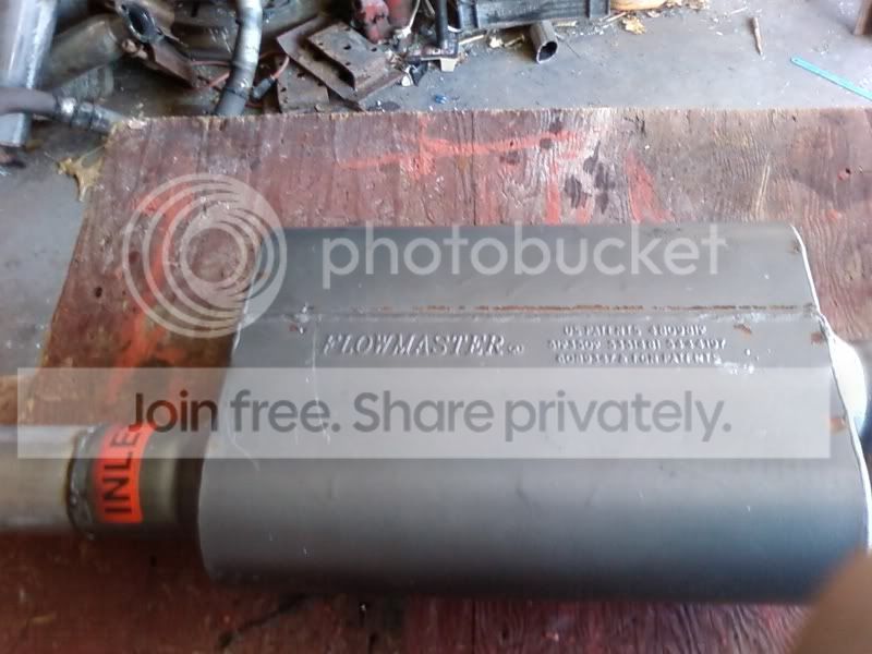

FINALLY SOME UPDATES: after wking 11 hours a day at audi i finally get to have some weekends off and i completed my exhaust
flowmaster muffler 40 series
my alright welds
looks like the exhasut is falling on the left but it just fell off the hanger
ill have some sound clips of it soon its sounds really good
quick shot of it how it stands now
i should be getting fenders soon!
Old Jan 22, 2008 | 04:32 AM
  #535
CBURKE's Avatar
Posts: 2,975
From: St.pete FL
Good **** man!!!!
Need a little more heat on them welds, there sitting kinda high.

^ is that what it is, i will try that but it does get good penetration. i aslo need to get a better helmet bc the one i have sucks and i need a bigger display piece, but i dont want to spend 300 on a helmet

I am pretty sure that is the prob. Mine was that the Gas welders that weld flux are set up from the factory to weld flux, so you may have to open the door and see if you have to change the + and - around like I had to

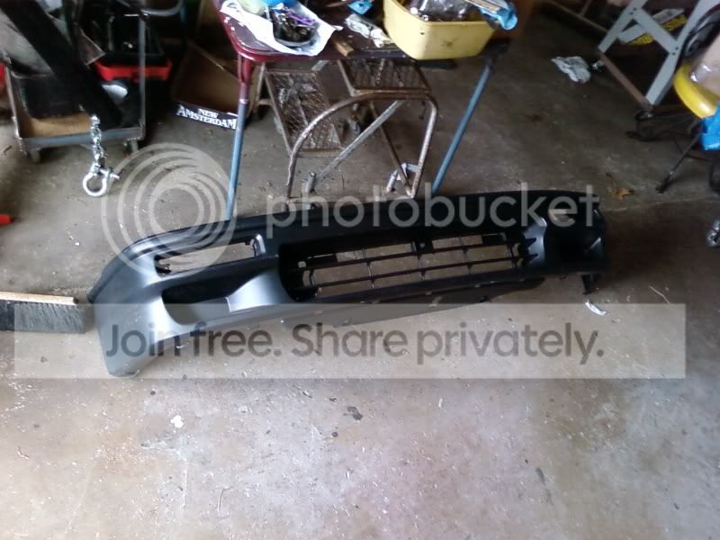

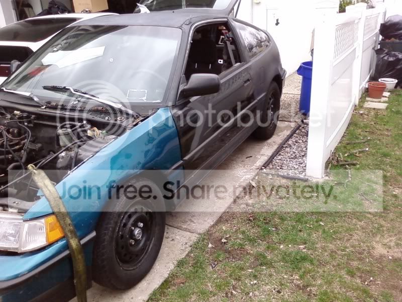

Don't mind the blue efed up bumper, he gave me a new one

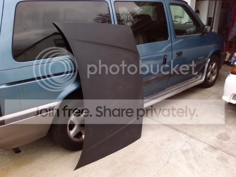

hood needs alittle more sanding , but i have another one lying around
he also said he might be able to get me a CF hood for free
theres my problem haha
the fender is a little messed up
next to my other crx

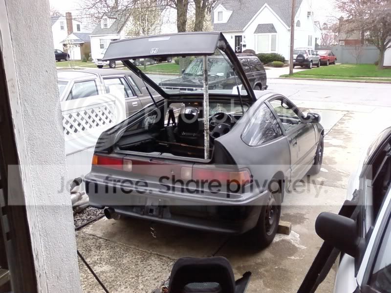

the interior is pritty clean, and all the interior is there
i cleaned the **** out of the carpet with carpet cleaner!

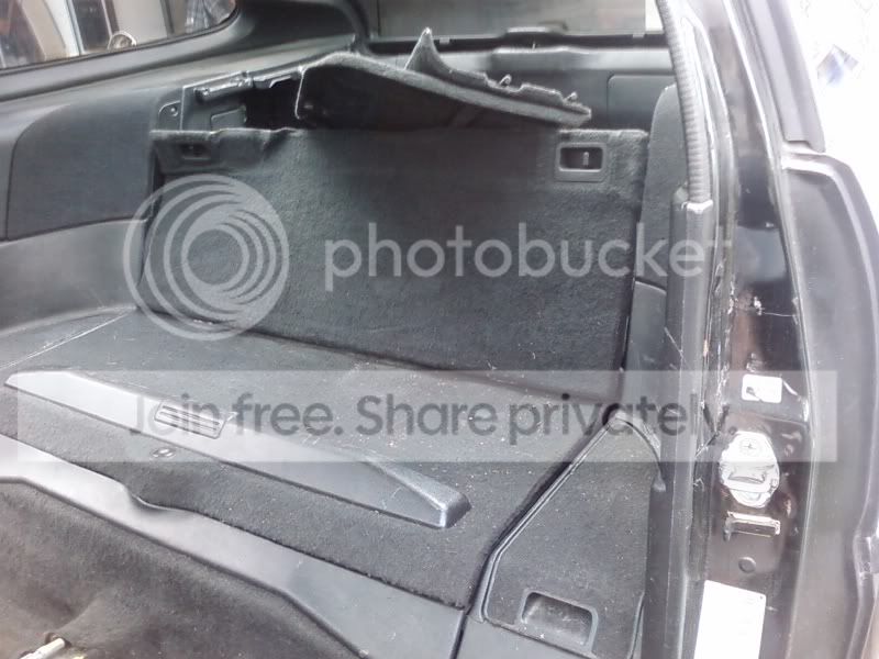

does anyone know the name of the color of carpet thats in the interior pieces, bc the backing to the cargo cover thing, that is broke inthe picture i want to fix the wood and recarpet it.
