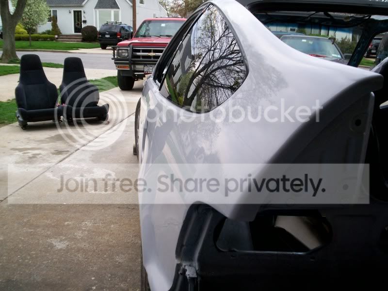

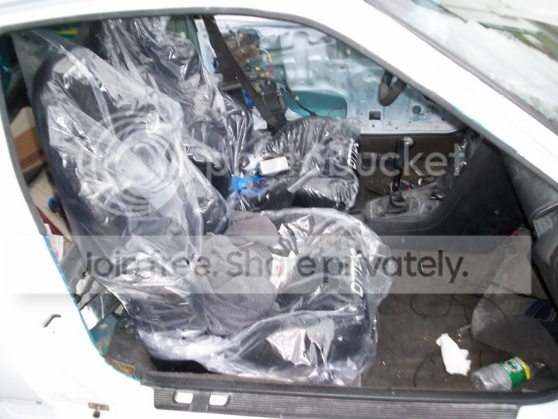

haha you knwo how long it took me to get those Si rims lol
and the seats are pritty good fairly comfertable i just have to fab brackets
stock holes for the seats are
about 17 1/2 " in the rear and about 15 1/2 or so in the front
and the new seats are like 15 front and rear
edit: those measurments are distances between each hole

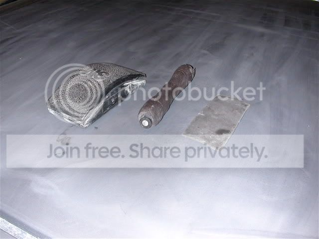

you're spending too much time in one spot. if you're doing an edge on a fender start at the front and in one motion go to the back. if you're doing the door jam start in one corner do a full circle in one motion ending up where you started. shimmying back and forth is asking for trouble.
what kind of blocks are you using?

i had my block i used for sanding kinda like this
i have that block (somehting liek that )
and cut about 4 inch off, then splices it down the middle
so its like 4" long and about 1/4- 1/2" thick
edit: and on the painting, everytime i did paint it was about 70 degrees thats why i havent painted in 2 days bc its been like high tto low 50's

your block will work well for the large flat areas. you'll need something else for the bottom of the doors, areas around the 1/4 window and the wheel arches. the middle block in the pic will do the trick. It's 3/8 heater hose wrapped with 3/8 insulation.

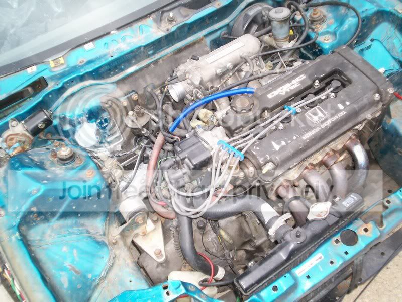

so that heater hose is about the size of the hoses going into the firewall going to the heater core, about that size and jsut insulatetion (like the foam that raps around the pipes ?&gt;
great idea thanks!

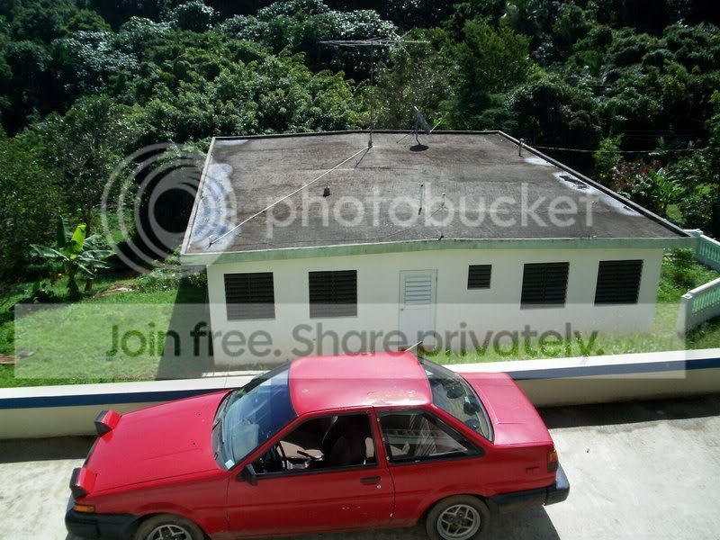

i want this to be my next project!
thats my dad corrola RWD supra motor / rear end!
but its in Puerto Rico rigt now and my dad wont ship it back here to NY
oo i might be buying an EG but i will be keeping the CRX as a DD and the EG as my project
idk well see

^^What the roof? It is holding water which looks like it will cause a problem in the long run.
Old Apr 27, 2007 | 05:41 PM
  #340
91ed9's Avatar
Posts: 1,514
From: Long Island, NY, USA
Default Re: My Project (harmonator)
dude thats Puerto Rico man it rains mad and the rain dries out so fast bc its soooo damn hot there!
thats how all the roofs are there
edit: the entire house is made out of sinderblocks and cement
its not going anywhere lol

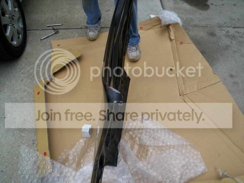

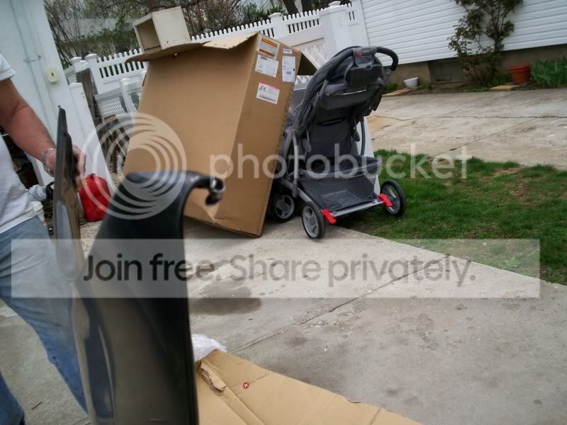

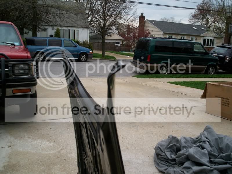

This is ******* BULLSHIT my fuckingn hood was damaged during shipment
i cant fuckign belileve this, i am soo fuckign outraged by this, i cant catch a break

<TABLE WIDTH="90%" CELLSPACING=0 CELLPADDING=0 ALIGN=CENTER><TR><TD>Quote, originally posted by 91ed9 &raquo;</TD></TR><TR><TD CLASS="quote">so that heater hose is about the size of the hoses going into the firewall going to the heater core, about that size and jsut insulatetion (like the foam that raps around the pipes ?&gt;
it's slighly larger with a stiffer sidewall. yea insulation that's used on AC lines. there may be a piece on your pcv hose.
pics of shipping damage?

<TABLE WIDTH="90%" CELLSPACING=0 CELLPADDING=0 ALIGN=CENTER><TR><TD>Quote, originally posted by eda6 &raquo;</TD></TR><TR><TD CLASS="quote">
pics of shipping damage?</TD></TR></TABLE>
i so pissed you wont believe, bc i knwo there going to be like sorry theres nothgin we can do you hve to take this up with the shipping company and then im going to have to seal wiht the lose of 260 bucks i know it
im going to get fucked

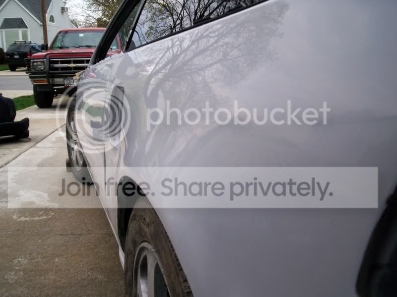

on a better nnote
