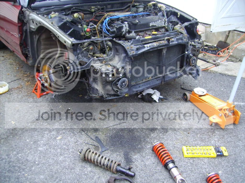

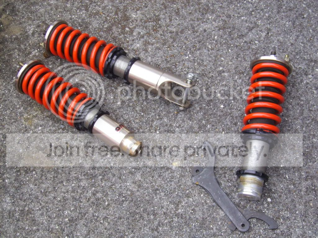

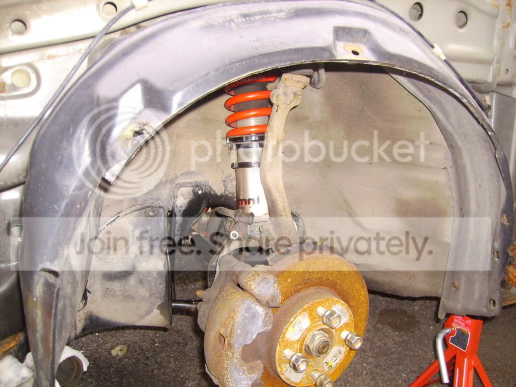

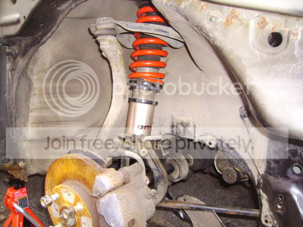

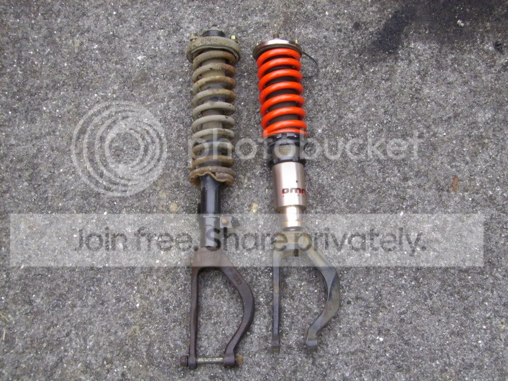

build update---
jus got my omnipower coilovers..
the omni's are for an eg... bolted right up to my ef though..
bolted up the front-
didnt get to take pice of the rear's yet..they'll be up in a few days

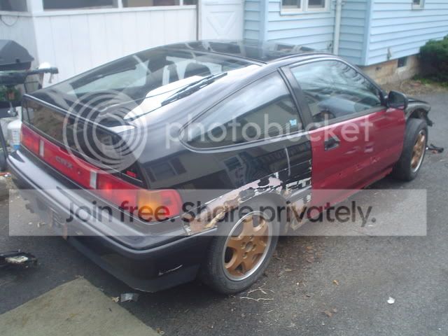

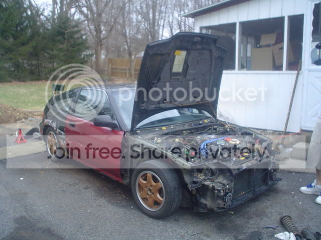

Man the rust on that thing is unbelievable, I've never seen it so bad. Its going to be so much better once you get new metal in there. You get my support on this one. It looks like a fun project.

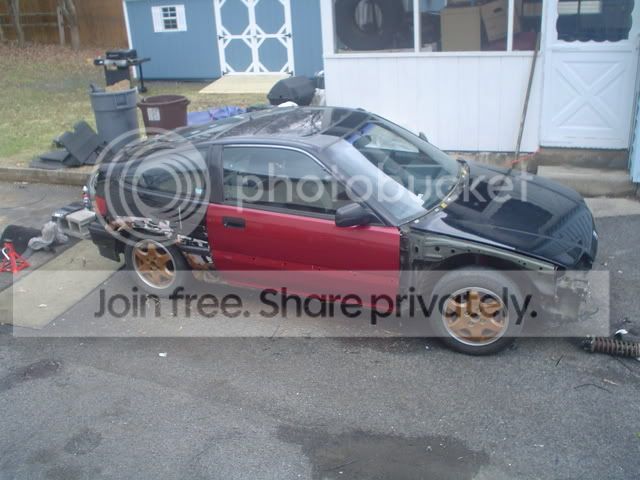

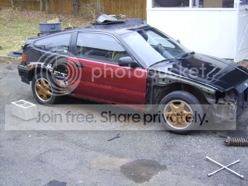

build update-
bolted up the rear suspension...
had some trouble with the driverside outter lca bolt though, snapped both heads off. ended up having to pound out the lca, press out the bushing and put in a new polyurethane for the mean time..
the rex as it sits now dunkin donuted-
me next to it-
from ground to roof the car is approx. 46 inches....
i know i know the rust needs fixed badly and i'm workin on it slowly but surely it'll be done very soon... im now foucusing on only spending $$$ on rust repair...

I would save the money from the rust repair and get a haircut...haha, jk.
Looks like a good start. Good luck on the rust repair. Your going to be better off in the long run buying new rocker panels.

You've got some metal work to do! Keep up the good work for ambition on a car that most others wouldn't have the gusto to attempt rebuilding

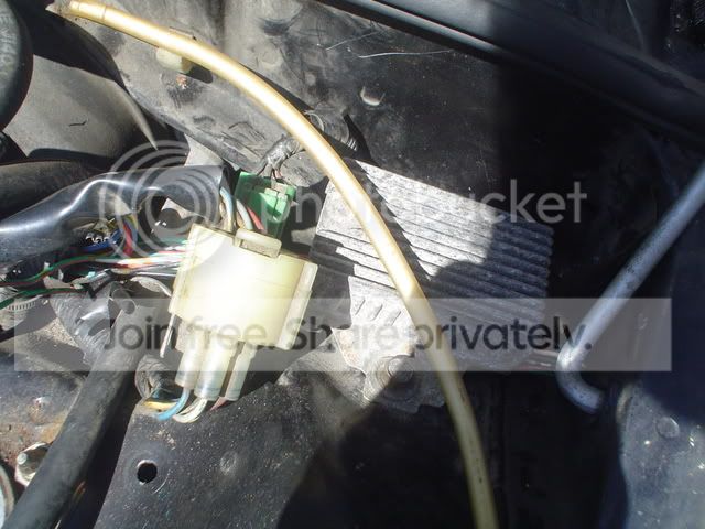

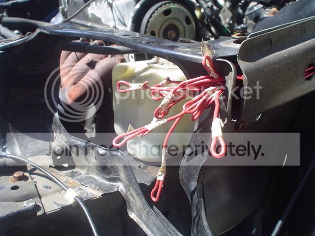

heres a couple ok pics on my tuck so far..
ill post more when i get a chance to take more..
i have the headlight,horn,fog light,turn signal,bumper light, w/shield washer hose, and pump wires tucked threw a hole behind the injector resistor box..
i have them exiting right behind the headlight.

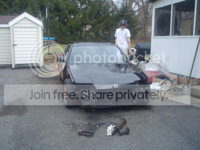

Next time use JACK STANDS!!!!
You leaving the car on blocks is asking for someone to get hurt....a kid in my auto school awhile back died when his BLOCKS crumbled while he was under his car

looking good. now the fun part....replacing all that missing metal. good luck on your build!!!

get underneath the car and take some pics of the frame rails and floors. How much rust is under there?
