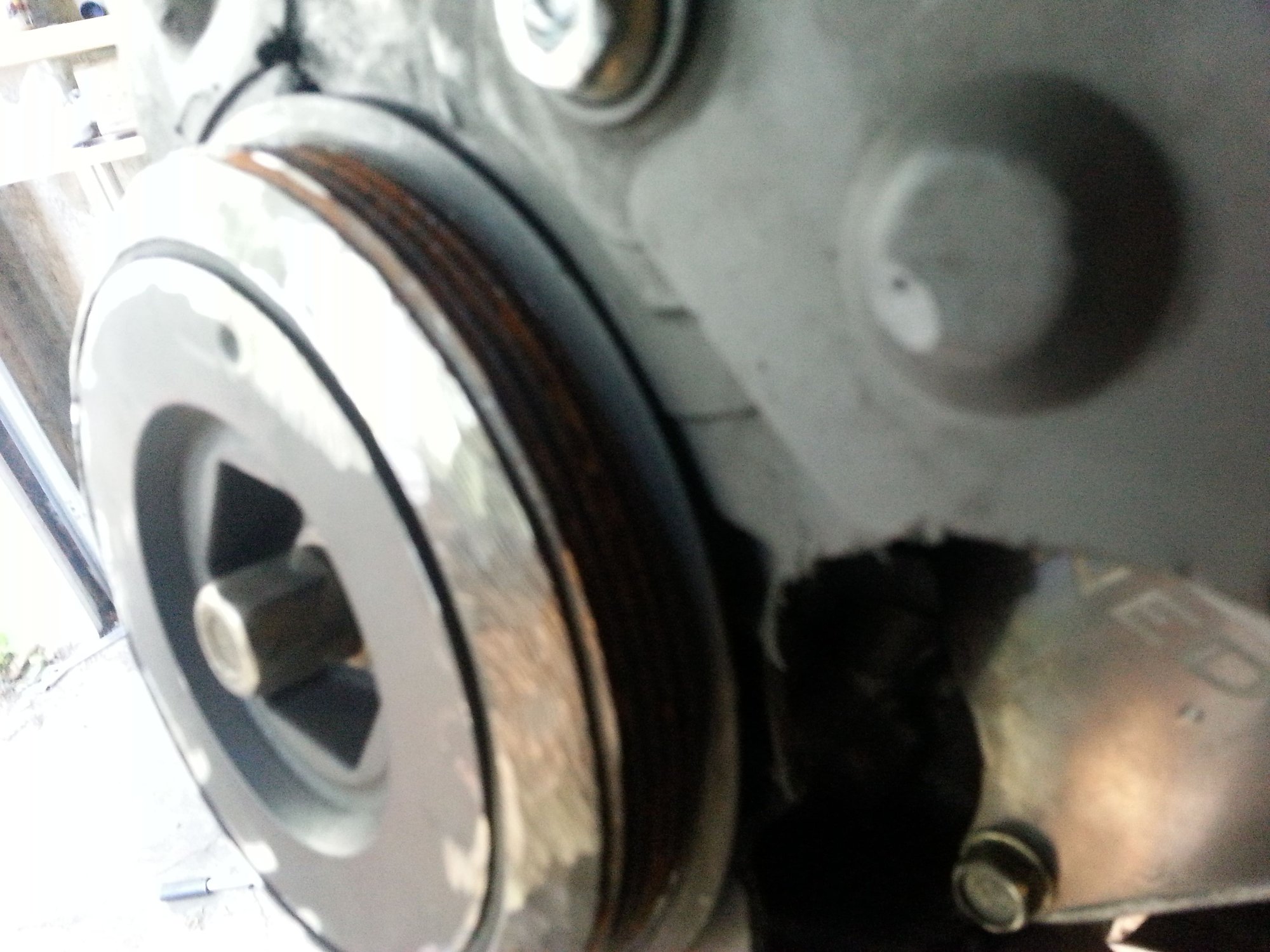

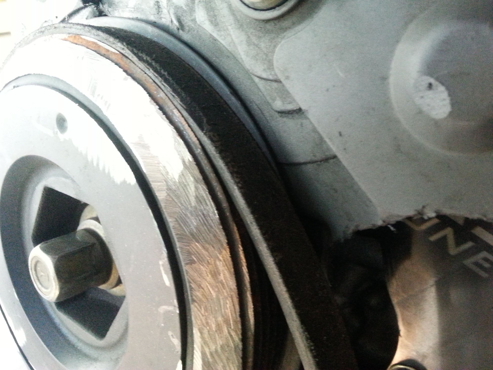

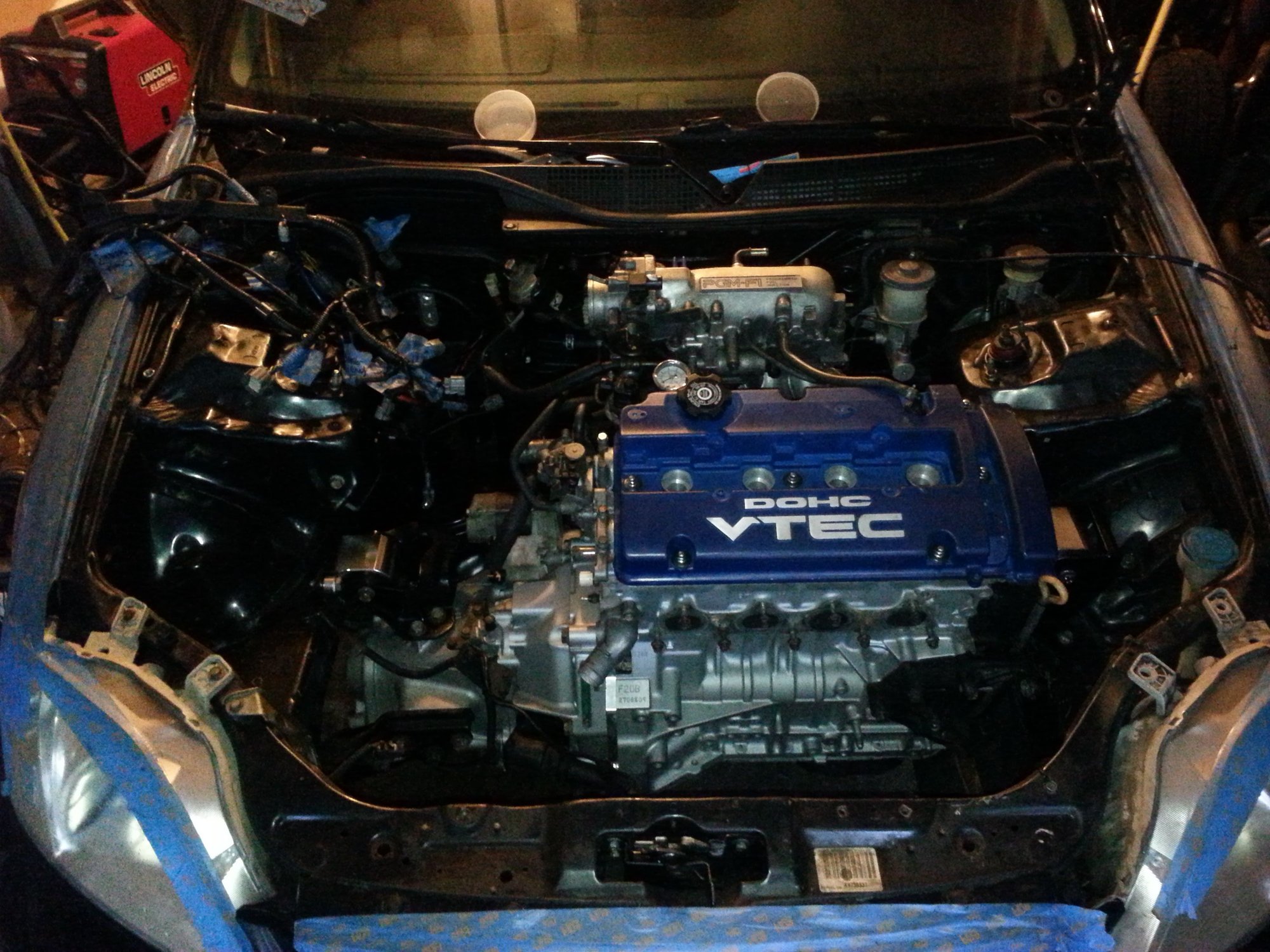

Hoping to get the motor bolted in tomorrow. I pretty much didn't do any work on it this weekend other than a small amout of frame rail banging (definitely going to need more) and some grinding on the crankshaft pulley. Only a few pics but I was lucky enough to have the actual f20b pulley and don't have to worry about taking off the air conditioning/power steering pulleys
You can see how much I actually took off, first I took a small metal mallet and tapped around the outer rim to crack off the lip, then took a grinder and took off down to the first rib. I'll be using the exact same belt as my EG h2b setup because of how narrow it is, along with a b18c1 gsr alternator pulley to match it. This looks sketchy but it won't come off the crank pulley.

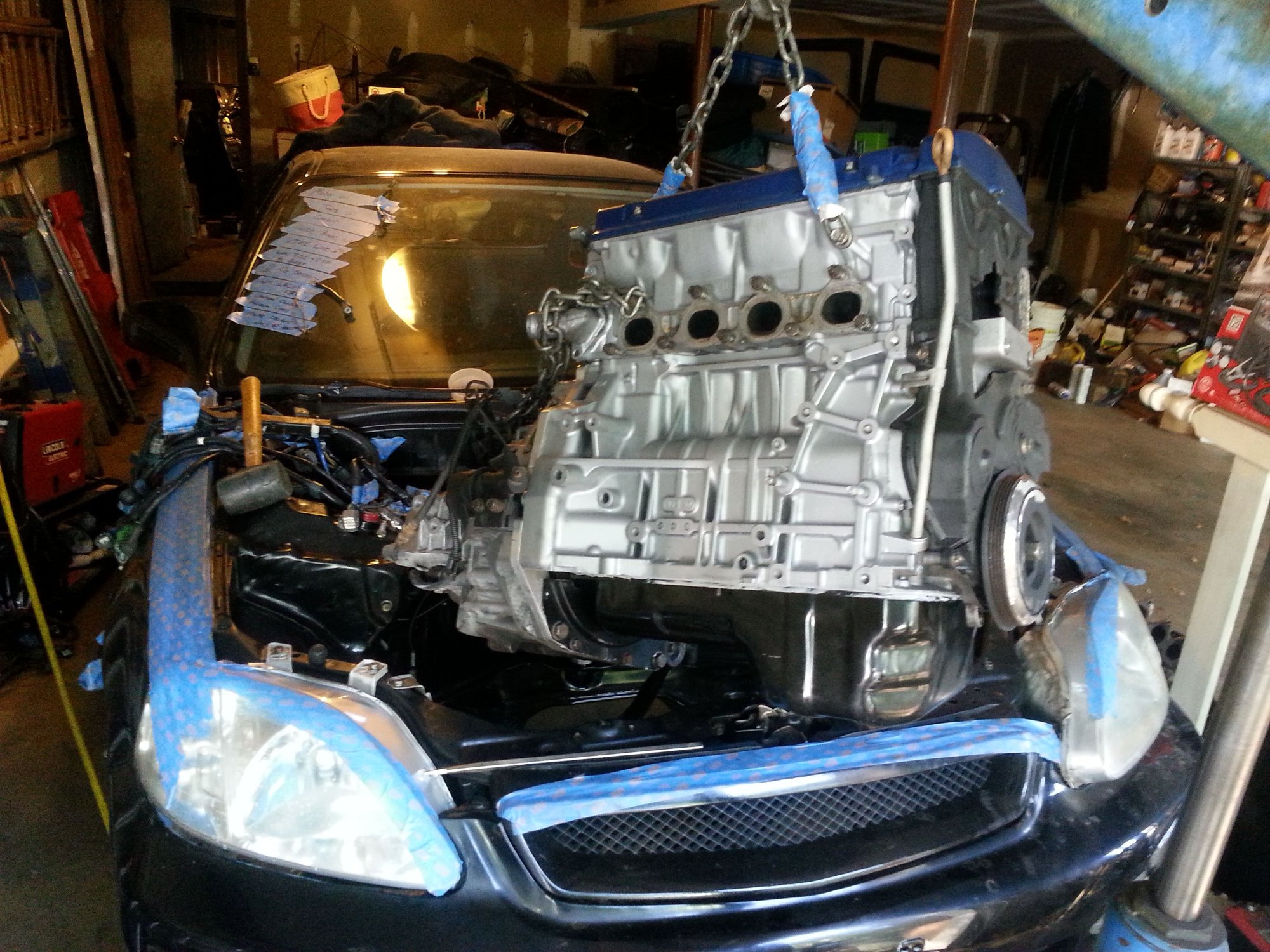

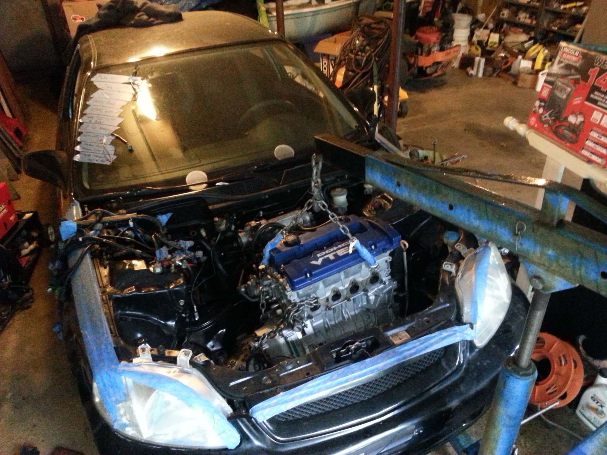

Probably had the motor in and out at least 10 times today but I think it's finally in the right spot. Still need to do wiring, coolant hoses, fuel lines, axles, exhaust, figure out alternator...

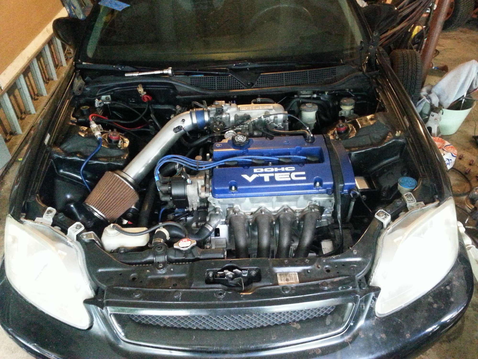

Default Re: F2B 2000 EJ Hatch Build

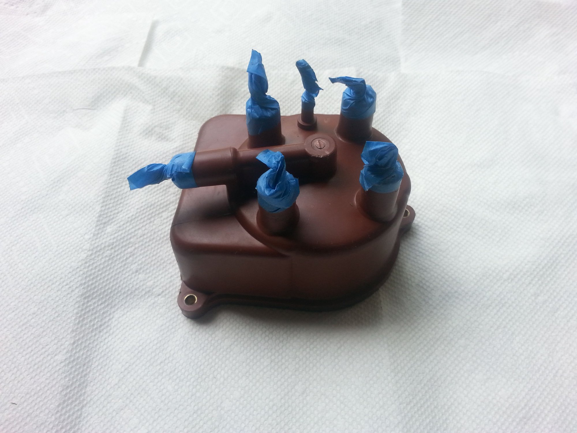

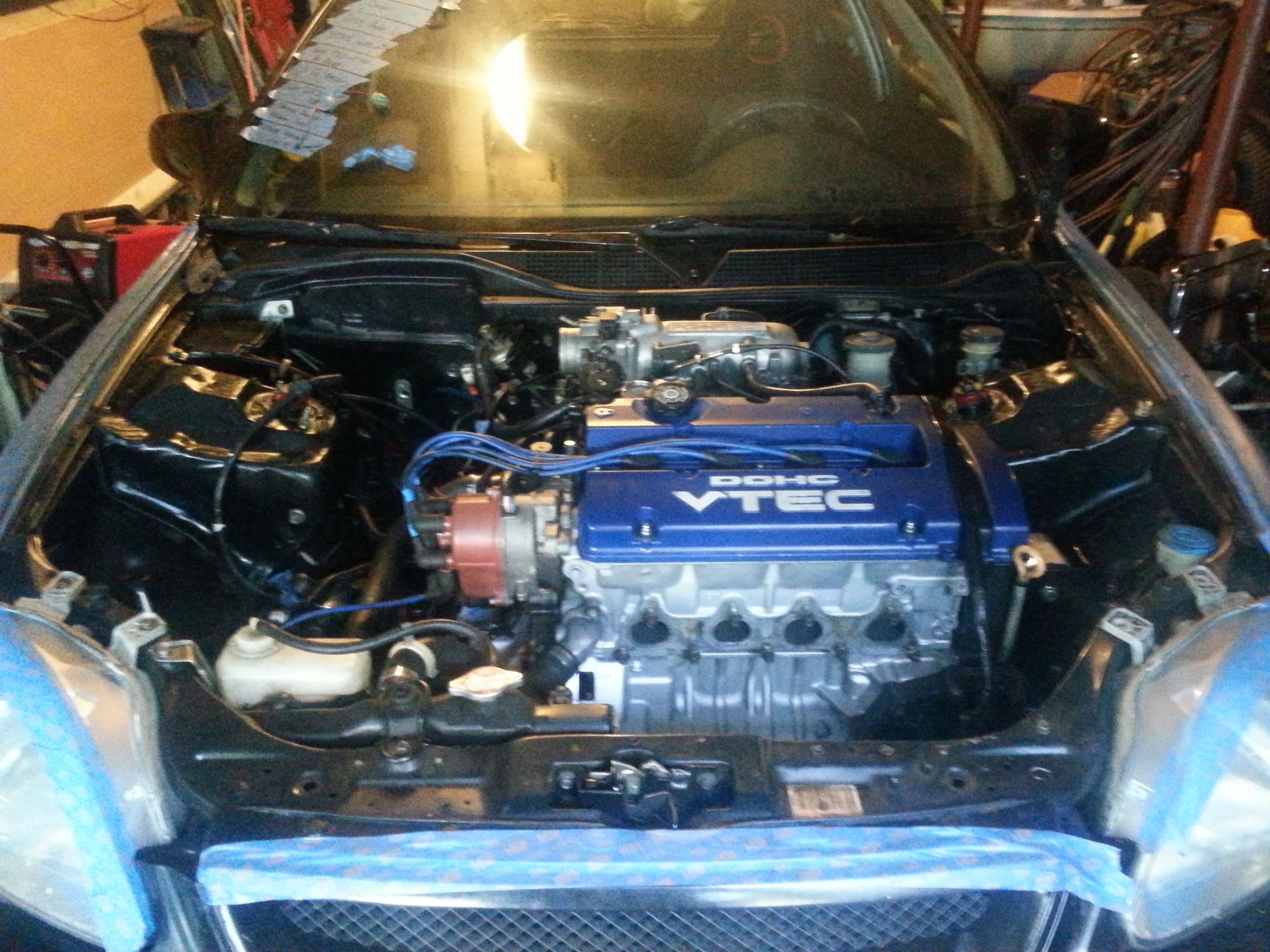

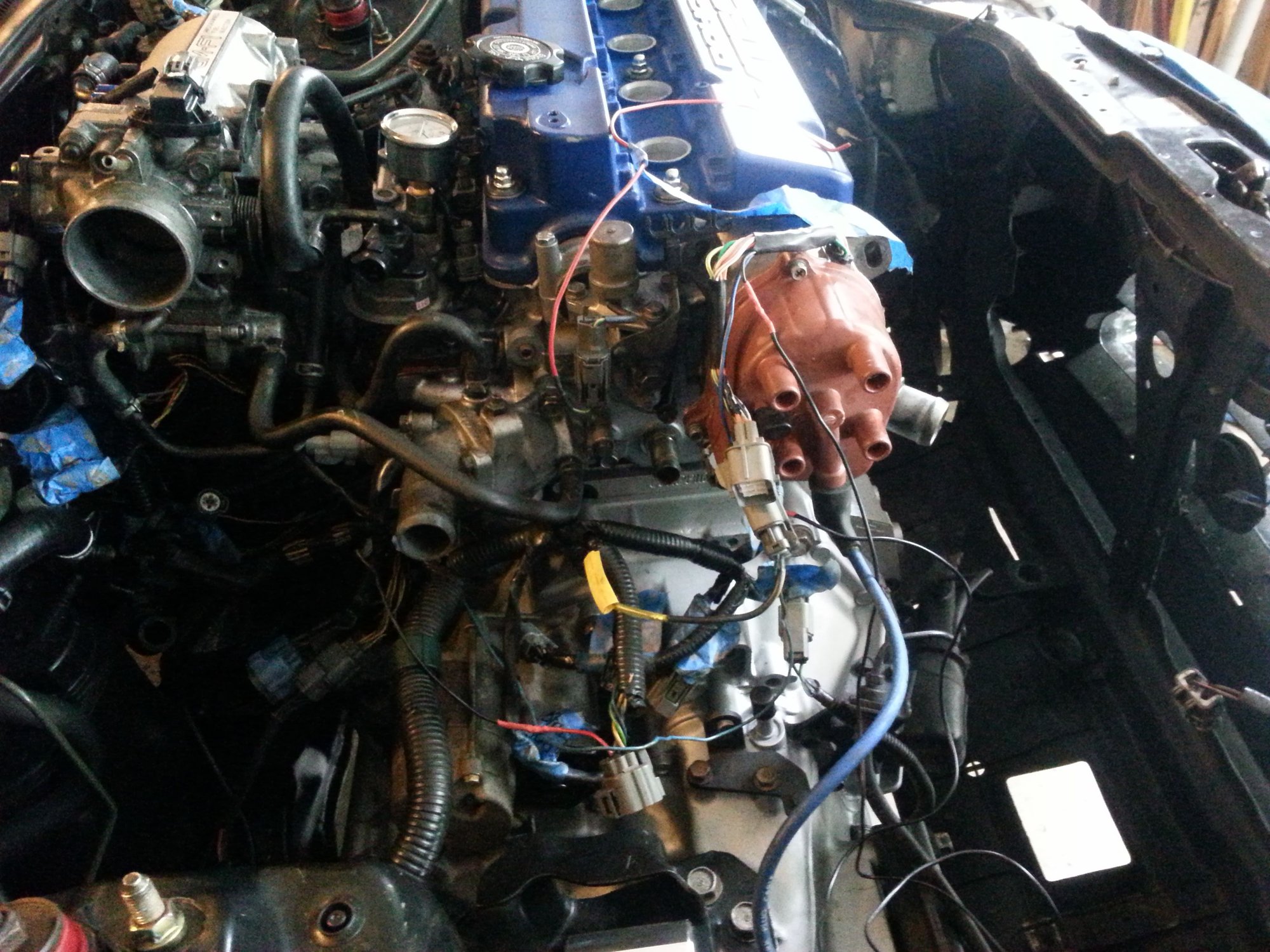

Today I finished most of the wiring (everything but the knock sensor and vtec wire) the distributor/external coil was a nightmare but its done. Also all the coolant and vacuum lines are done, radiator is in, fuel lines are good.
To do list:
-axles
-weld in o2 sensor bungs and weld cracks in exhaust
-wire up knock and vtakkkk wires
-clutch lines
-recharge and install battery
-front knuckles
-figure out alternator
-SPRAY PAINT THE ******* DISTRIBUTOR CAP
-swap skunk2 rear coilovers from EG civic
-swap walbro fuel pump from EG civic
...I'm sure there's a lot more to do but I can't remember right now
few pics

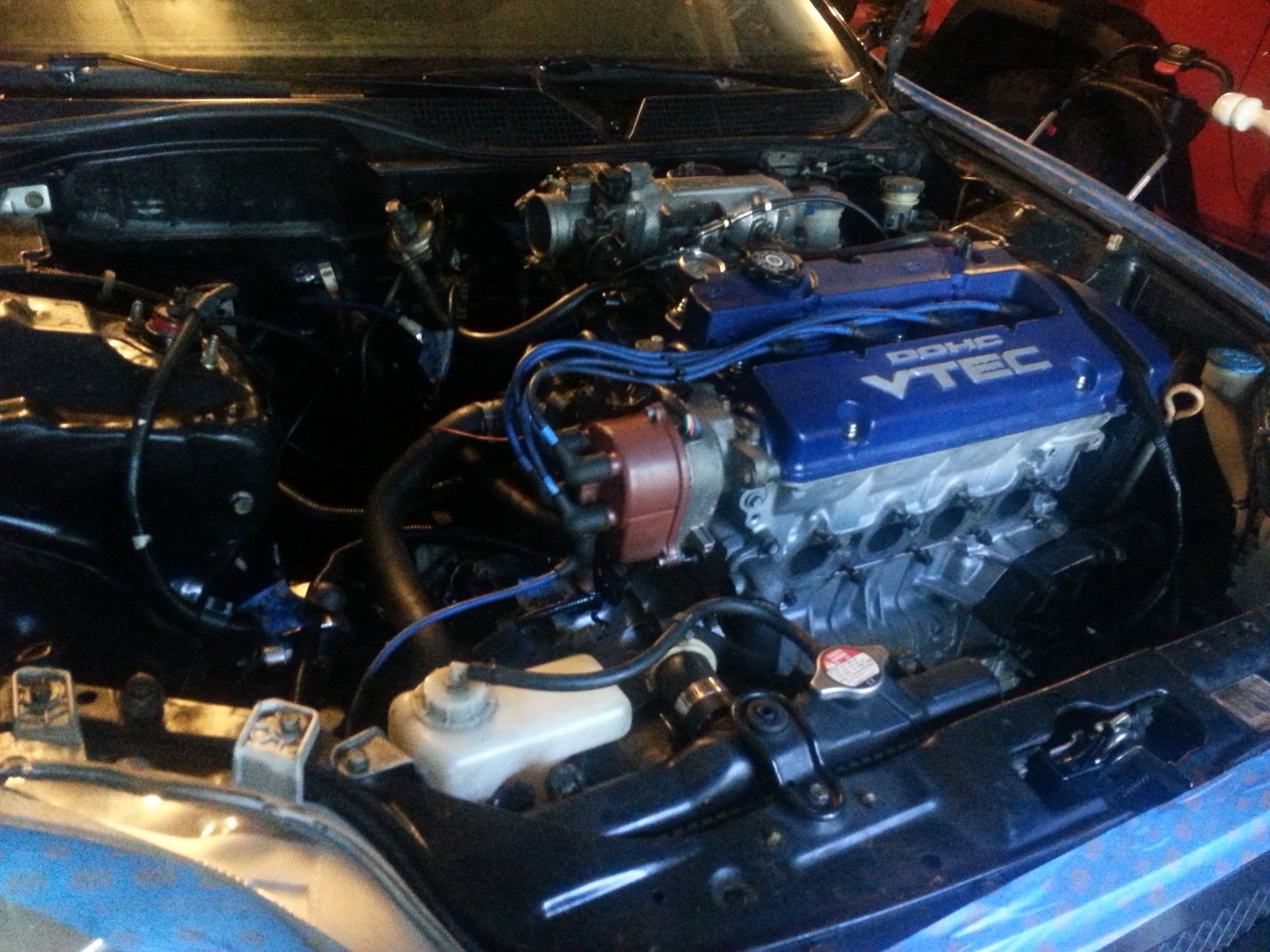

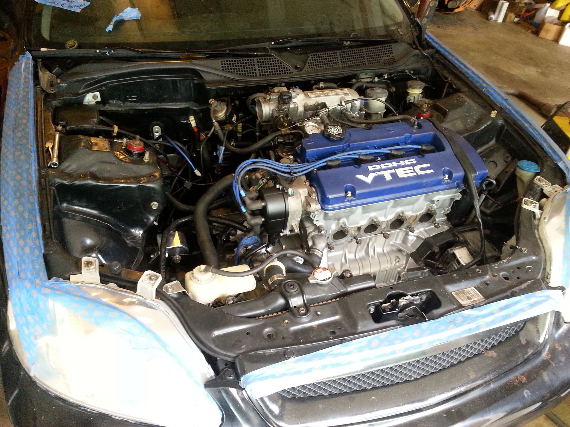

Knuckles, axles, and alternater are done, and dizzy cap is painted. Motor and tranny have oil, but the thermostat housing is leaking coolant.
Also still need to weld up exhaust, wire knock and vtec sensors, install clutch line when its in, and figure out the coolant leak.
Only took 2 pics today

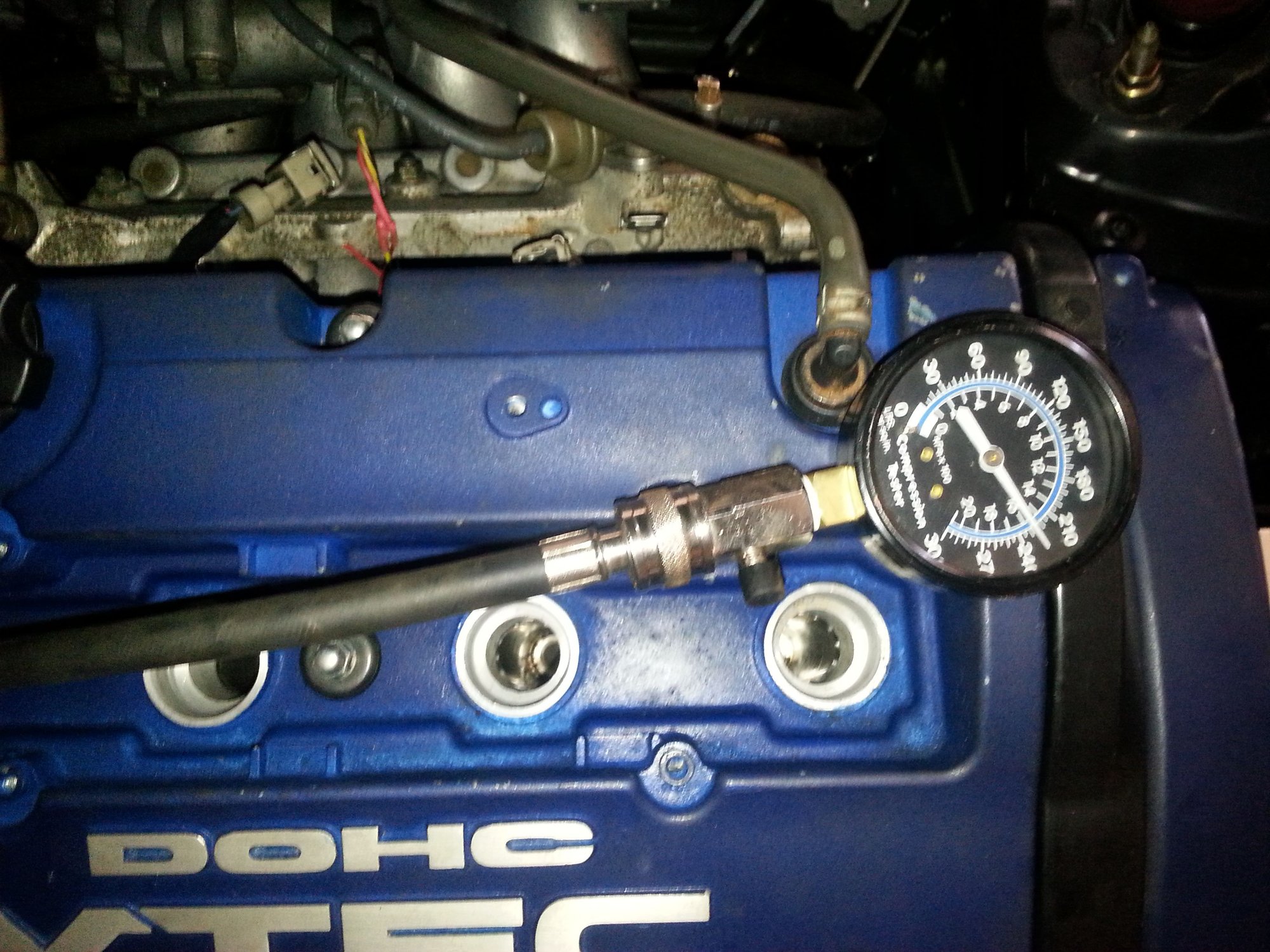

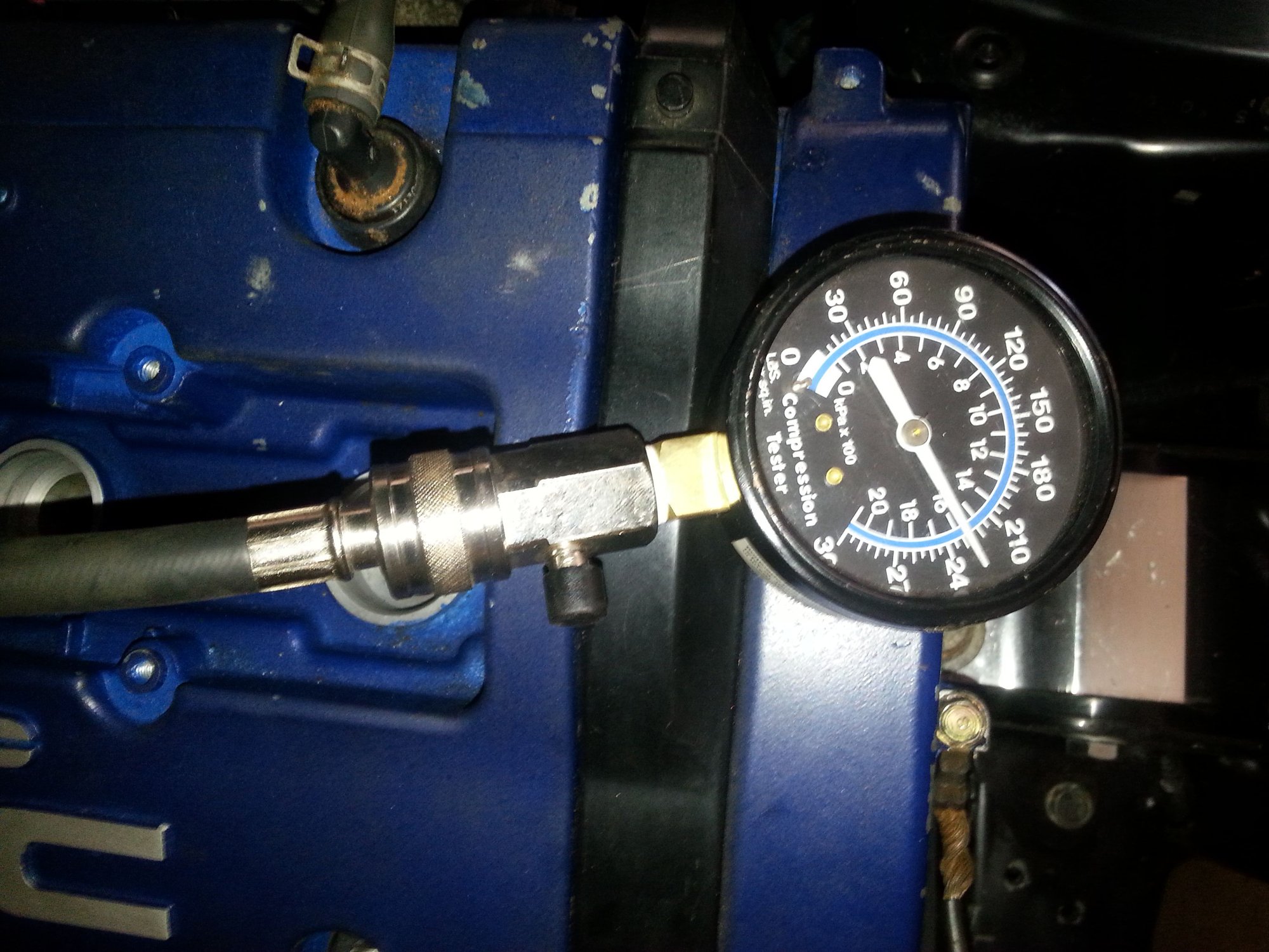

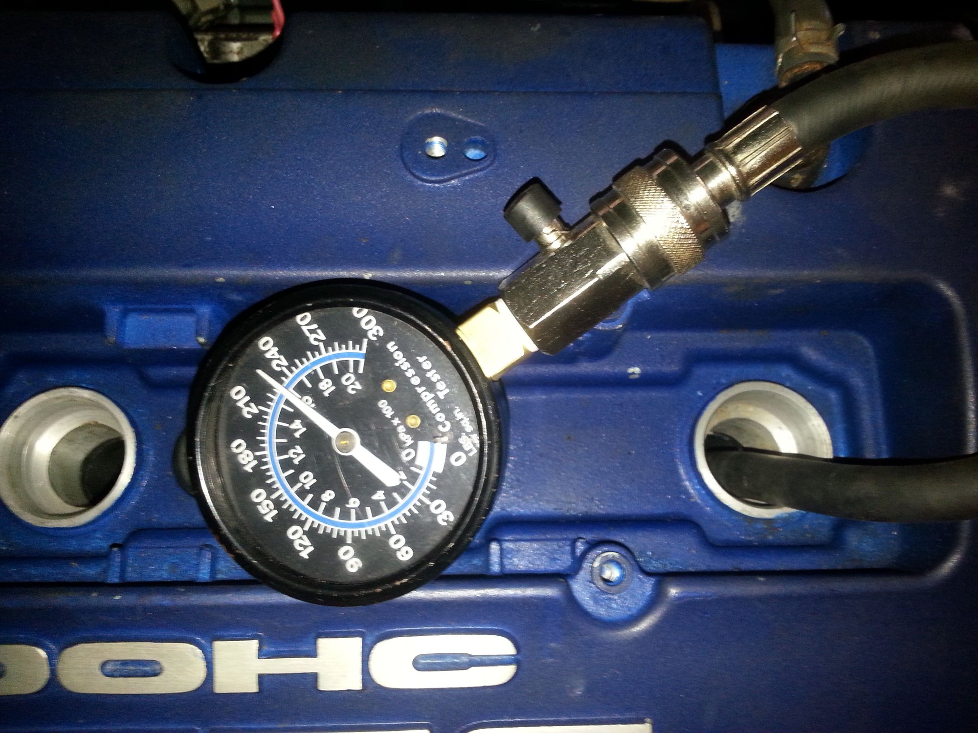

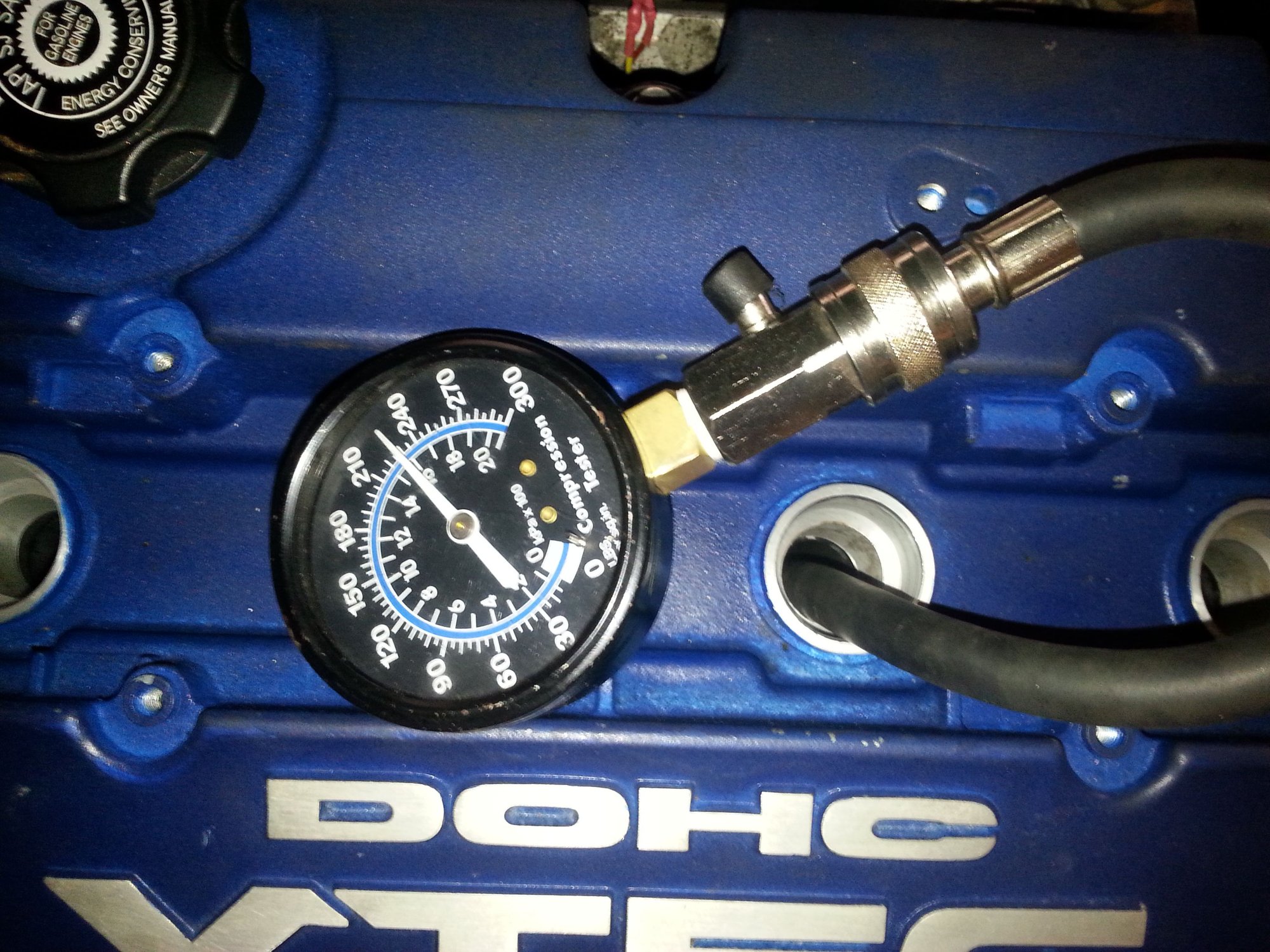

Forgot to post these.
compression update

Does you ECU chip have the Vtec oil pressure switch bypassed? On the second page it looks as if the vtec solenoid oil pressure switch was blocked off. JDM engines to my knowledge do not have them.
