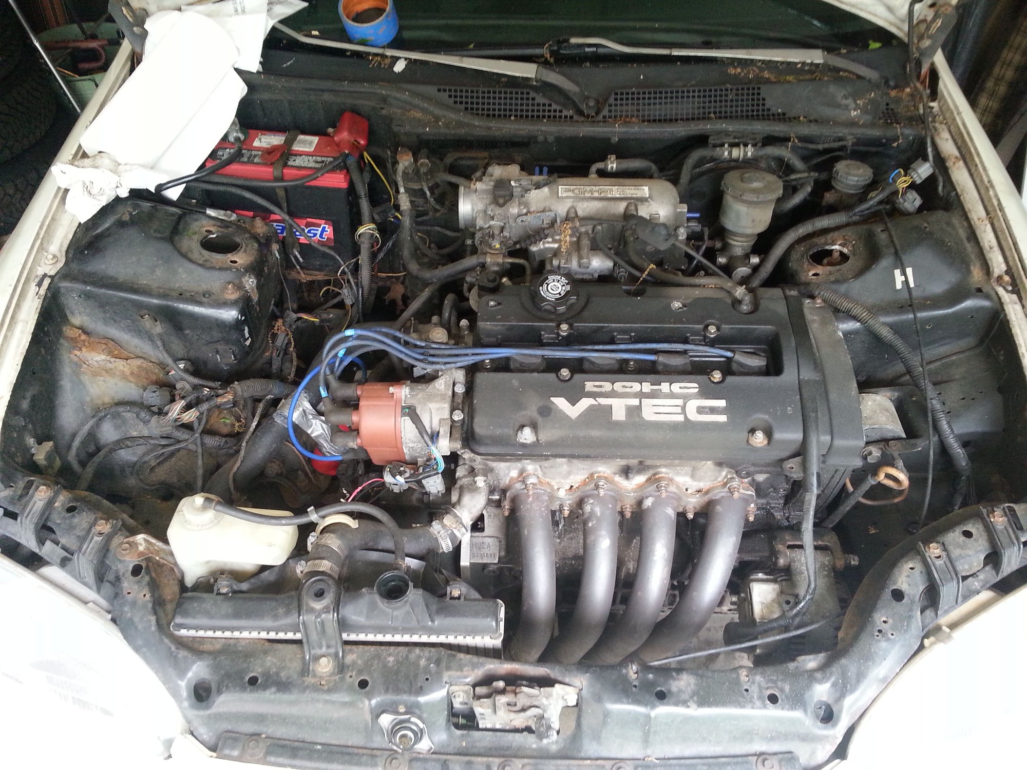

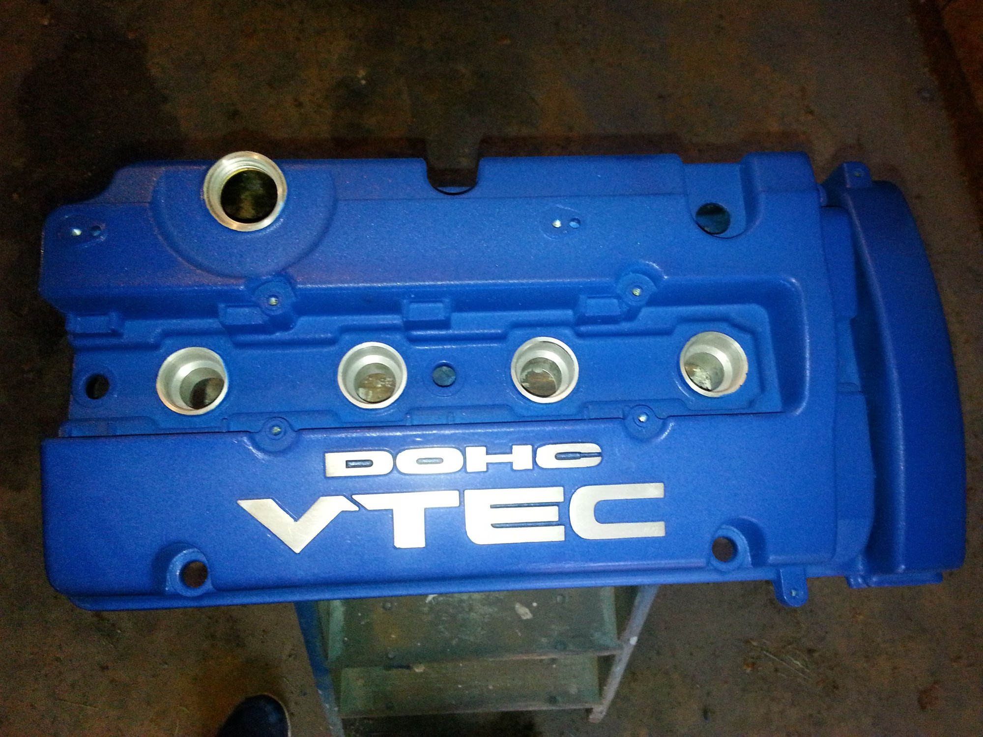

This is pretty much the final product. Im planning on ordering an oem fresh one from hmotors at some point, but this will do for now

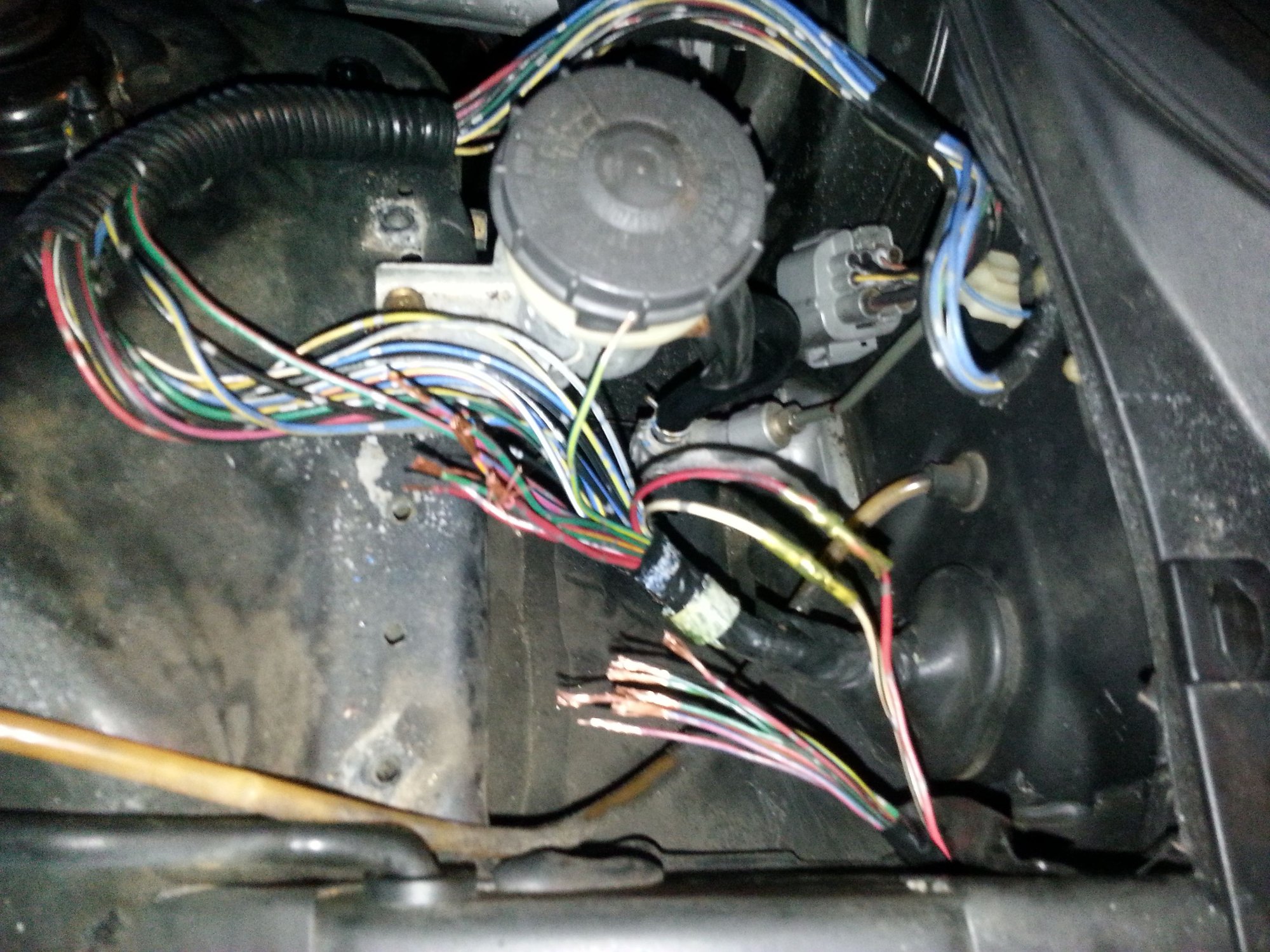

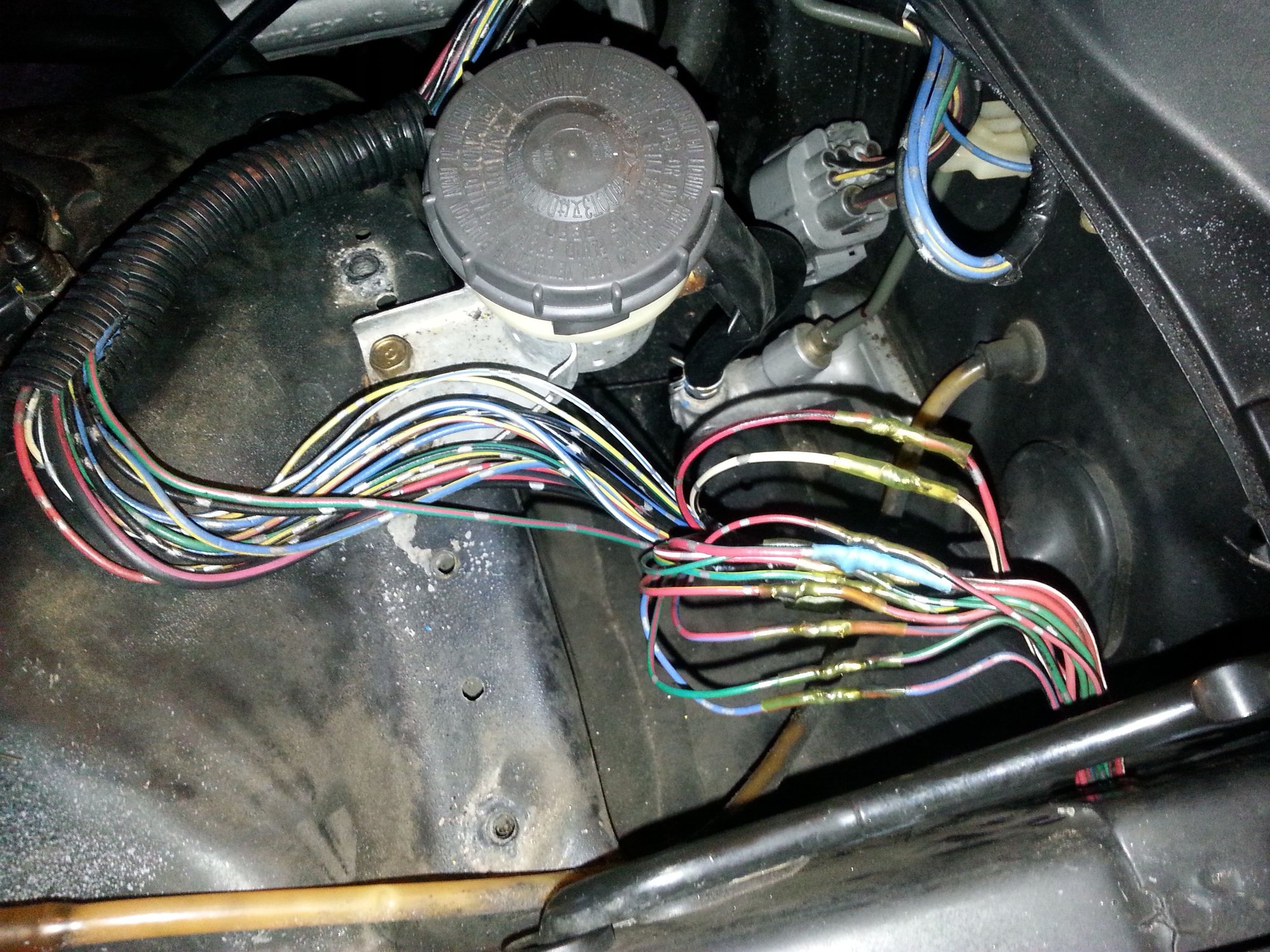

Started a mini wire tuck,very easy on EK civics. I might keep going with it, but I might be satisfied with just this after I loop the power steering lines
Passenger side
Driver side
Before
After
I'll wash the bay when my knee is in less pieces

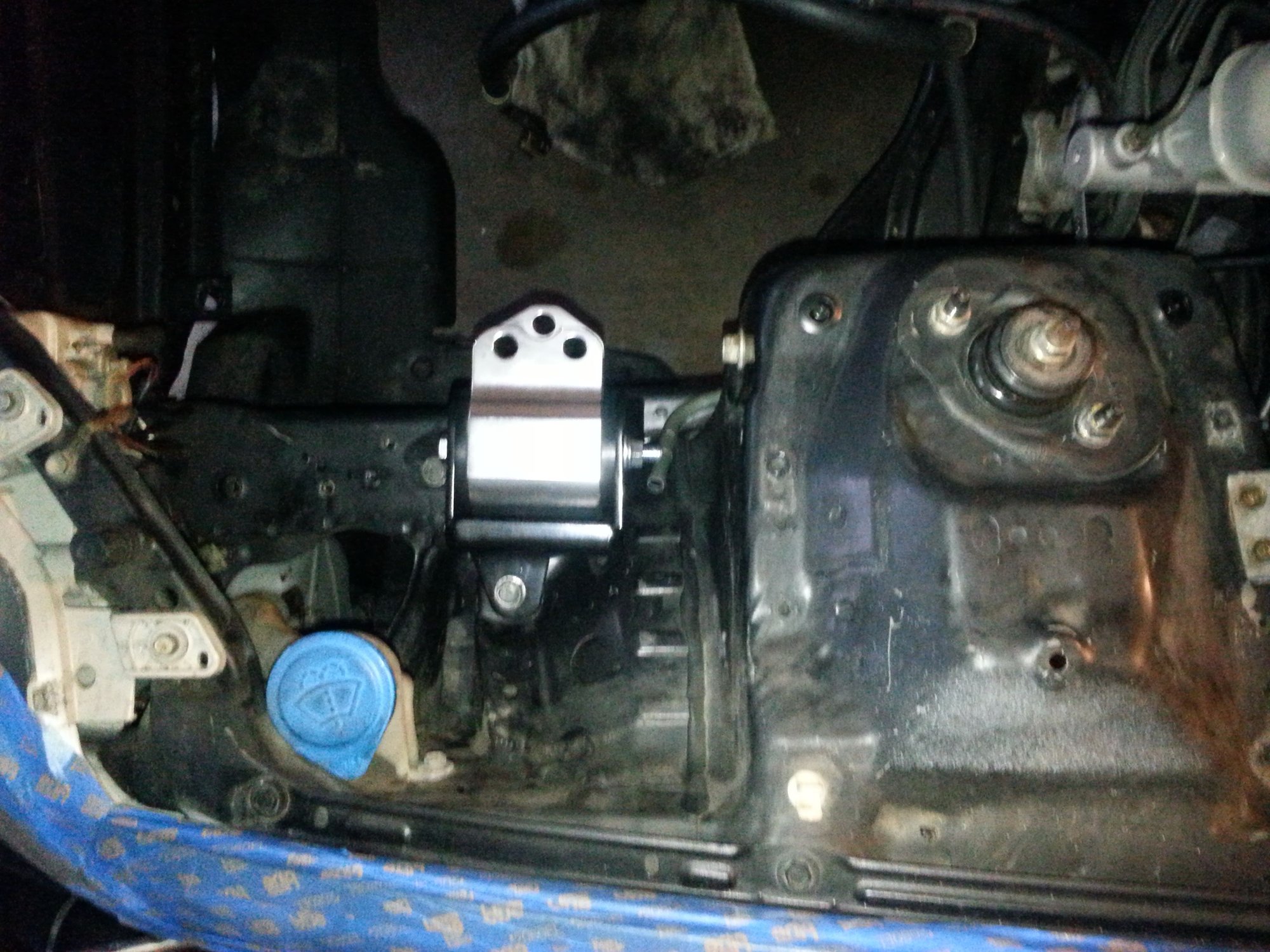

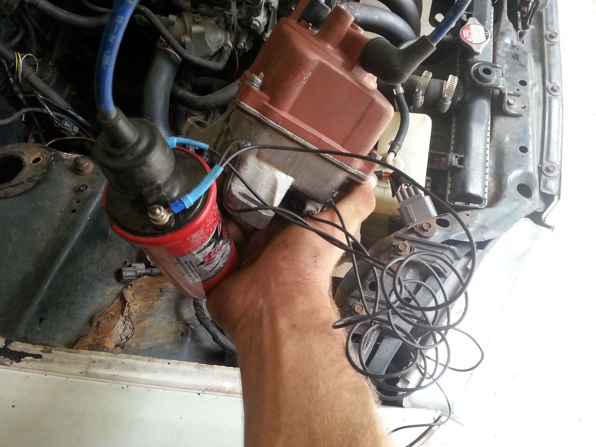

This. *******. Cast.
I cannot wait to walk again.
I'm going to need help figuring out how to wire this at some point

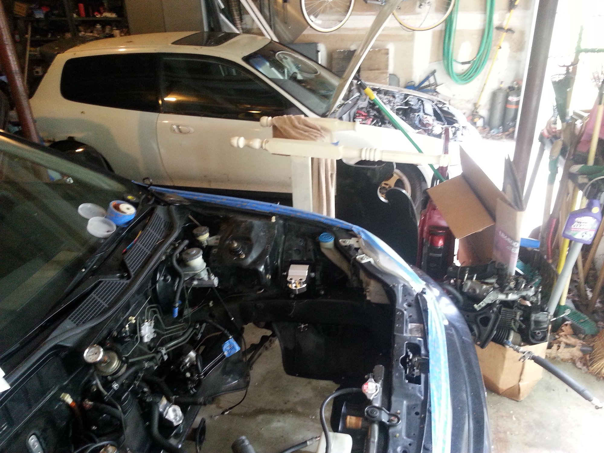

Tomorrow I'm hoping to take the transmission, intake manifold, h2b kit, clutch, fuel rail and sensors for the EK. I think I'm going to use the EG's skunk2 coilovers all around but I heard the rears may need some modifying. Also does anyone know if EG and EK fuel pumps are interchangeable? I'd like to use the walboro pump from the EG if they are.

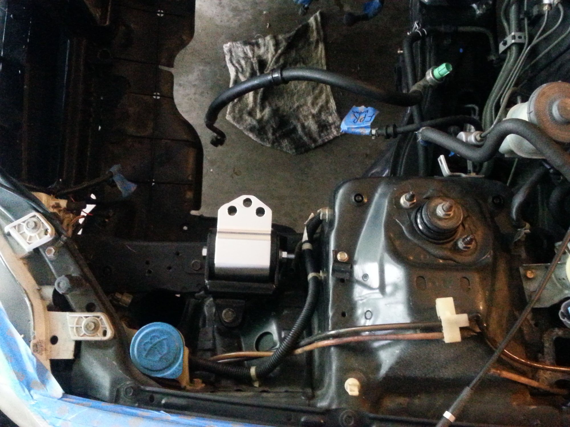

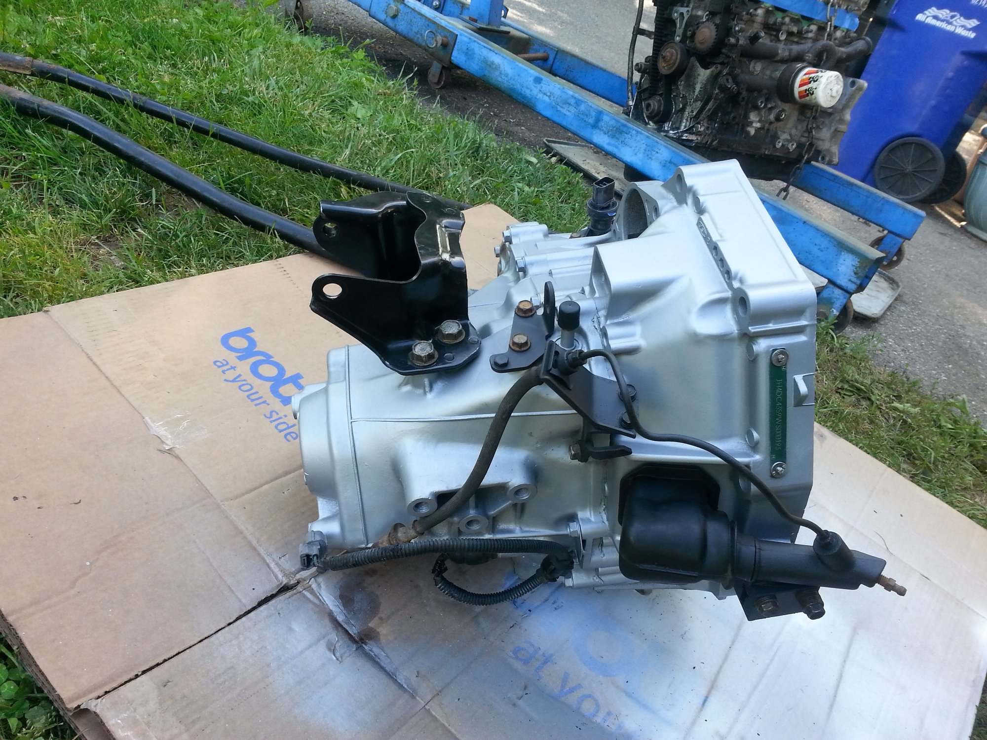

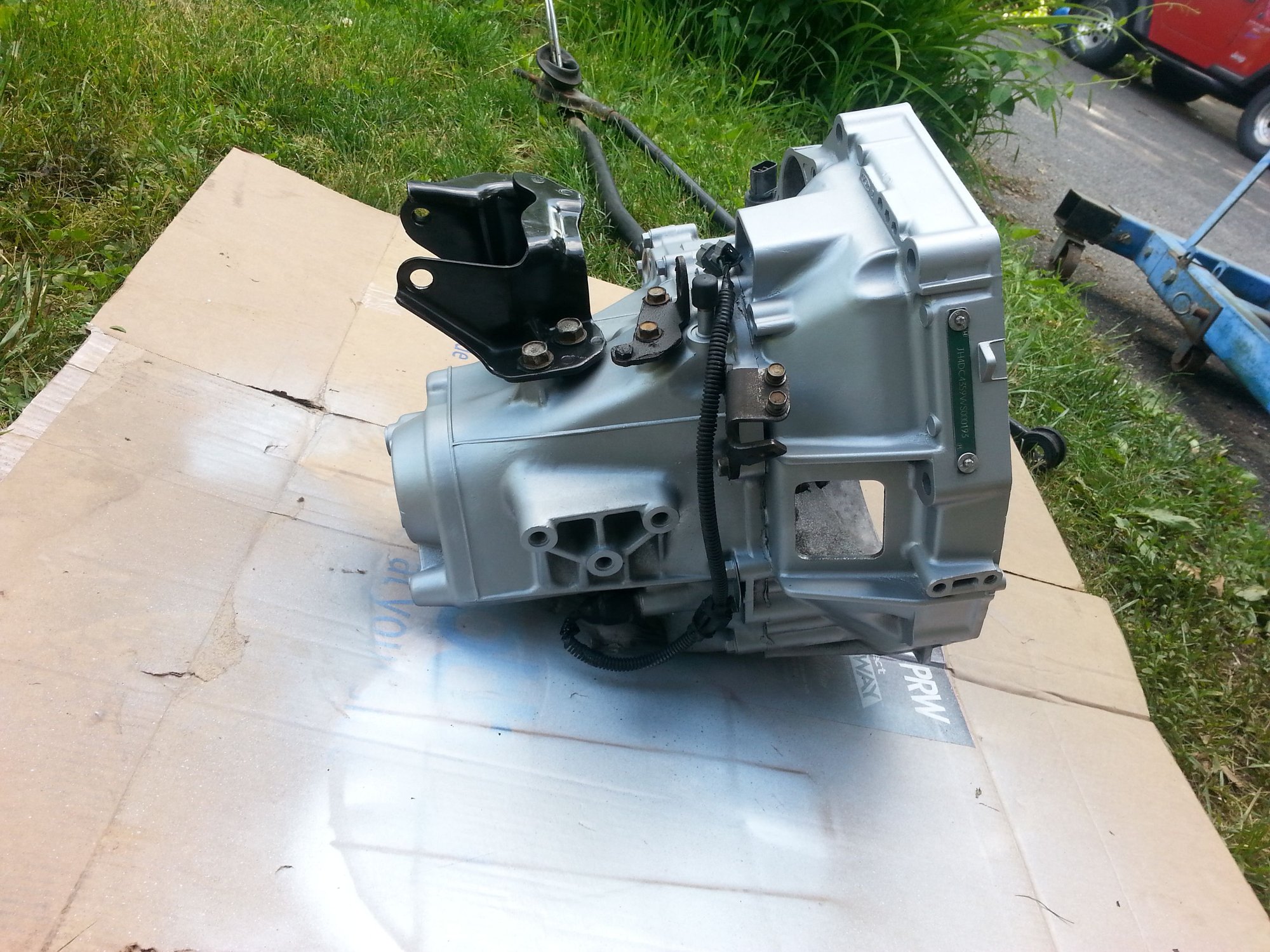

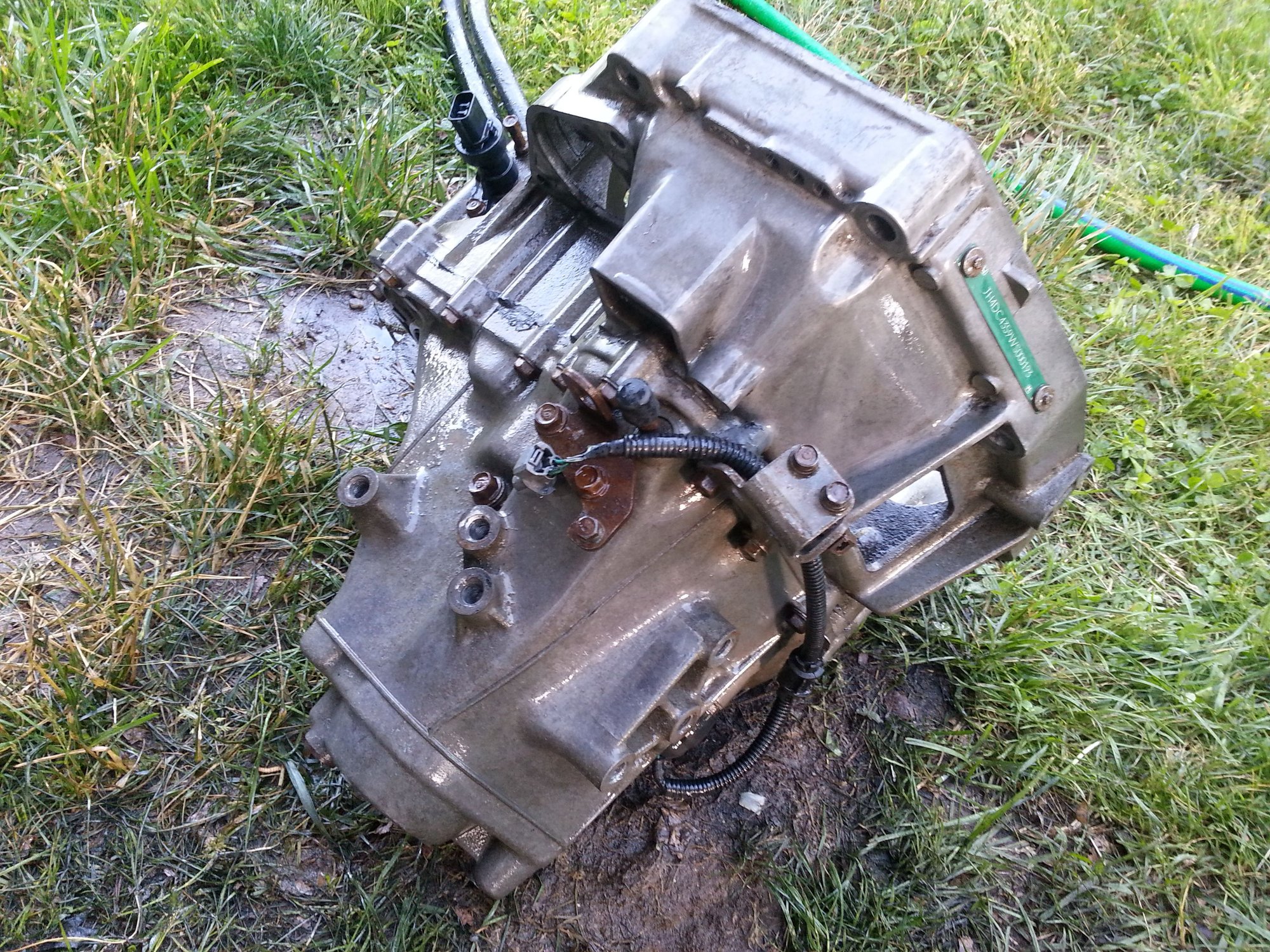

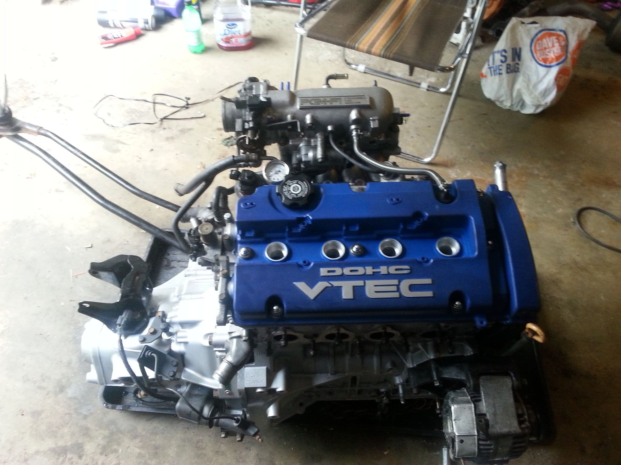

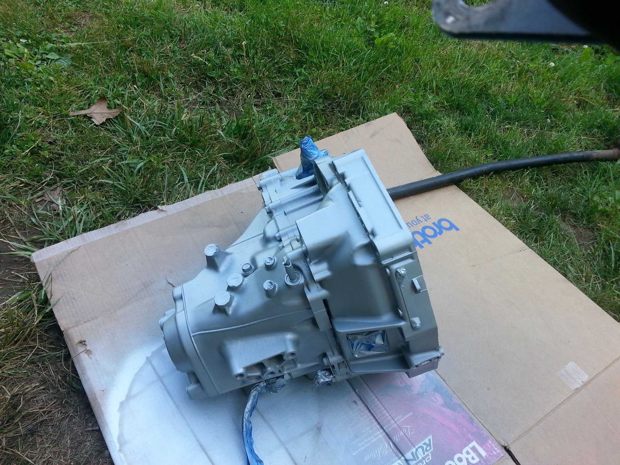

Got a little bit more done this weekend. Wired up an obd1 harness for the alternator, swapped my EG skunk2 coilovers to the EK, pulled the EK exhaust and shift linkages out, picked up a new throw out bearing and pilot bearing for the clutch, wire brushed and painted the gsr transmission. There are fewer and fewer things to do until the headgasket comes in and im losing patience waiting for it. Only took pics of the transmission work but it came out ok.

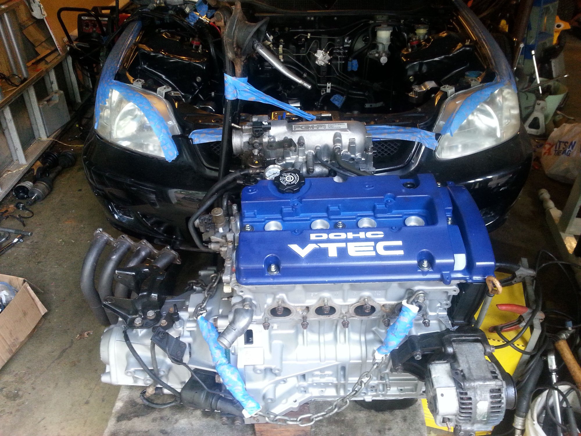

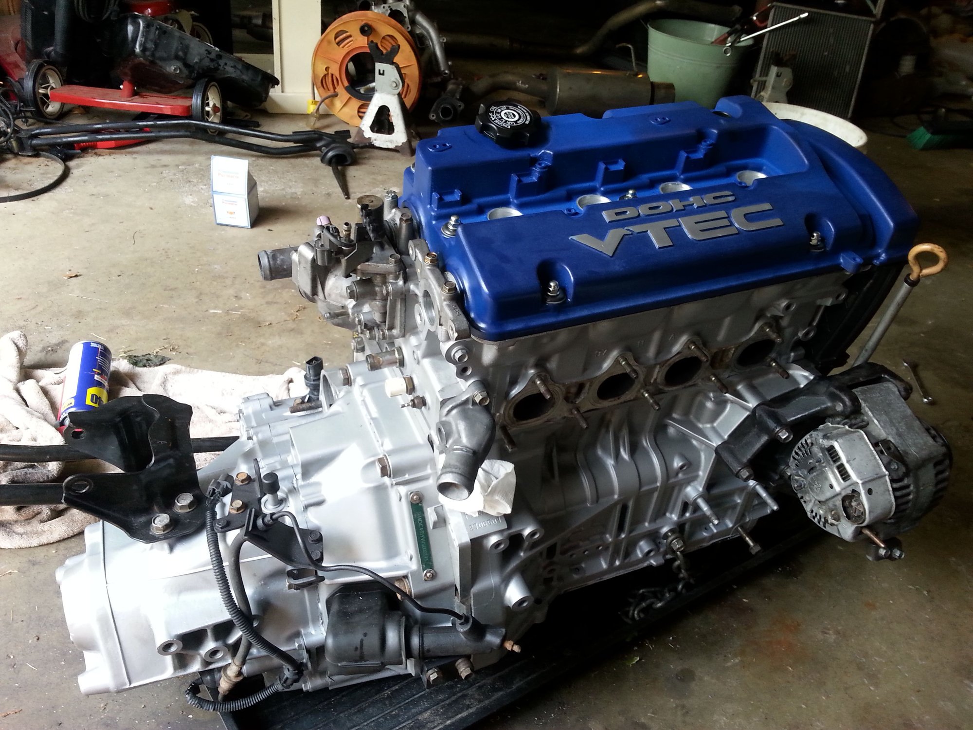

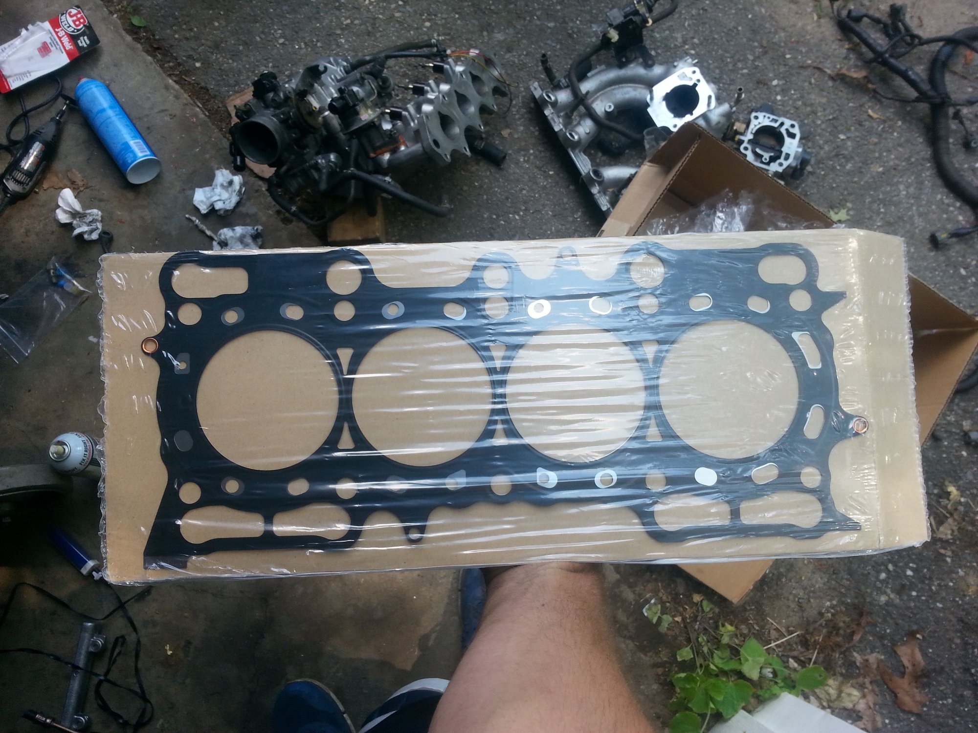

Well i got the clutch on the motor, the h2b kit on the motor, then the gsr transmission on the motor. I'm STILL waiting for the headgasket from hmotorsonline. Going on 2 weeks since i paid for it. The EG exhaust needs some welding, but most of all im dreading grinding down the F20b to make the axles fit.
At this point i guess I'll try to get the motor/transmission in the car and bolt up the head with it in the engine bay, but a lot more little things need to get done first. Updates later
Only pic from today:

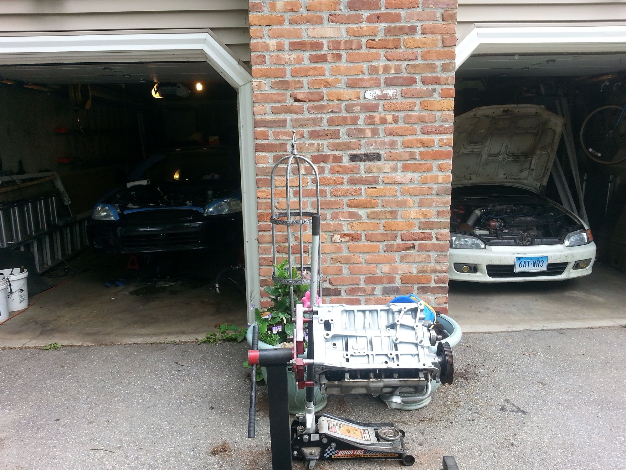

Old Jun 9, 2015 | 07:00 PM
  #41

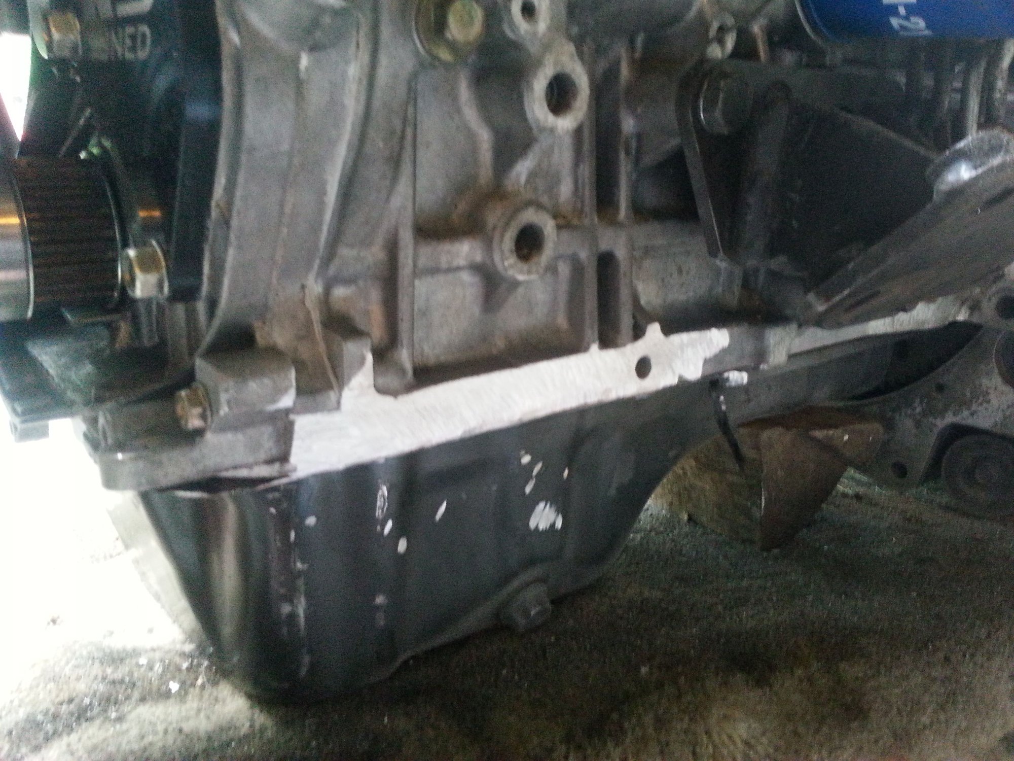

I will be doing this same swap, but into a DA chassis. Does grinding down the block there compromise the oil pan in any way? The oil pan bolts? So, if that cv joint grenades it doesn't look good for the block, but I suppose if that cv joint grenades on a regular (no hybrid) b series swap you'd be in the same boat?

ehhhh kind of. You need to grind the block, check axle fitment, grind, check, grind, check....
this way you're taking off as little as possible, but yeah it does take off some oil pan, and you need to grind a bit of metal off one or two of the bolt heads that hold the oil pan on. This being an F20b, there is no oil pan gasket, so I LOADED the oil pan with oem hondabond. I will say though that grinding this motor came out better than the first time I did an h2b on my EG hatch, and that ran for about 40k miles no problems/leaks.
And usually when the cv joint on the intermediate shaft goes, it just cracks and isn't all that violent.

I've def thought about it, but I always try to stick to oem as much as possible. One of the parts that came with the motor was a brand new oem oil pan so I grinded the block with the beat one, then used a bench grinder on the new one so it wouldn't bend away from the block. I probably should have taken pics of that whole process.

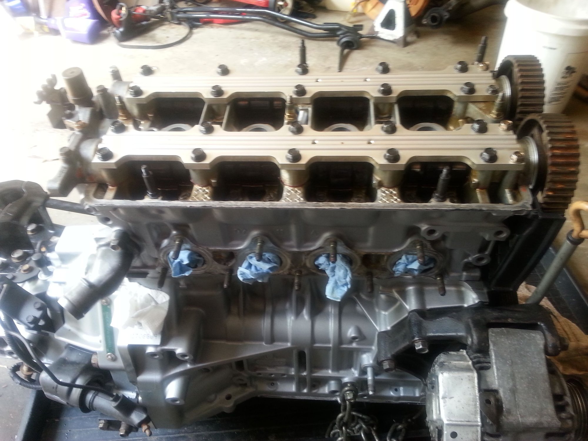

The ups guy dropped off a sheet of pure gold!

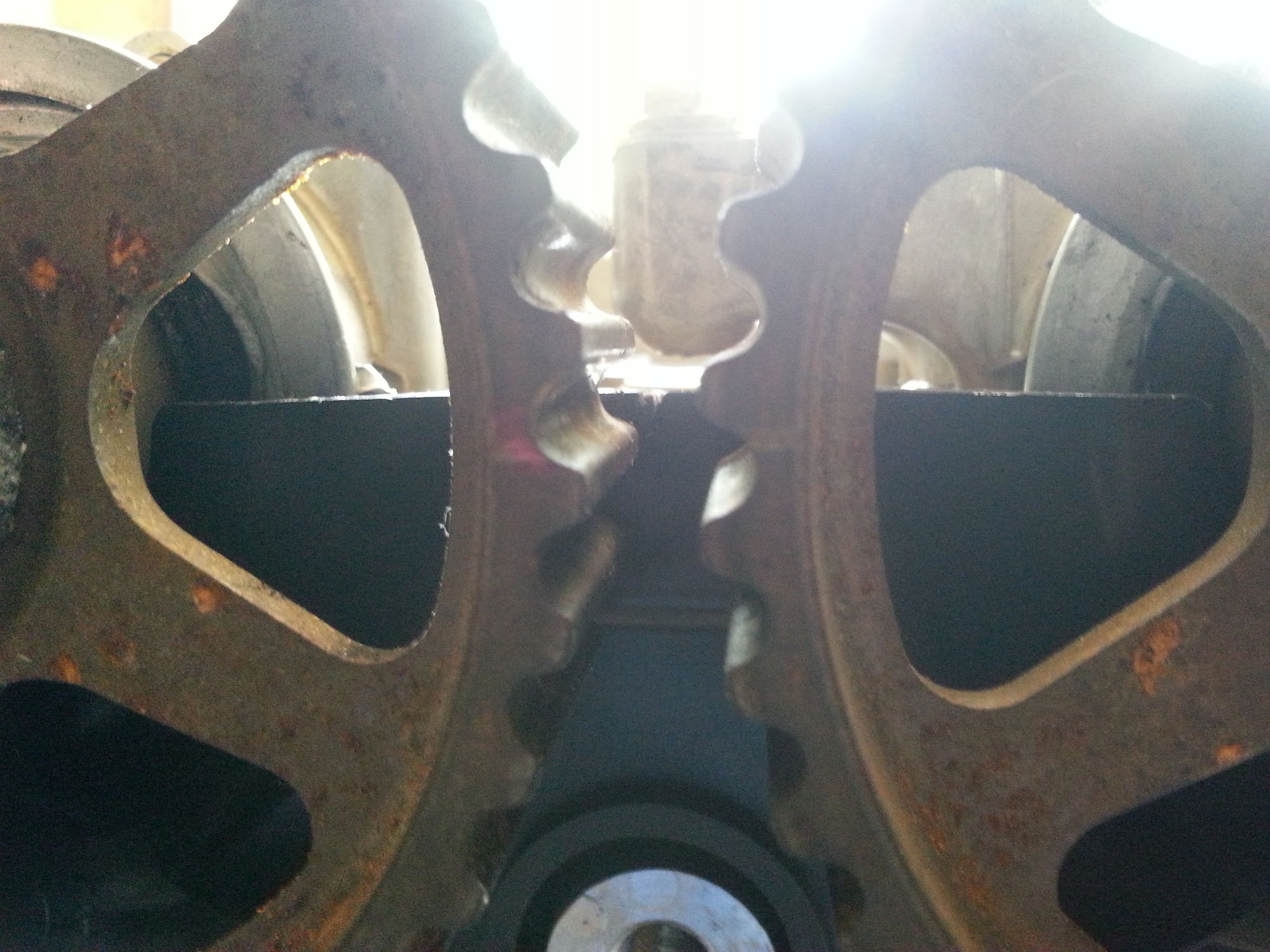

Head torqued
Top end assembly lubed and toqued at tdc
