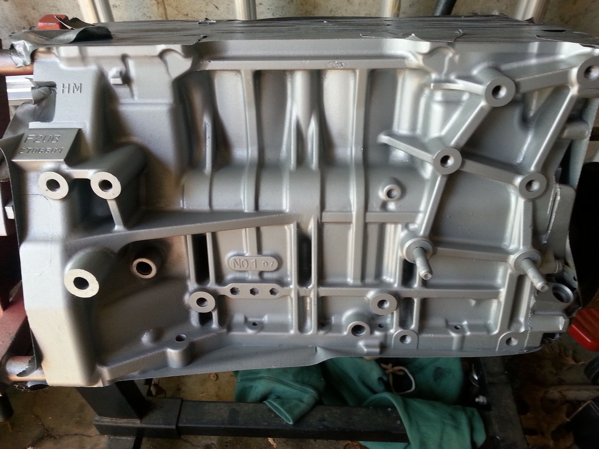

Piston clean up
F20b block clean up

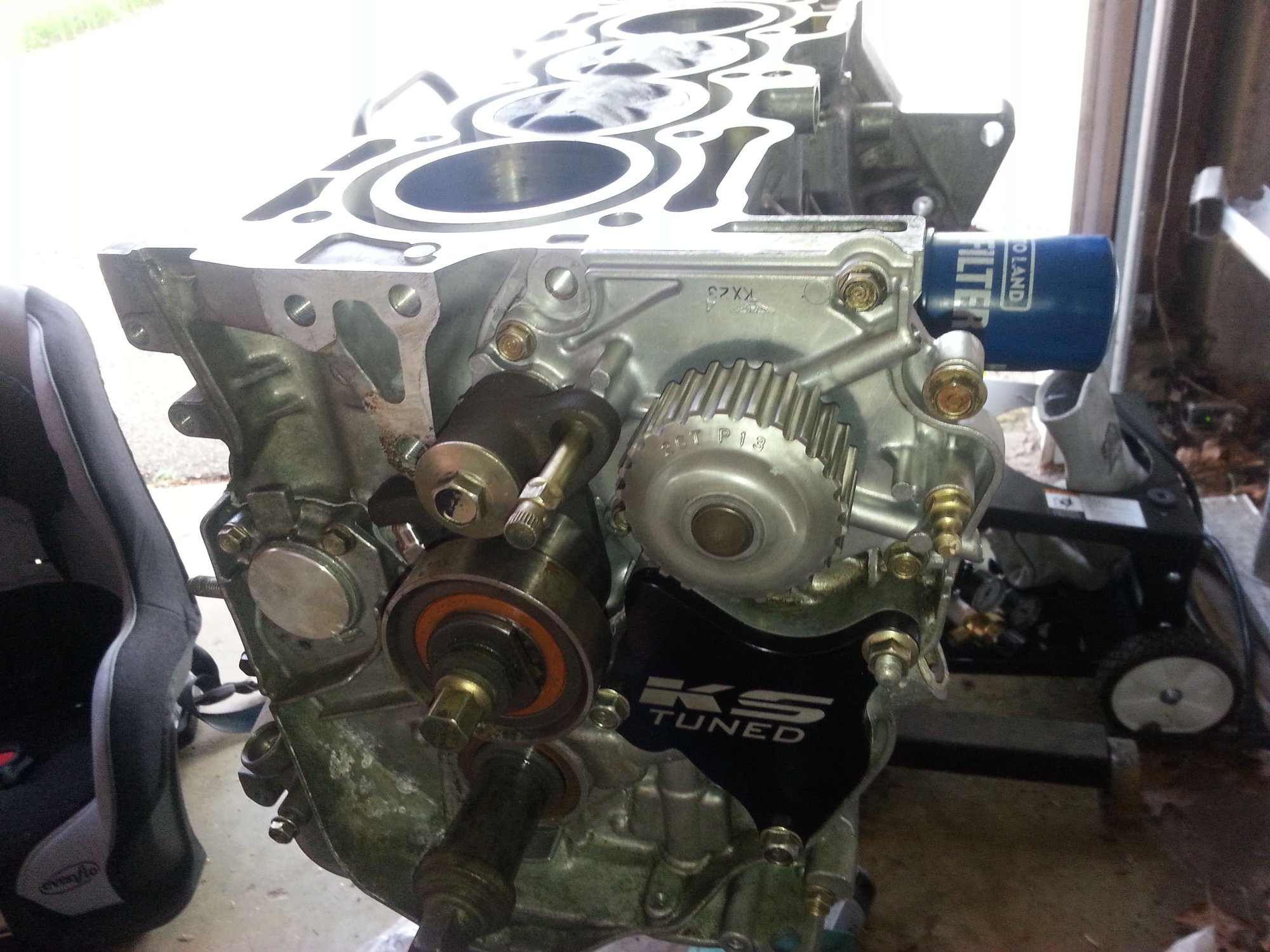

Bottom end rebuild

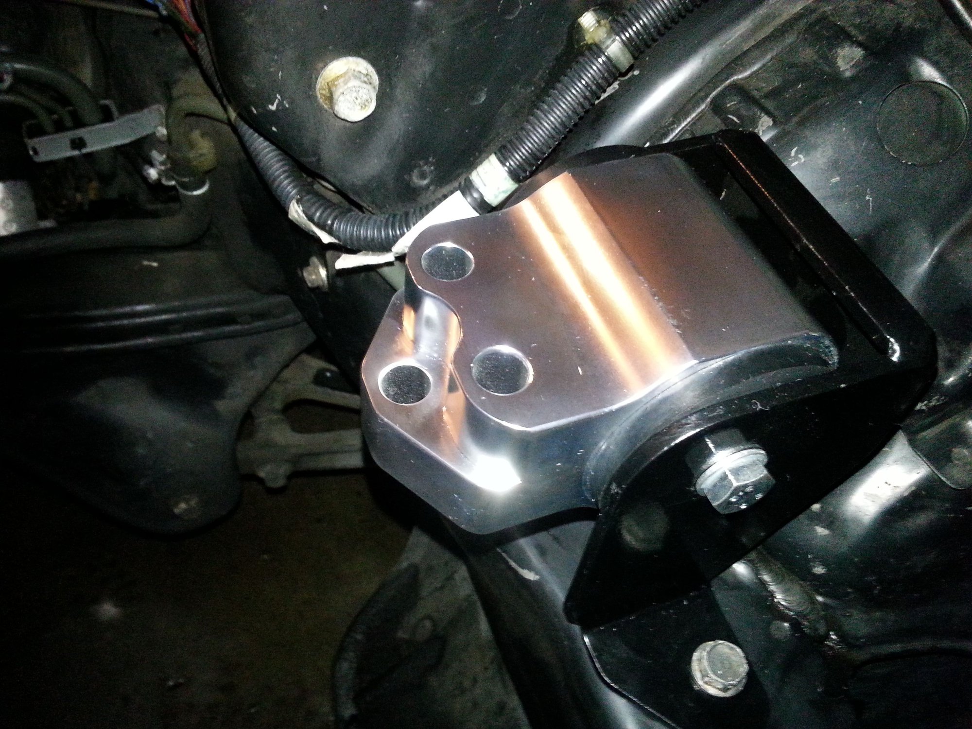

Hasport knockoff mounts are in.

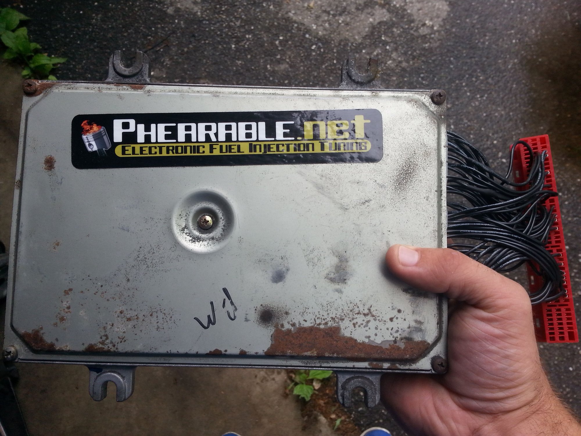

Knee is still killing me so I can't get much done. Few parts came in though
OBD2b to OBD1 conversion harness is in. That ecu is my OBD1 p72 (integra gsr) with an h22 phearble basemap. It has the oem h22a redline, 3400 rpm launch control, o2 sensor delete, speed gov delete, intake manifold butterfly valve delete, and check engine - shift light.

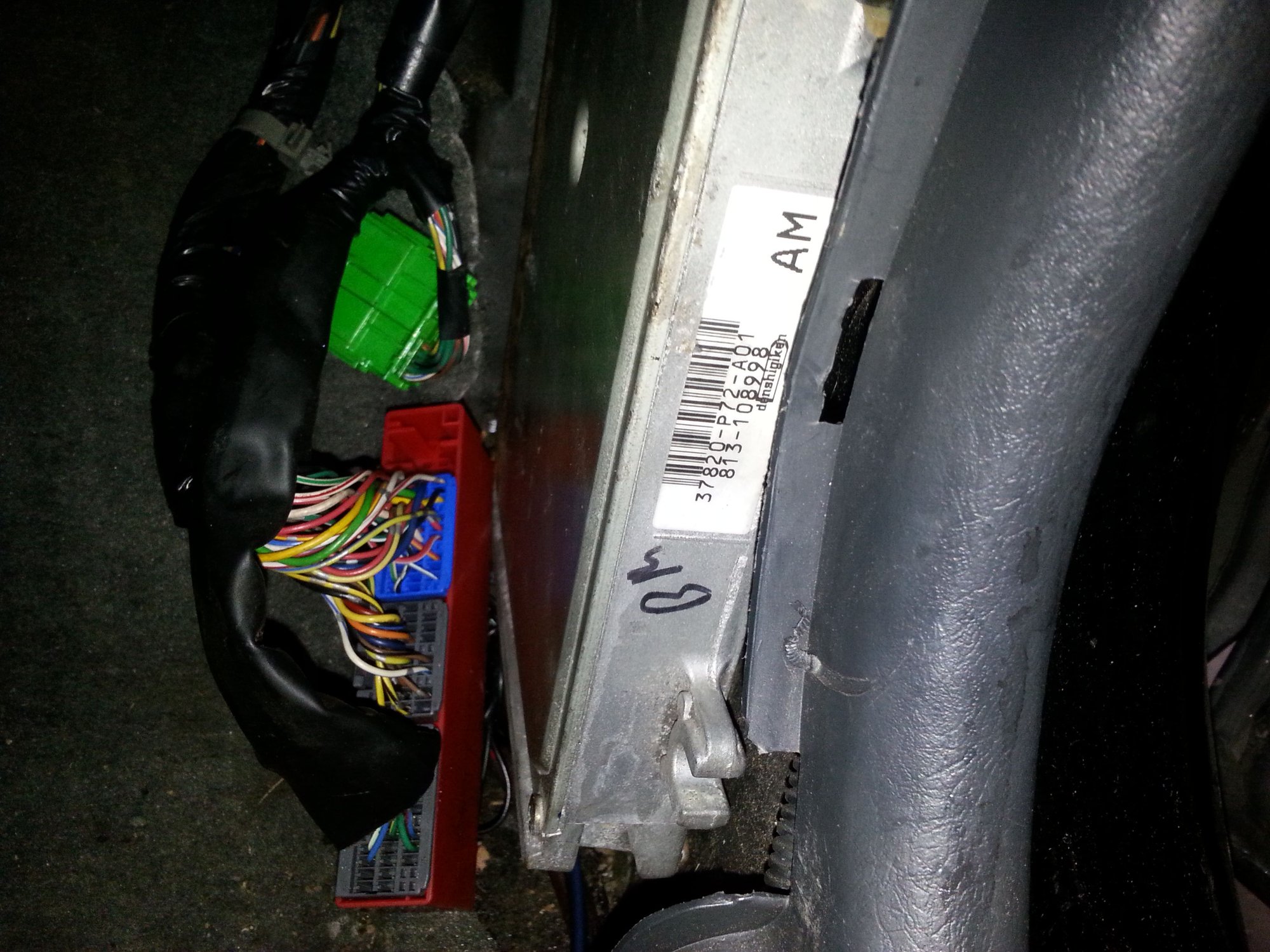

OEM USDM h22a4 OBD2a ecu is in. I'm pretty much only using this to get the car through emissions. I still need to order an OBD2b to OBD2a conversion harness for it, and I may need to bypass an immobilizer if it has one.

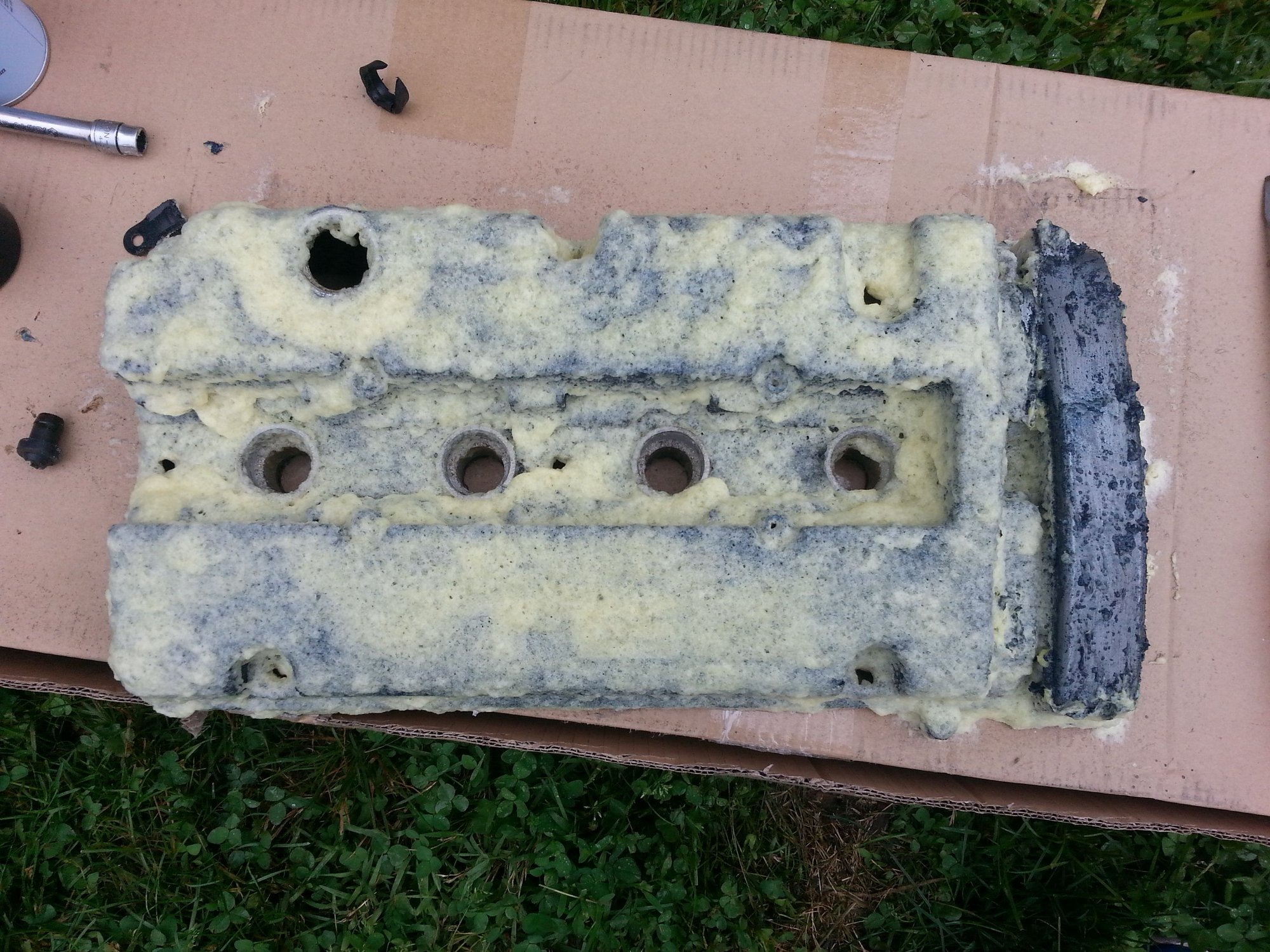

Tomorrow is the day the valve cover finally gets done up. How it looks right now...

Valve cover still needs a few coats but this is where it's at after 3 coats. Probably going to put on a layer of paint with light flake in it
