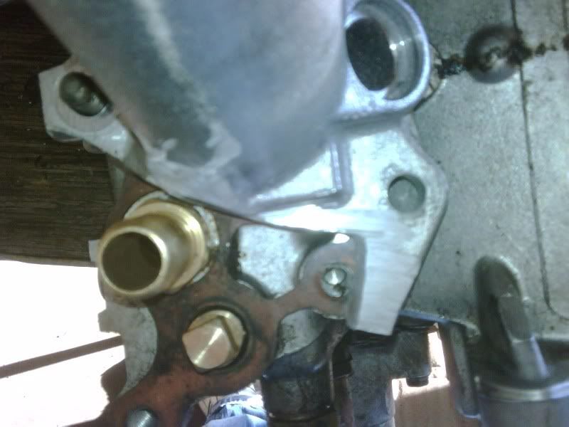

Pic's of when I made this same mod about 3-4 years ago for reference

Default Re: HOW TO: B16 intake manifold on a B20 w/ pics!!!
That's the right way to do it. I cheaped out on plugging the EGR because I didn't want to buy two different taps. 1/2in pipe thread for the water port. I'm doing the water port mod on every intake from now on.
Looks good! And yeah I agree with you the water port mod makes taking the manifold off 100x easier

That coolant port is NOT for the heater alone. The BYPASS tube is to allow your cooling system to function properly and allow additional cooling to the head. That is not an inexpensive way to do it, it is a lazy method.
Old Mar 24, 2012 | 06:40 AM
  #64
nealnanoHX's Avatar
Joined: Feb 2009
Posts: 1,912
After looking, you are correct. That coolant line is a bypass for the head and blocking it can cause the head to not cool properly.
