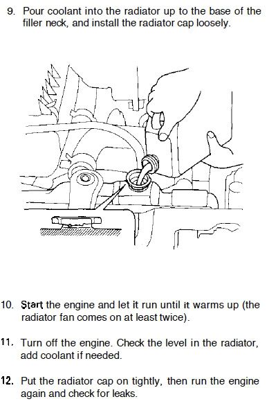

I been searching a lot and 'till now I found out;
-bleeding of the cooling system was not good
-ECT-sensor ****ed
-ECT- gauge sending unit ****ed
-coolant temperature sending unit (?) ****ed
-wires of one of the above ****ed
-gauge ****ed (but don't think so)
that limits the possibilities
