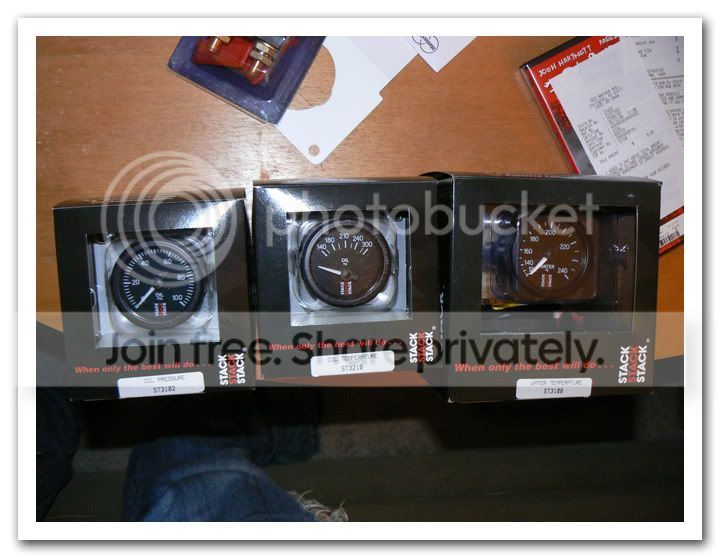

Racerpartswholesale.com gets two thumbs up from me!
Ok i have searched around and found install threads but need functioning pics on how to properly install all three of these. WATER / OIL TEMP, PREASSURE
any help would be appreciated!
