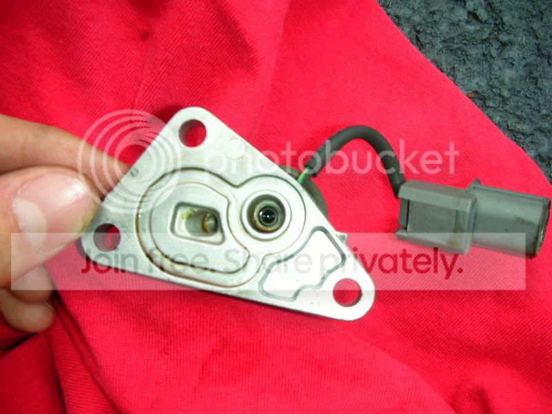

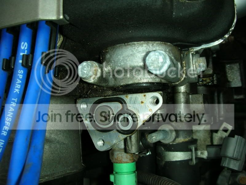

I took off the vtec solenoid to check it out and possibly clean the screen. However, I can't find a screen. I figured it would be small, but I don't see one. I may have found my problem.
After taking off the solenoid I found the gasket that everyone mentioned, but no screen?
Here's the solenoid, no screen here either.
I was careful and slow when taking this off, I don't think anything fell out as I was lifting it off.

You need to remove the whole thing (part 12 is the gasket with the screen):
