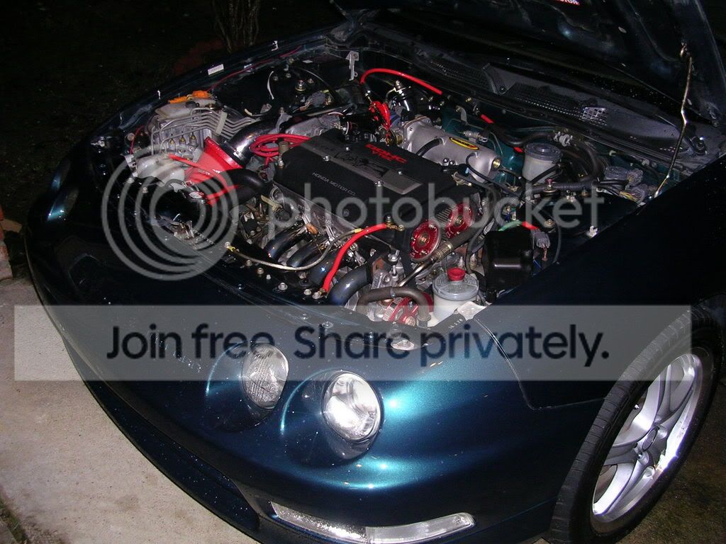

what they said, let me be the first to say this, very nice engine bay
