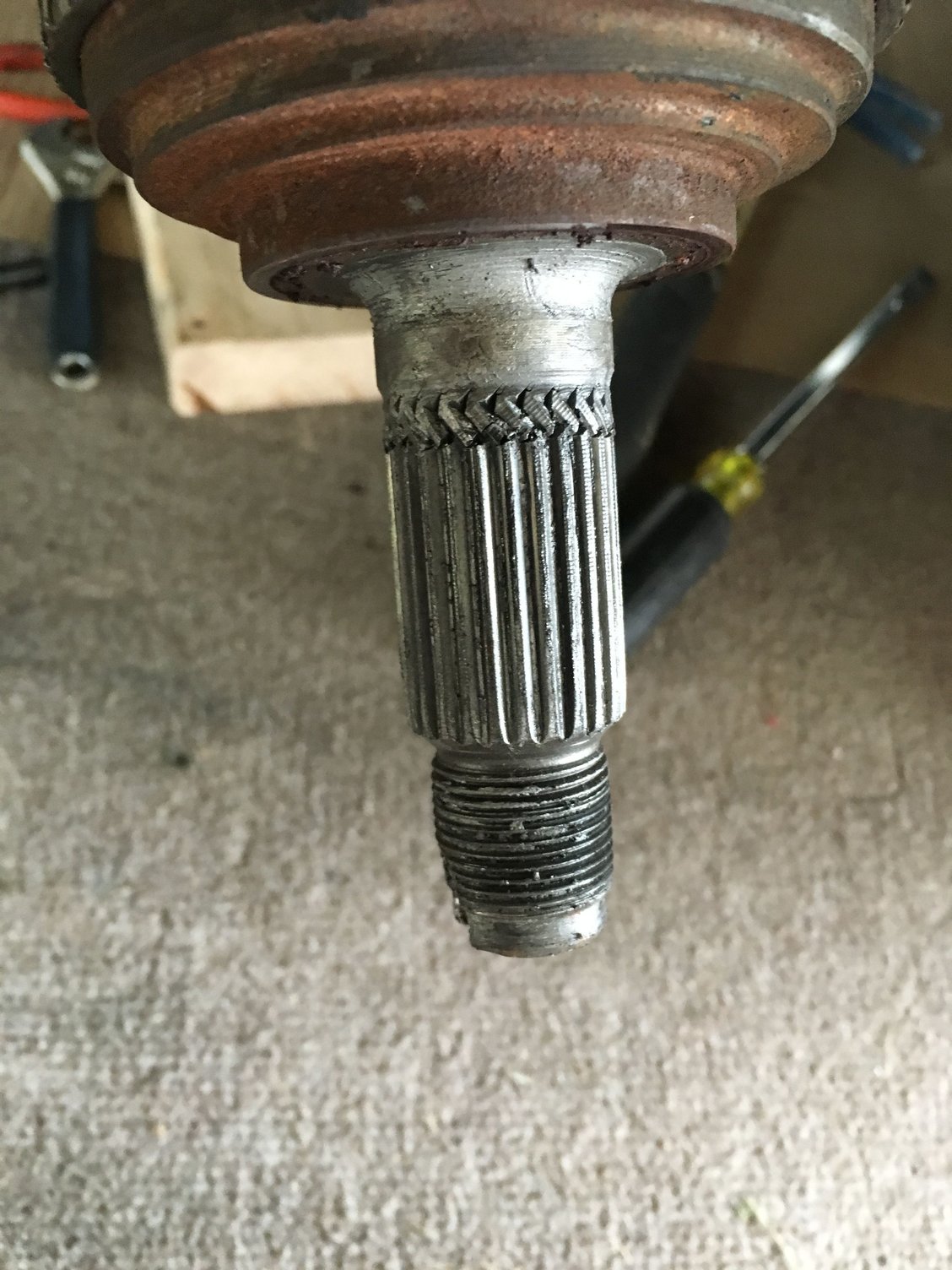

Tranny has enough fluid. I just drained it to remove it. In the process of removing my tranny I found the driver side axle spline to be twisted. I'm guessing that's what the vibration could be on hard acceleration. I'm not sure that would cause the chatter/rumble strip noise when I downshift though. Here is the spline.
Next is getting the tranny off to investigate more :/

UPDATE: I removed the tranny and found that the pilot bearing was not smooth to spin. I replaced that and had the differential bearings and input shaft bearing replaced while it was out. With all that and a new axle installed, all the noises are gone and no vibration on acceleration anymore. Not sure why the clutch pedal engages pretty far out of the end of stroke, newish comp stage 5 sprung hub. And now the leaky turbo is being sent back to precision so once again the poor teggy is down for the count.
