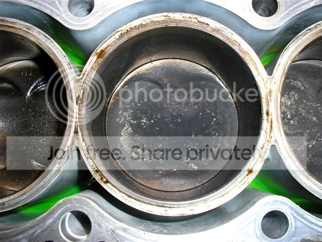

I've always said to others seafoam doesn't do **** and now I have proof. I've always wondered, where is all this carbon coming from that seafoam is suppose to clean up? And how is it possible that seafoam is strong enough to clean carbon, but gentle enough to not damage the gasket's on a motor, like the oil pan gasket and valve seals.
So I went out and bought a can of this lovely stuff which came to $12.00 after tax. I just picked up a winter beater with 402,000 kms and it needed to have it's headgasket replaced since it was eating coolant and smoking really bad. No other better time to prove the only thing seafoam cleans is the inside of your intake manifold and pcv valve/hoses.
So me Flexin5, Engsr & B18C5er started up the beater and proceeded to unhooked the brake booster line. Next we used about 3/4 of the bottle in through the booster and poured the first into the crankcase through the oil fill cap.
Then Flexin5 and Engsr ripped the **** out of the civic, smoking up the entire shop and street. The car was redlined and they came back a little later. Immediatly after the engine cooled down, we started the process of taking the head off.
Seafoam is crap and here's the pictures.
These pics were taken after the little pool of coolant was cleaned off the top of cylinder one.
Cylinder 1
Cylinder 2
Cylinder 3
Cylinder 4
Cylinder 4, 3 ,2 all still have this magical carbon stuff on it, while cylinder 1 where all the coolant was leaking into is clean.
Same goes for the head, you can even see the fouled spark plug in cylinder one from all the coolant that was drained into it because of the leaking headgasket.
Just as expected from a motor that has had a blown headgasket. The carbon that's on the piston tops now is actually normal and isn't harmful in anyway to the motor.

Use your head, the proof was posted and if you've read anything about seafoam in the last while, you'll know it does ****.
My B18C1 piston's after 200,000 kms and no seafoam treatment.
Carbon inside a internal combustion engine is normal, cleaning carbon doesn't help do anything unless you have excessive carbon deposit's which mean's there's something else wrong with your motor, like it's burns oil.

I suppose that depends on what you were expecting it to do. My engine had carbon buildup on the head/pistons/exhaust ports after 500 miles. Big deal. Seafoam also got rid of my CEL for EGR (on the lexus), so I guess it depends on what you think its going to do and whether you think "carbon buildup" is normal.
<TABLE WIDTH="90%" CELLSPACING=0 CELLPADDING=0 ALIGN=CENTER><TR><TD>Quote, originally posted by 92DAIntegraXSI »</TD></TR><TR><TD CLASS="quote">Basicly he is right u can not expect it to clean the engine like it is brand new again. especialy with that kind of milege on it. One attempt will not always do it either. at my job i ran 2 cans of honda top engine clean and used it threw more that just one side of the manifold this way it will find its way into each cyclinder . should of seen the black crap that was left on the curb after the smoke cleared.</TD></TR></TABLE>
I never wanted or stated I wanted to clean the engine back to new. It's a fact of life that carbon will build-up fine on perfectly running motors with nothing wrong with them.
I'm tired of people saying "oh my car smoked like crazy, it must be cleaning out the engine really well."
Almost all the black stuff that will come out of the exhaust, is the oily residue that left unattended in the intake manifold and pcv system that the owner has never figured to clean out.
People wonder why they have idle problems and how seafoam fixes it. It's simple, the thottle body has holes both for map sensor/fitv(if u have one) and the intake manifold for the iacv sensor, if those holes are clogged or restricted by anything of course your cars gonna idle like crap. Same goes for when you pcv system isn't working.

well i wouldnt expect seafoam to remove everything, but i guess it depends what you want it to do.
I know for a fact that it definitely reduces emissions. My friend bought a 87 prelude with over 200,000 miles. He took the test and failed horribly. I then ran a can of seafoam through the brake booster and some in the gas tank. He drove around for an hour that night, and went and took the emissions' test that day and came back and said he passed.. I compared both slips and the results on the pass was amazing.. his readings were 80 times better..
I just used it on my 92 integra gsr today, and the same results (i've used it before and knew the results on my car) but my readings were as follows:
HC 39 - (Limit 220)
CO 0.00% - (Limit 1.20%)
CO2 7.96%
And the engine runs a little smoother..
But I dont expect it to work miracles, but it does help to pass emissions. And I've never put it in my oil.. Just doesnt seem right.

I am sure it did some thing, what did it look like before you did it chief? You would have to hand clean the parts to get them spotless.
i have to agree, seeing it with my own eyes. i'm sure it'll help cleaning out the PCV system, however the missconception that people have that it'll make your motor look brand spankin new and get rid of all the carbon and give you 10hp is ridiculous. that SOHC had just about the same amount of carbon as my LS motor with 200,000km on it when i took it apart to re-build.

You pictures/post are worthless. Since when do any scientists perform experiments without establishing a control? If all you analyzed were the post-seafoam pictures, you have nothing to argue.
How do you know there weren't more carbon deposits? How do you know all the valves/pistons didn't look worse before you started. You don't.
Now, if you took pictures before you Seafoamed it, and the innards looked exactly the same, then this post might be worth considering.
